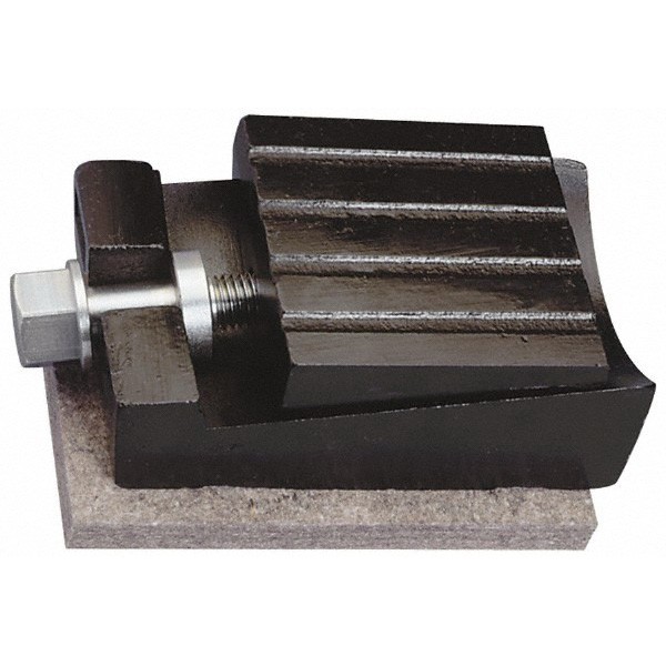

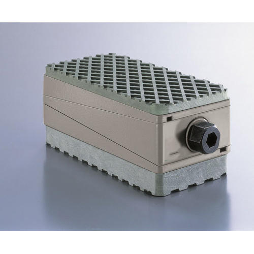

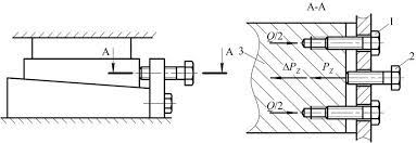

Hi there, hoping someone can help. I’m looking for something that I think should exist for general DIY, but having trouble finding something to actually buy.
I’m after what I think should be called a wedge jack / screw jack / levelling wedge etc. A jack type tool that can be used in a small space (<50mm) to lift something up using a screwdriver or allen key (something that easily tightened in a small space) to a required level and leave in place.
I’ve found a few drawings and which I think are concept or ideas for 3D printing which look like they might work. The photos are for very expensive precision jacks. If anyone know anything existing and readily available (and not too pricey!) that’s like this or that would do the same job I’d be really gratefully for some help.
Cheers
Dan

Thanks for the replys! It needs to be able to get in a gap and force two bits of woods apart a bit so need something a bit more solid.
Thanks for the reply! It needs to be able to get in a gap and force two bits of woods apart a bit so need something a bit more solid.
They are surprisingly robust, the ones listed above can lift (spread) up to 100kg.
Winbags are stronger than you might think. One will lift 100Kg. They fit in a gap only a few mm wide. You can use more than one at a time. They will move doors, windows, kitchen units etc.
