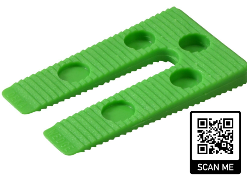

Further to wot I woz saying earlier, these are the sort of packers I was thinking about:

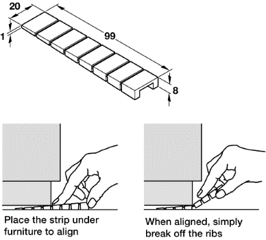

but the more common furniture wedge packer (used singly) is this type (from Hafele?):
Both are easier to use than sawn tapers and more durable than very small wooden tapers
