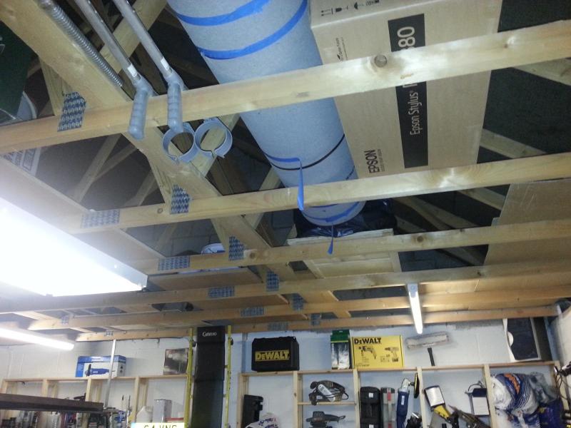

I have a pitched roof double garage with roof truss timber size of 70 x 35mm only. They span 5.4m across the ceiling using metal connector plates for joins.
I would like to plasterboard the ceiling, insulate with Kingspan or similar in the 70mm gap and board the top for storage.
I won't be storing anything particularly heavy (at the moment just empty boxes, old paint tins, some timber, chairs etc.) but want to be able to walk around it safely.
Does it look safe, or would new ceiling joists be required?

Trusses unless designed otherwise are made for plasterboard only not for boarding out and storage.
Ceiling ties for standard Fink trusses such as yours are designed as follows.
Long term load.
Plasterboard and skim 175N/m2
Light imposed storage load 250N/m2
Short term man load.
At a point to produce the highest stress 675N/m2
Note these are metre square loads

Thanks, that's very useful.
Is the Light imposed storage load in addition to the plasterboard and skim load?
I will be plaster-boarding the ceiling and laying fibreglass type insulation, and your figures read to me like I will be ok storing some general junk up there too, max 25Kg per m2 if I've read that right (?).

I'm thinking about doubling up the joists for piece of mind before the ceiling goes up. However I don't think it will be easy to remove and replace the joist hangers easily.
Any ideas?
Or to rephrase: I am thinking it would be wiser to put additional larger joists in between the existing roof trusses (currently 600mm centres) to hold the new ceiling.
The span is 5.4 meters with single skin brickwork after that. So about 5.7m timber span required. One of the supporting walls is the garage door side (2 lintels supporting the weight.)
Assuming 12.5mm plasterboard, 18mm chipboard flooring and 100kg per m2 load bearing requirement, what size and grade timber joists would be required?
At a 5.7m span you will struggle to get anything sensible to work.
You will be looking at 47x245mm C16, or 47x220mm C24 timbers at 300mm centres (so two between each truss).
Are you planning to install them below the ceiling tie brace that can be seen in the picture? You will lose quite a bit of headroom if so, especially once the plasterboard goes on.
It's the right decision though to ignore the capacity of the existing trusses. They're unlikely they have anywhere near enough spare capacity for what you want, and you can't really just beef up the ceiling tie as you will also put considerably more stress onto the web braces, top chords, and connections too.

That's a bit of an arbitrary figure. I just quadrupled what I thought was a realistic max load for plenty of headroom.
If there are too many obstacles and/or costs to increase the load bearing to 3-4 times then I will just board up as is and limit the paint pots.
