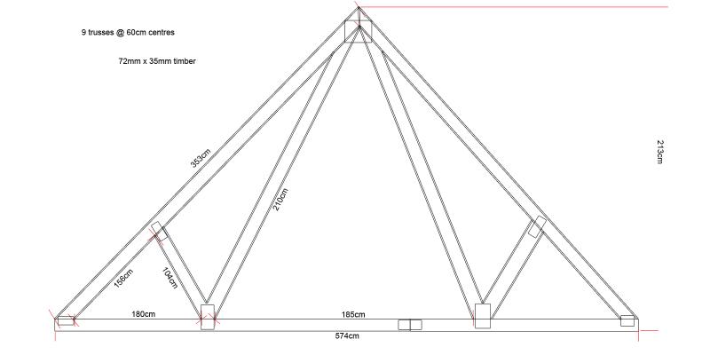

I'm in the midst of having my home loft conversion designed and the truss manufacturer I'm dealing with kindly knocked up a design of the existing garage roof for me. Must be the Christmas spirit or something...
According to him with the truss fully loaded with tiles to the rafters, plasterboard to the ceiling and all wind, snow loads I'm looking at 85kg/m2 maximum load to the bottom member in the space between the diagonal webs.
