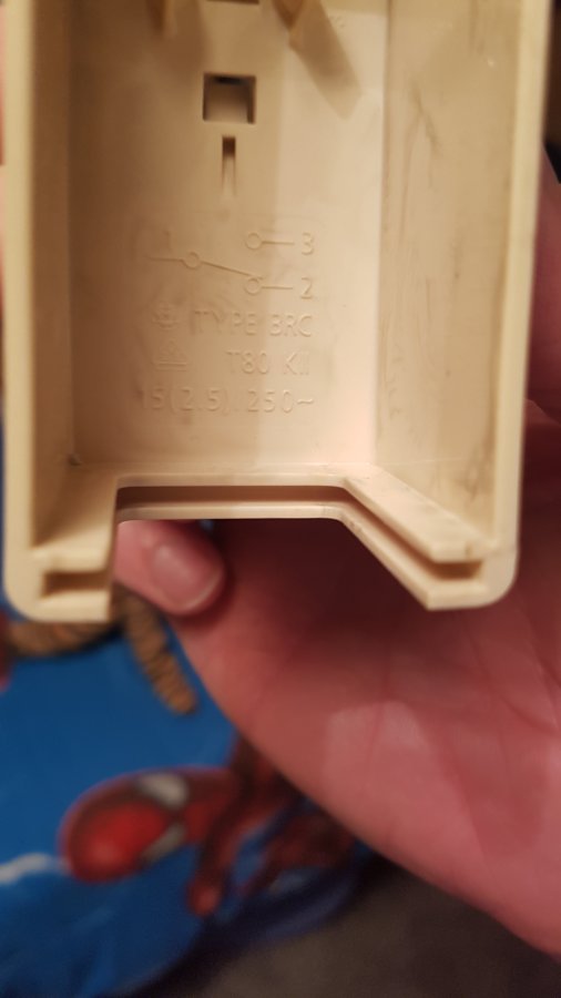

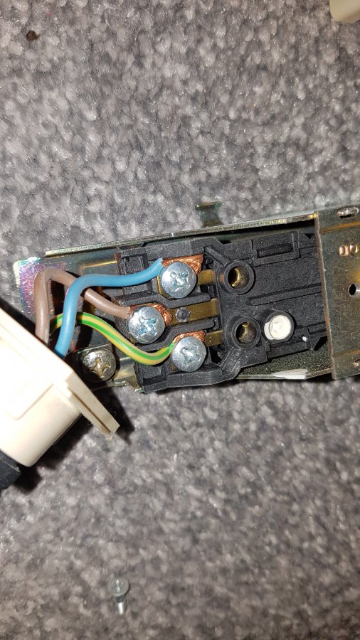

Post a picture of the connections in your cylinder stat. My money is on the brown and blue wires being the wrong way round. Depending on what make it is blue should be to C and brown to 1.
I can't get the thing open.. no screws on it.
1 is brown
I'm not familiar with that thermostat. What make is it? Is there a label inside the cover showing the connections? What are the 3 terminals marked as?
As I suspected the brown and blue are the wrong way around. You can either swap them at the cylinder stat or in your joint box.
Obviously turn the power off first!
The blue wire and the earth wire should both be identified as being live wires by using brown sleeving or brown tape.
