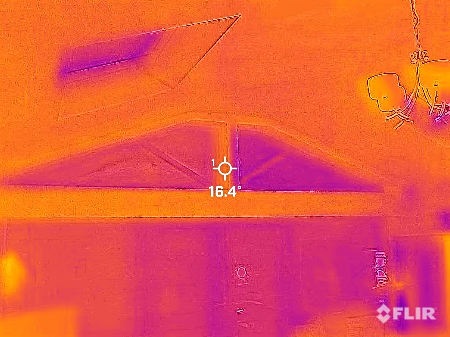

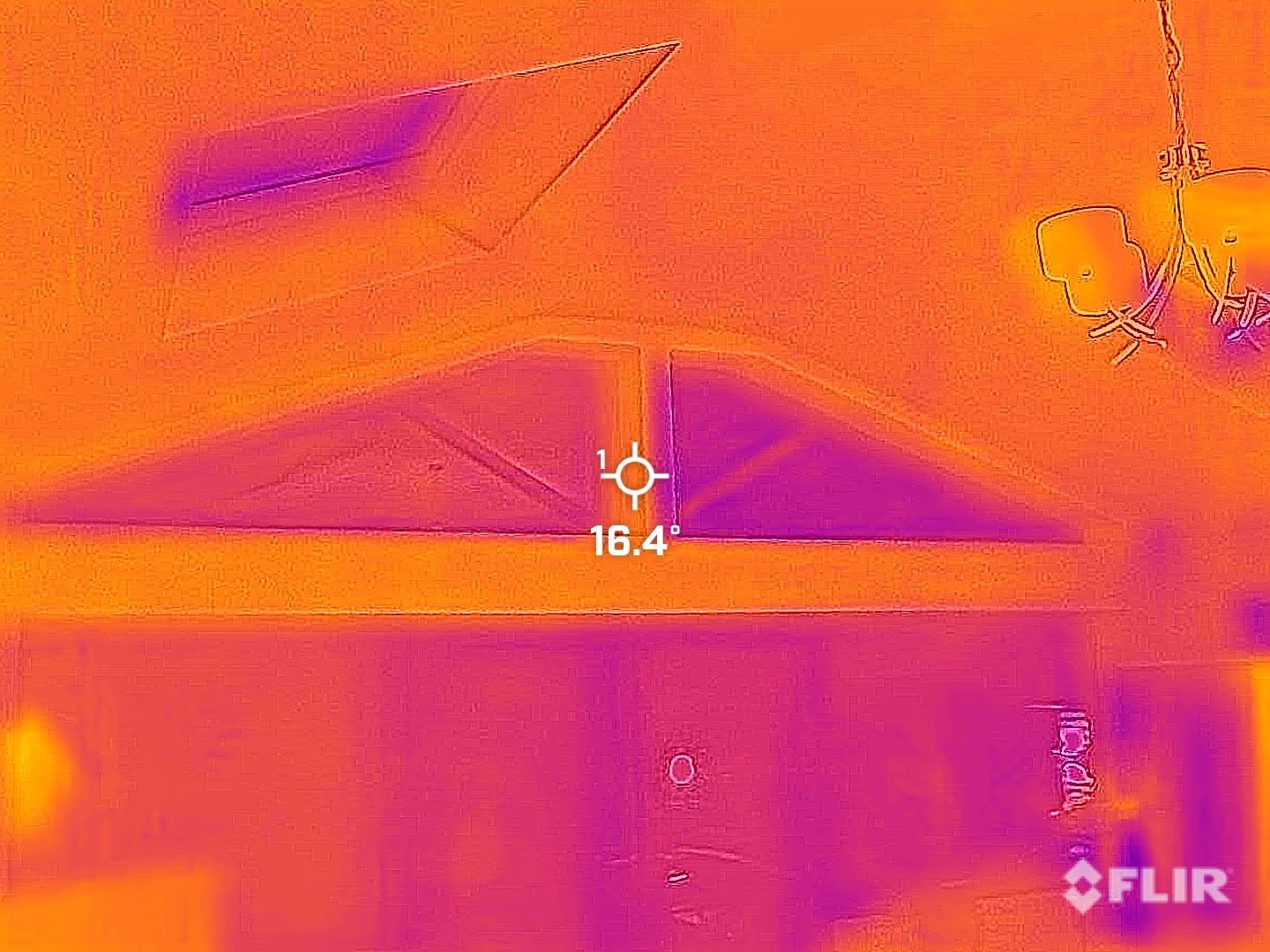

Weird artefacts in two of my Windows, what is it?

You may be right. Just tried a thermal camera on them off the back of your hunch. The one with the artifacts is a full degree c cooler. (Darker = colder on this camera)
It will be cooler as the planitherm surface is damaged/degraded due to it being on the outside. I will be very very surprised if that is residue from a ' film '.
A very nice idea, to use the IR camera :)
Although take care of how you interpret the results. As glass is reflective to IR, you're not really seeing the right window as 1 degree cooler.
You are seeing that the right window has higher emissivity than than the left one - i.e. it is less reflective to IR.
Which, given that the whole point of the Planitherm coating is to reduce emissivity, is another fairly good pointer to a failed coating!
