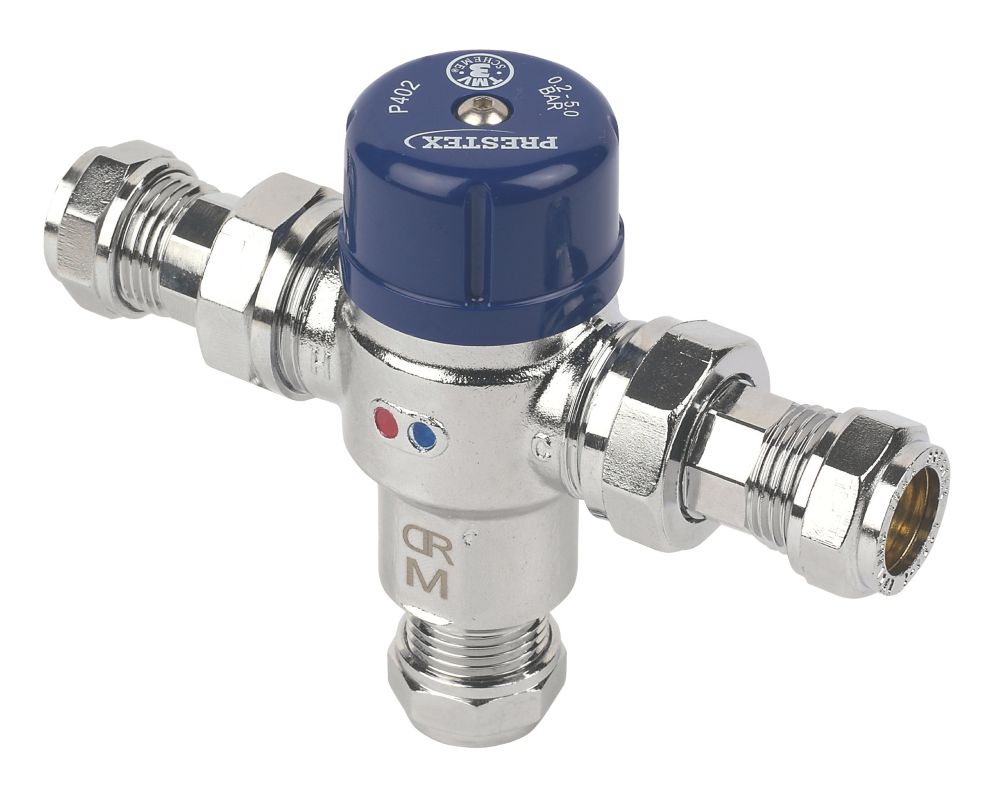

It's possible/likely that you have a thermostatic mixing valves on both the bath mixer and the shower, the supply to both the kitchen & basin taps will be direct from the boiler.
Might be worth measuring the temperature at bath and shower to check if the TMVs are set to the 'correct' temperature.
The bath isn't a mixer, just two bog standard taps.
OK but still possible that there is a thermostatic mixing valve on the hot bath tap.
How old is the property?
Bath taps the same age as the basin taps and shower valve - 9-10 years? Kitchen is 2years.
I don't understand why the basin and bath are different because they're the same tap. And we're cheap at the time which makes me presume they wouldn't have had tmv?
The TMV is a separate unit (not part of the tap)
Have look under the bath for any fitting on the bath hot supply pipework
96288_P
Ah right, 100% not then! Definitely no tmv there, or anywhere (apart from in the shower mixer)
