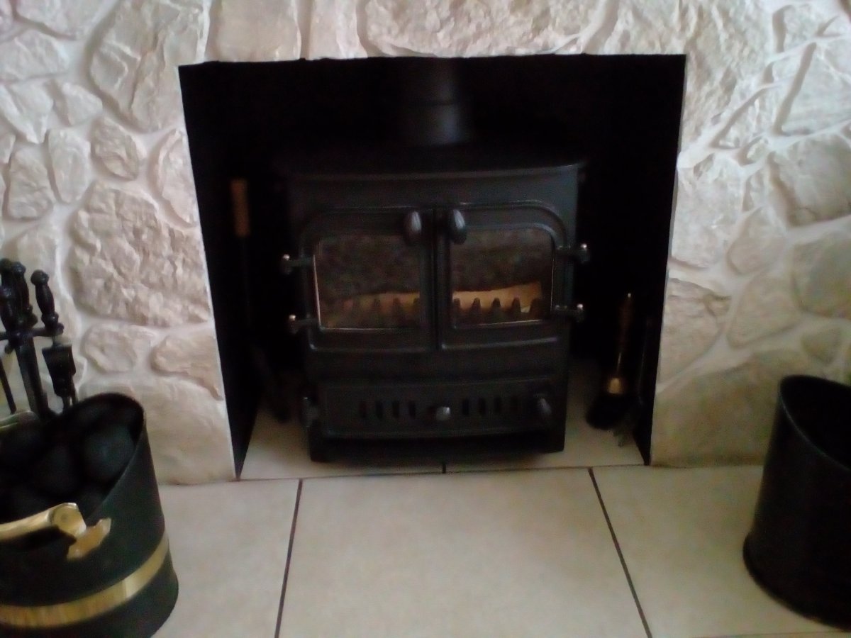

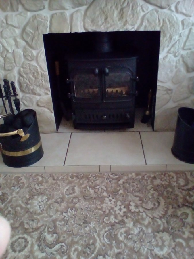

Are you referring to the distance from the outside of the stove to the surrounding brickwork; because this could be causing the stove to overheat, and that'll stress the cast iron frame.
Can you post a picture

Hi Doggit, sorry for the delay in replying laptop went wrong. The room around the outside of the stove is not a lot. I will try to send a photo when the doors are back in place.

Hi All, sorry for the delay in replying to you all, more computer problems. I have taken 2 photos of the stove and surround and replaced the glass with a better quality glass from Germany. Hope I have managed to attach the photos.
