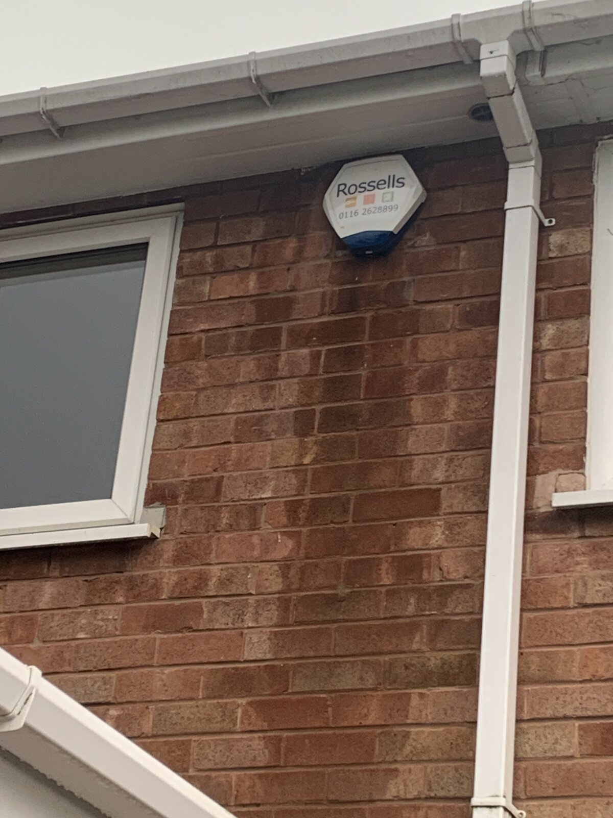

Wet brickwork under fascia
7 Jun 2009
37
Leicestershire

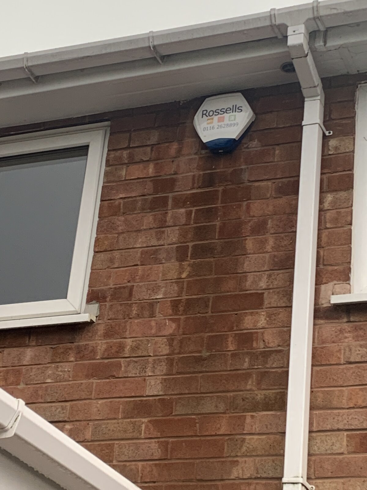

I noticed a wet patch on the brickwork after a heavy downpour. Its adjacent to the down pipe. See photo.
I havnt been able to get up the ladder to take a look due to the weather. I assume it could be a blocked or partially blocked downpipe?
Any ideas?

OP,
You will need to go up a ladder, and take some pics to post on here - show inside the gutter outlet, and if the felt is coming down over the gutter?
A hose pipe can be used to water test with a light spray.
However, unless the lower roof is a flat roof it might be difficult raising a ladder without a wide "Standoff"?

The leak is presenting at the eaves.
Here's a heads-up:
No matter if the laths are rotten or there's tile slippage or a hole in a tile (whatever that means) - any penetrating rainwater will hit the felt and run down the felt to the discharge point at the eaves.
Did your "local roofer" go up a ladder to view from the roof eaves? Did this local roofer go into your loft?
Do you have pics of these defects you mention?

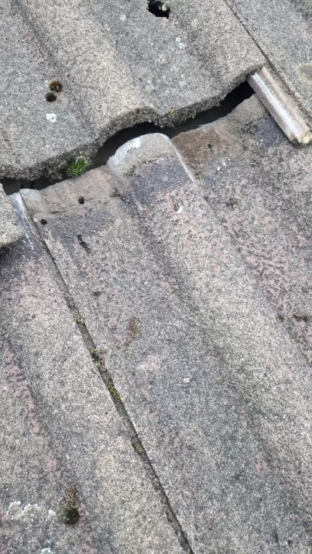

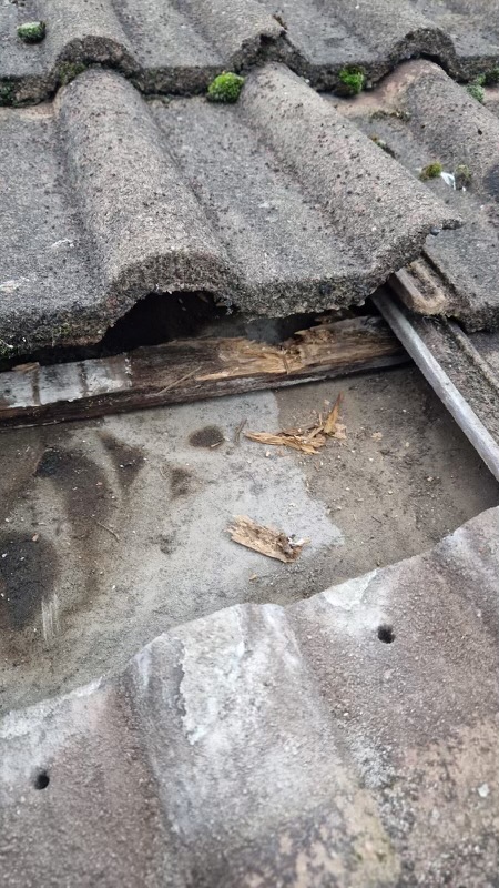

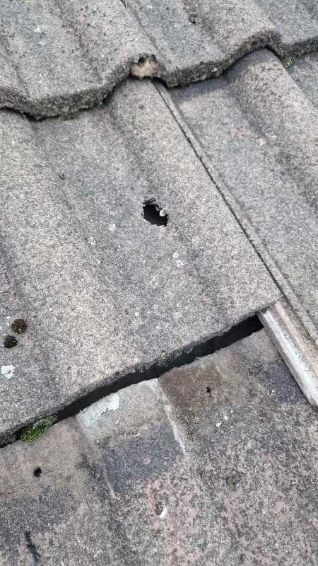

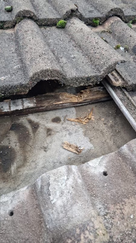

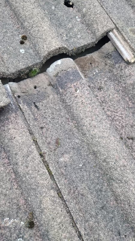

So i’ve had a local company pop round to take a look at the roof.

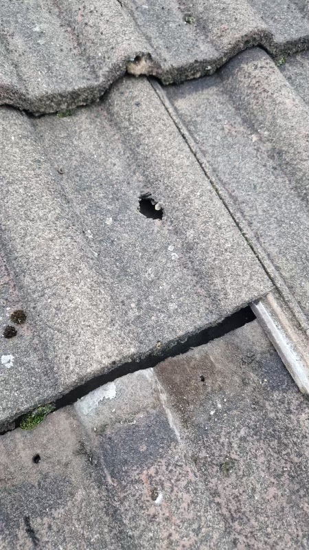

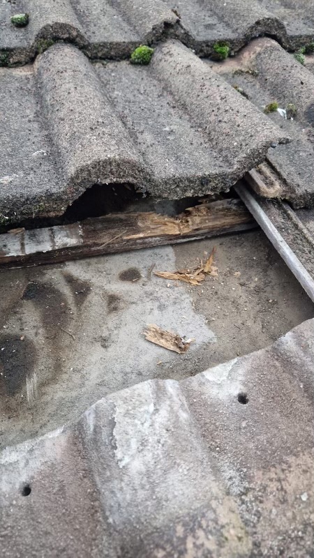

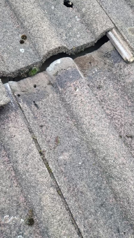

Transpires none of the tiles are nailed to the laths (i thought they were placed over the laths not nailed). Lath in the photo showing sign of rot and theres little over hang with the tiles. Been told i need a new roof. This is the second roofer thats said this.
I’m no expert but cant the roof be fixed without a complete reroof. All under felt us fine. Been given a quote and i’m not sure how much i should be paying for a 3 bed semi detached gable roof. Nothing special about a standard
gable roof

Since the roof is 60 years old, a new roof would be more thermally efficient, and we plan to stay for another 30 years or until we die, I'm gathering quotations for a new roof because it appears that the rot has spread to various areas. Since two roofers have already stated that a new roof is required, I'm now considering replacing the entire thing. Would a quote of £11000 inc vat for a three-bedroom semi-standard gable be about right if you included scaffolding, old tile removal, skip, and the rest? Sounds pricey but still early days as i’m still gathering quotes.
About half that for a simple strip and re-tile, on an uncomplicated roof.
I’m no expert but cant the roof be fixed without a complete reroof. All under felt us fine. Been given a quote and i’m not sure how much i should be paying for a 3 bed semi detached gable roof. Nothing special about a standardView attachment 361657 gable roof
I am no roofer but I would say the roof or at least that row do not have enough overlap to prevent rain being blown under. its been badly set out possibly from the start of the lath run.
Not sure how that hole could of happed - must of been like that from when it was built and its that which has let in water and rotten that section of lath. Perhaps all other areas are ok
