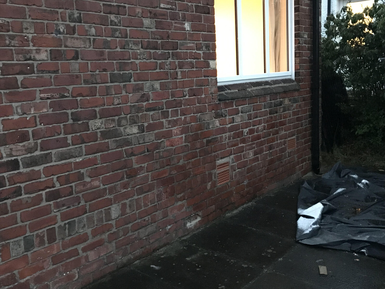

Here are some additional pics that show how far above the clay are the airbricks. We have checked for leaks from the drains and pipes already. Engineers said there was no leak related problems.
We checked with the neighbours also. None of them seem to be facing issues as severe as ours.
In the pics, there might be a trail of efflorescence on the brickwork running down from the airbrick. Please show us the outside, showing height relevant to ground and any downpipes, gullies, etc

Please photograph the airbricks round the house, showing how far above ground level they are, and the drains, gullies and manholes.

Apologies on late reply. I had drain person who came today and checked the drains. There were some small roots which he mentioned he will clear them off. But there was no leakage from the drain. He put dye in the water in the morning. No dye has been observed in the standing water below the house. This makes me believe that it may be the ground water.
The clay is wet all around the house. I asked neighbour - they said they did not had this issue as there is potentially concreted.
Yes i have water meter - I switched off all the tap to see if there was any water leak and I could see water meter was not giving any reading that assured that there is no pipe leaking.
THis is mainly surface water - not sure where it is coming form

Does the roof gutter in that picture have a drain, or is it draining onto the pathway ?

There seems to be a wet patch under the window. Is there a sink inside? A dripping gutter above? Or is the nearby downpipe a source?
