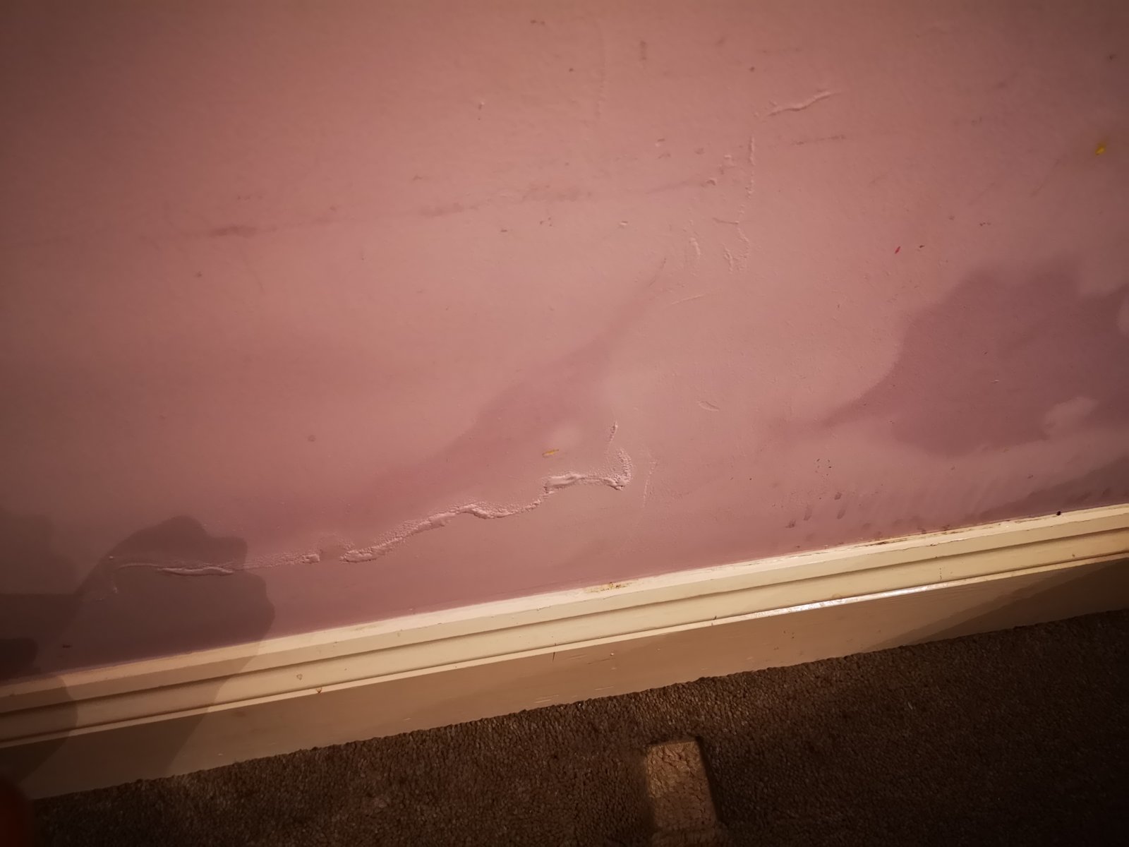

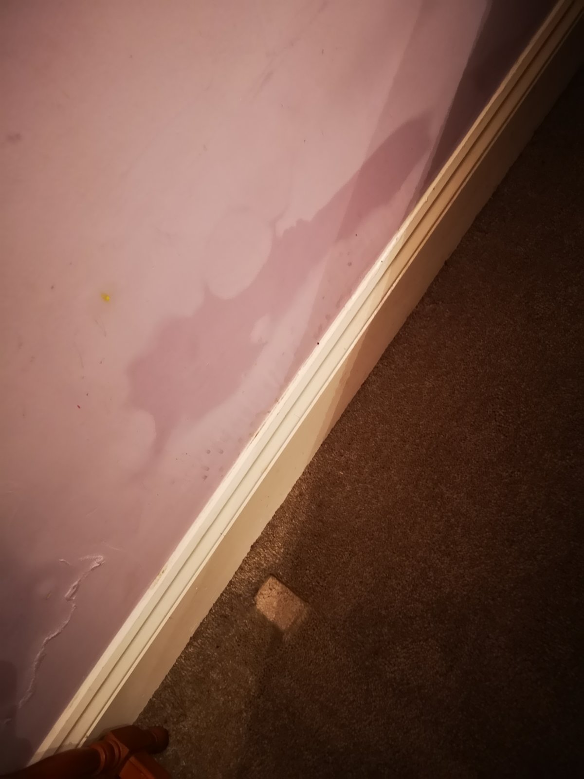

As you may see from the attached imaged we have come across in our sitting room a wet wall, which is located behind our sofa.

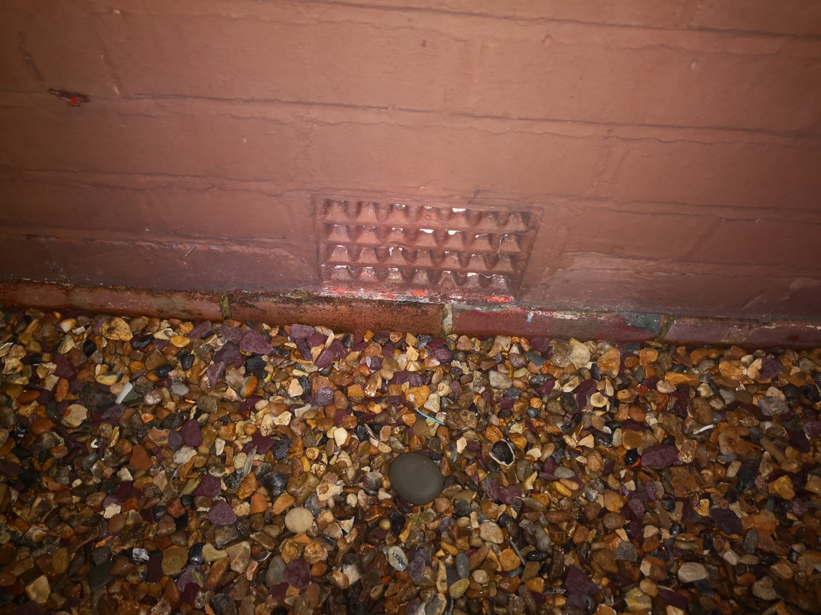

I have also attached an image showing the outside area of our home, which maybe the problem to our wall being wet?

I doubt it’s from that air vent. Any concealed pipework in the area? Is the vent the other side of the wall? Was there a chimney on the same wall at any point?

looks to me like the floor is wet. Is it a concrete floor? Lift the floor covering and see how wet it is.
I'd be thinking of a leaking pipe. Might be a radiator pipe unless you are close to the kitchen or bathroom when it could be other plumbing.

Just looked at pick again, the vent looked like it had been blocked off because of the paint.
Those are subfloor vents for suspended floors.

Also to note, we have noticed that our neighbours gutter does spill over to our walls when there is a downful of rain which may affect this?

I meant the floor in the room. A water leak can make a concrete floor wet, and the damp may rise up any wall from it. If the floor is covered you may not see that the concrete is wet.
Your wet pattern looks to me like it is coming from the floor. A wooden floor won't do this unless there is a lot of water underneath, soaking up the walls faster than it can evaporate off the bricks. Clean, unplastered walls are resistant to "rising damp" much better than plastered walls. and the brickwork under the floor will be unplastered.

That is typical staining of either rising damp, or damp settling on the DPC and then moving upwards.
But as part of the elimination process, you need to determine is if anything has changed - whether work has been done to the structure or externals recently, or changes to the room layout or even heating and usage patterns.

can you show where the FFL line would come on the outside wall?
the DPC appears to be in the bed below the air brick - which is where it should be if the FFL is just above the air brick.
the damp pattern suggests true Rising Damp.
there are indications that damp on that wall has received previous attention.
why not pull the carpet back and examine the edge of the floor for signs of damp.
