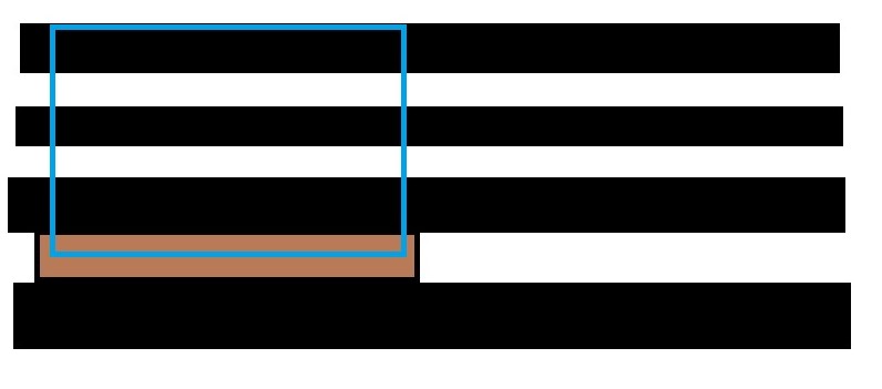

In the pic below, black are joists, blue is shower tray plus plywood/OSB. What timber do I use for the brown?
I guess fix 2 battens on the sides of the joists then plywood/OSB sheet screwed to the battens?
Just glue and screw bearers on the sides of the joists, keeping them level with the top of the joists so they can bear the weight. Treated softwood will be fine.
Will the tray drain be accommodated ok?
