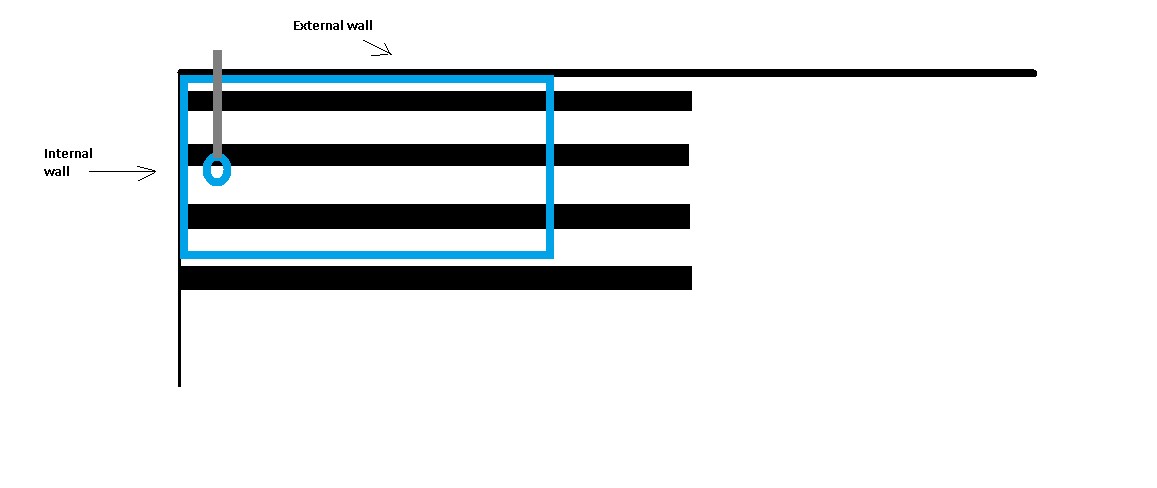

Yes I am looking Mira Flight on screwfix, it will be joist then 18mm marine plywood then tray. No leg riser kit. Apparently they are the best made and silicone is good enough for these
waste is an issue as there are two joists on the way. see pic below, what do you recommend?
For sure, the drain needs good access just in case it needs maintenance later.
It’s possible to install timber ‘trimmers’ which effectively bridge the cut away joist without losing any strength. A similar application is found where joists meet up to hearths.

Do make sure the tray can’t rock on your supports, and bedding it down on silicone will be just fine.

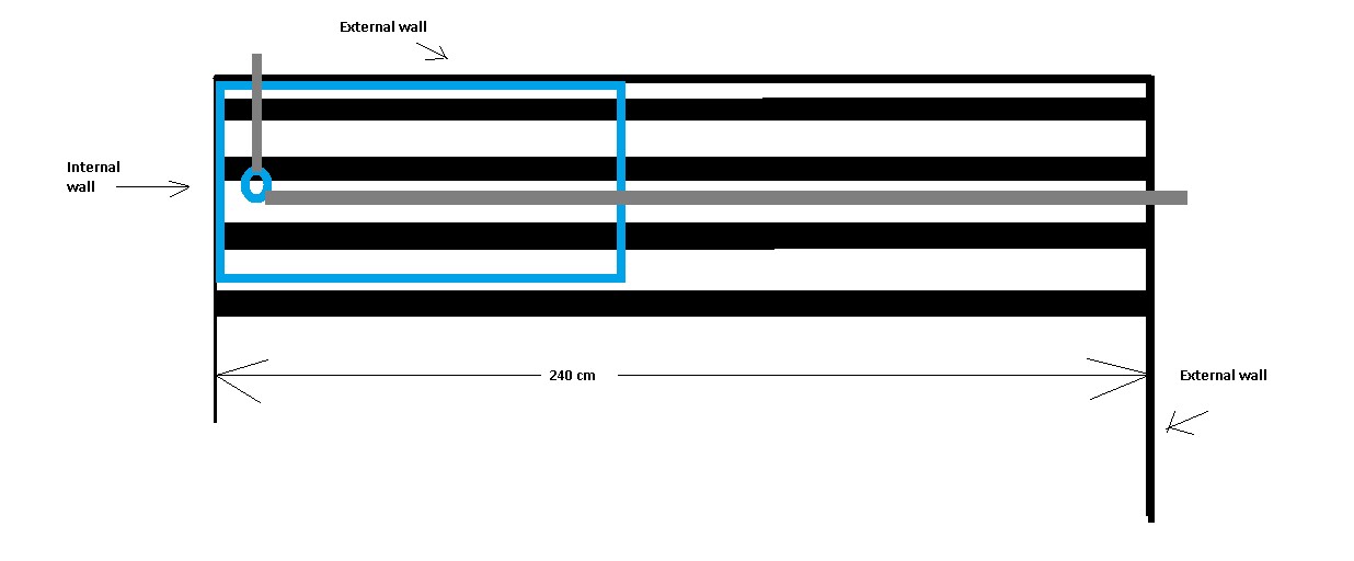

Or may I can use long path for the waste pipe 240cm?
I guess the shortest run is the better, but as long as you can get enough fall on the pipe, and have it well supported especially at the joins, all should be well.
