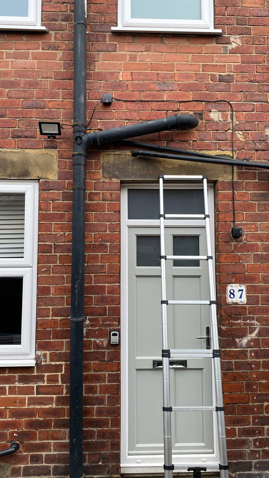

I am installing a new outside light see below location change (moving from right side of door where white cable comes out of wall above no.87 sign to above the kitchen window)

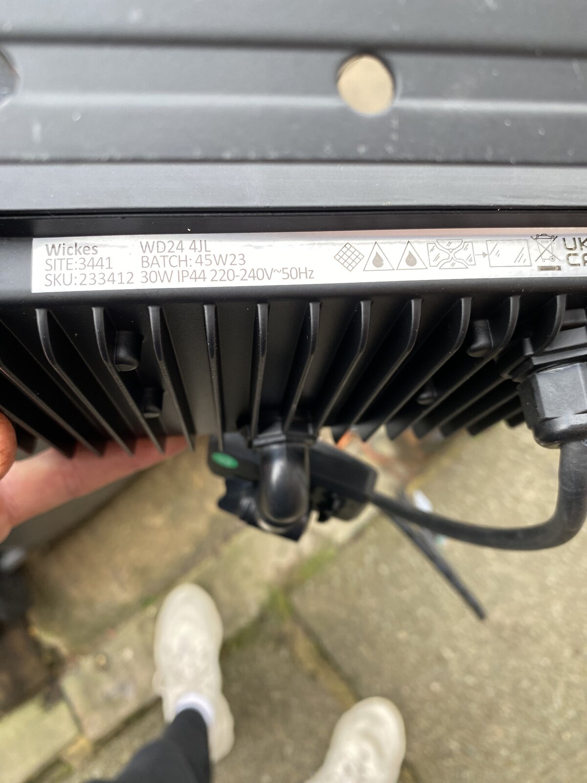

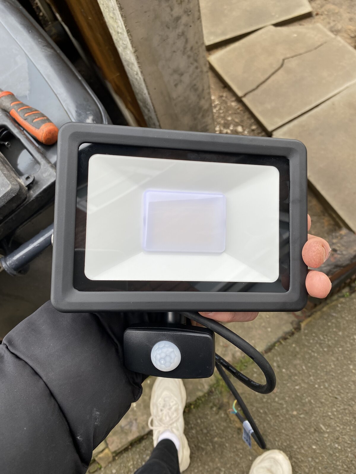

Pic of new light also below
I am going to install a junction box where cable currently comes from wall.
I neee to buy a length of black cable to connect from that junction box to a new junction box that I will install nearer the light
What size/type of cable will I need? Ideally from screwfix?
Inside the first junction box, can I use any bog standard electrical connector?
Cheers

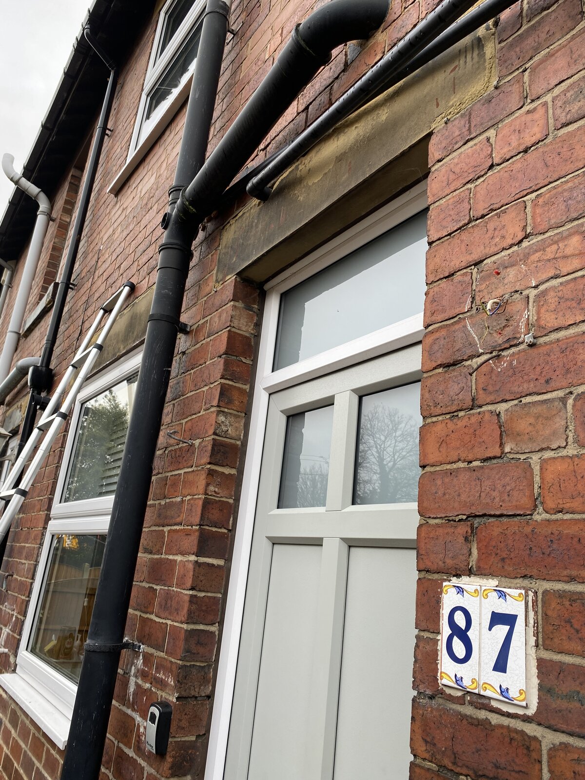

Many options, but likely a junction box over those wires to allow you to extend the cable. The problem is you will not want to drill into that huge lintel, and all a bit congested, so maybe black conduit is the way to go, would be in-keeping with all the other black plastic pipes, and is reasonable rigid to cross the lintel.
However would also look at crossing door on the inside, and following door frame.
Update: did it with a couple of new cables and I got some 1.5mm 3 core cable
Hi Markyyyyyy,
You should have used cable glands for them junction boxes, because over time water will run down into the one above your door number. Also that one has been installed on its side.

In the ideal world you NEVER have cables exiting any enclosure outside vertically - even with a decent gland, as sooner or later it will leak and start filling up with water

As others have also said, having cables that enter external boxes from any side except underneath is not going to stay waterproof for long. The correct way is to have a drip loop to shed water off the cable before it enters the box, you ought to do this for the light itself as well.
