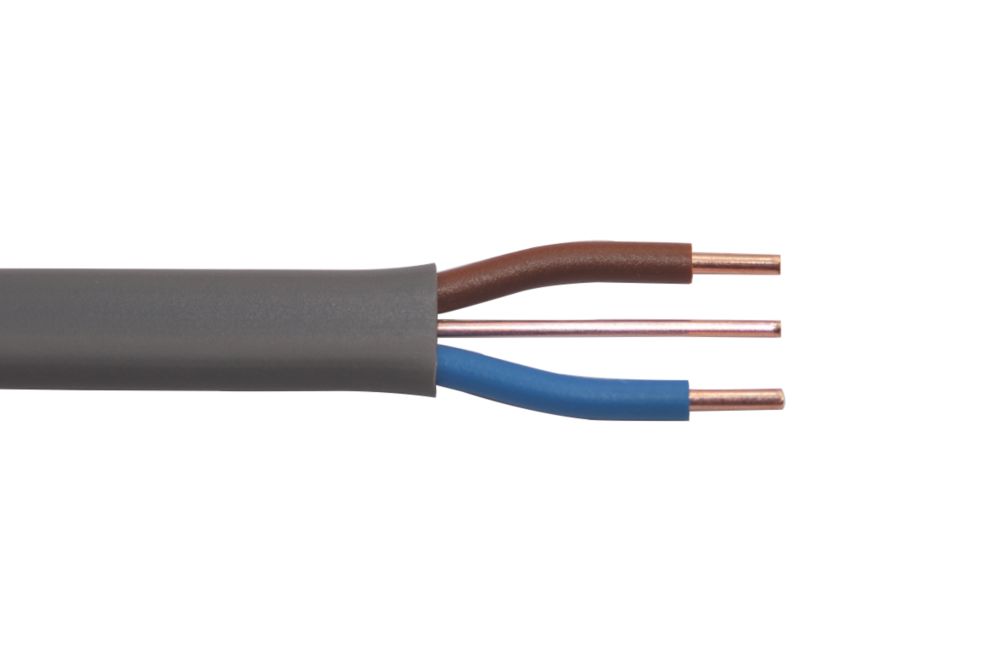

Hi,
I want to install an additional single socket as a spur on a ring circuit but I am not sure exactly what type of cable I should use.
The spur is a 13amp single socket and will be wired in to a 13amp double socket on the ring circuit. The distance of cable between the sockets will be approx 2.5m (max 3m). The socket will only be used for a hair-dryer and hair straighteners.
I have some 3 core flex cable (2.5mm2) will this be okay to use for the above purpose or do I need to use three core and earth cable and if so what mm2 should I be using?
Hope this is enough info and any advice/help is greatly appreciated,
Ed

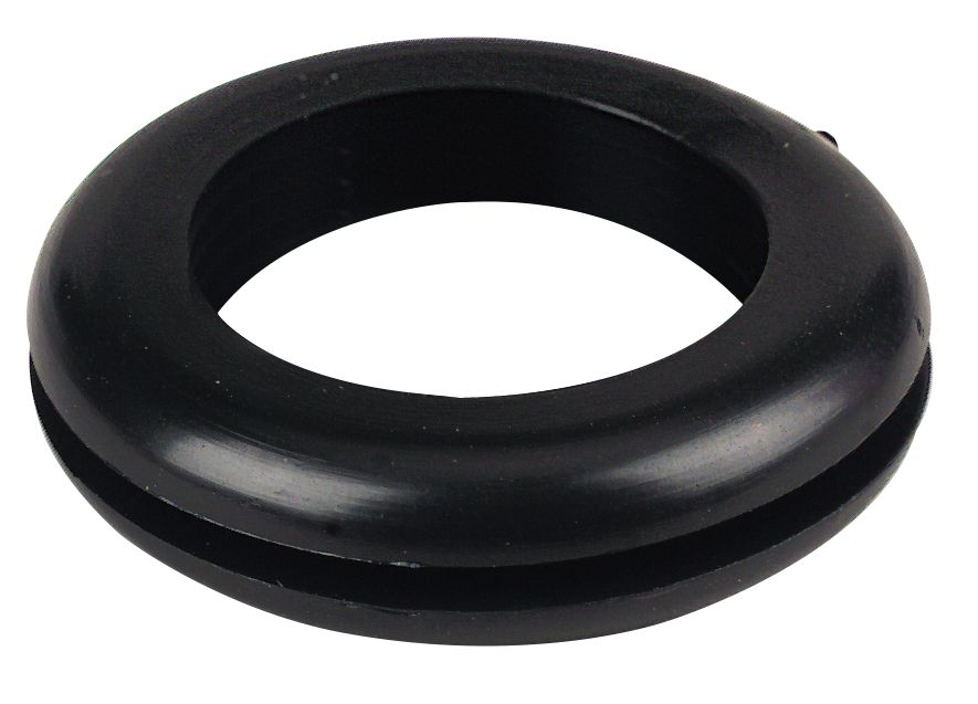

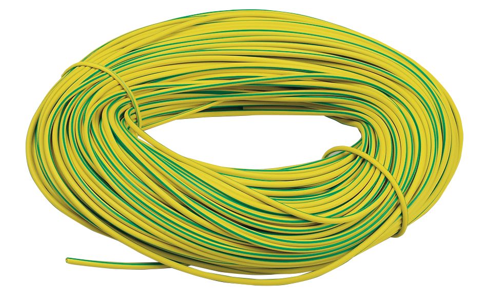

Ed, 2.5 mm² Twin & Earth is what you need, assuming that the cable will not be surrounded by insulation. You will also need to sleeve the bare earth (CPC) conductors. If fitting to a flush-mounted metal back-box, use rubber grommets to protect the cable from the sharp edgeds of the knockouts. 3m should be your max length without an FCU protecting the new spur.
