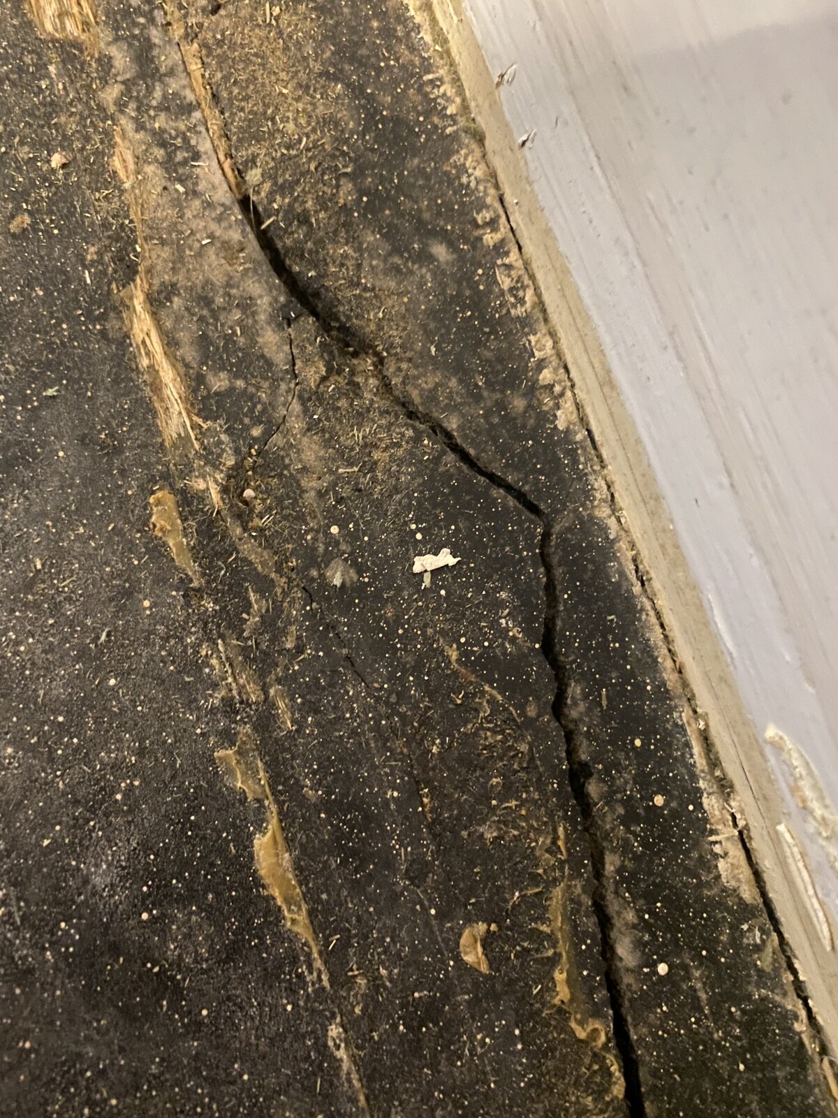

Hey Dazlight,

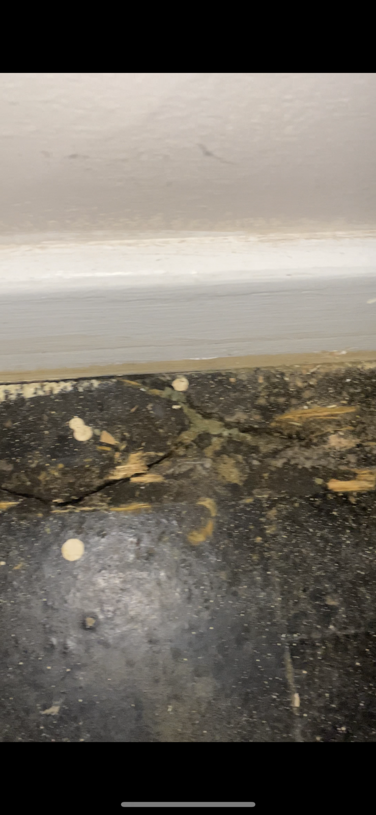

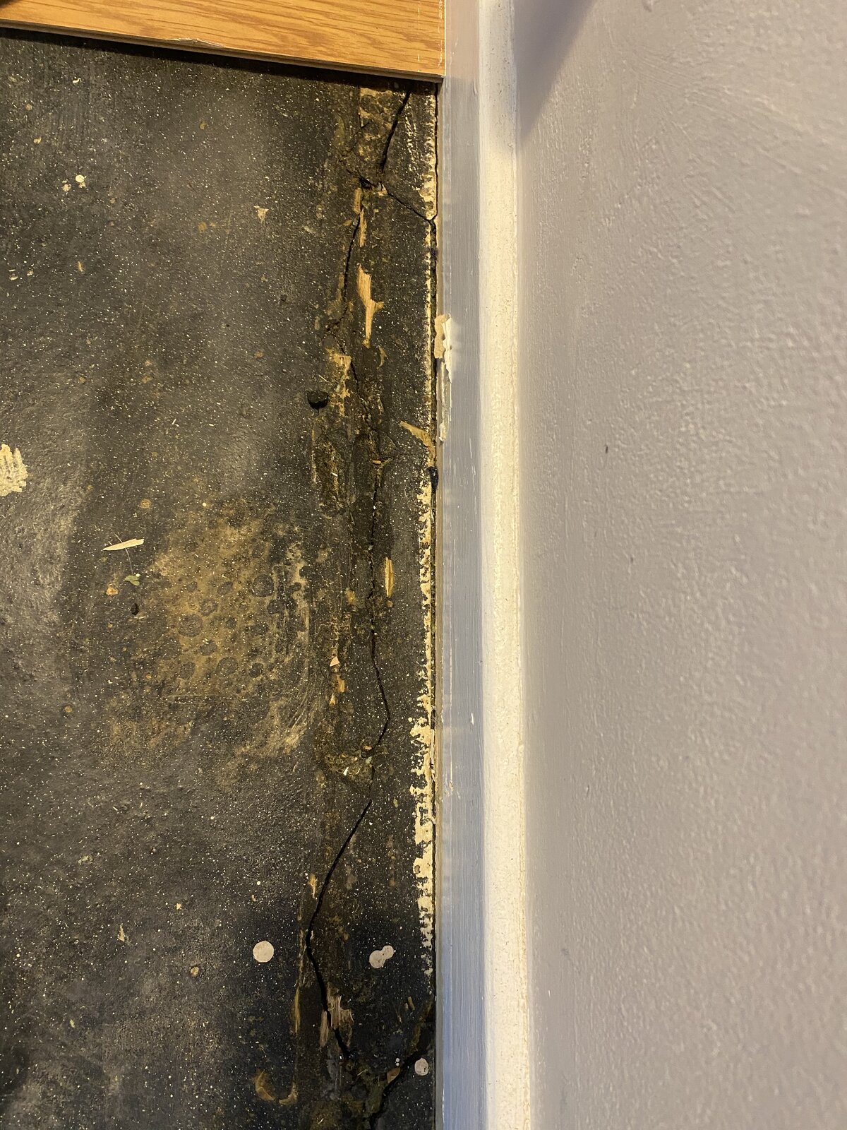

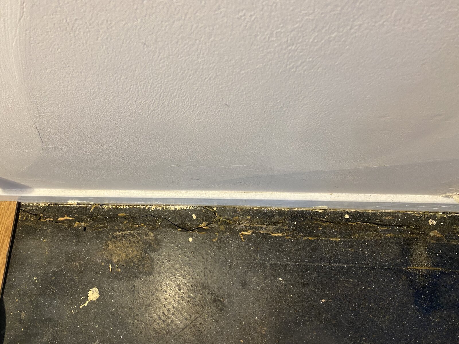

I want to put down a layer of floating click LVT (built in underlay), I’ve taken up my current laminate to be met with asphalt. It’s slightly cracked round the edges of the room.
What should I do? Should I lay 1mm sheet LVT underlay on top or put a self levelling down?
If it’s out of level more then 3mm over 2m then yes use a smoothing compound. Around the edges remove the loose bits and fill with ardex A45 repaid repair
Thanks so much. It seems bang on level. I was going to use 1mm LVT Click underlay just as a caution between the asphalt
Just really nervous about this asphalt, never seen it before! I’ve also got to take my skirts off
Be fine that with a click. It’s just gripper rod damage
Thank you man. I’m not sure it’s ever had carpet but I’ll go with that haha! So just put click straight on top? Nervous that when I take my skirts off its going to crumble away

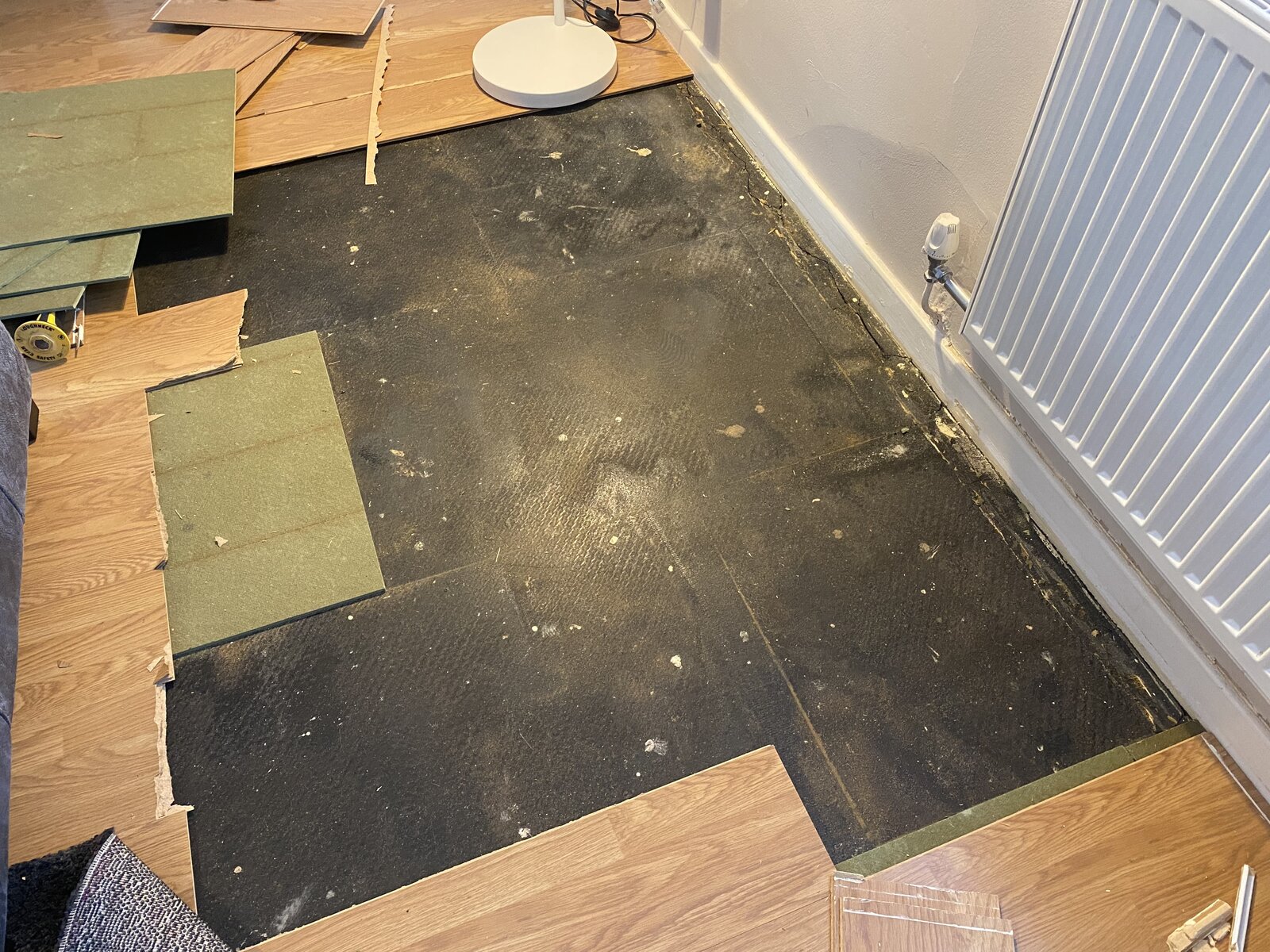

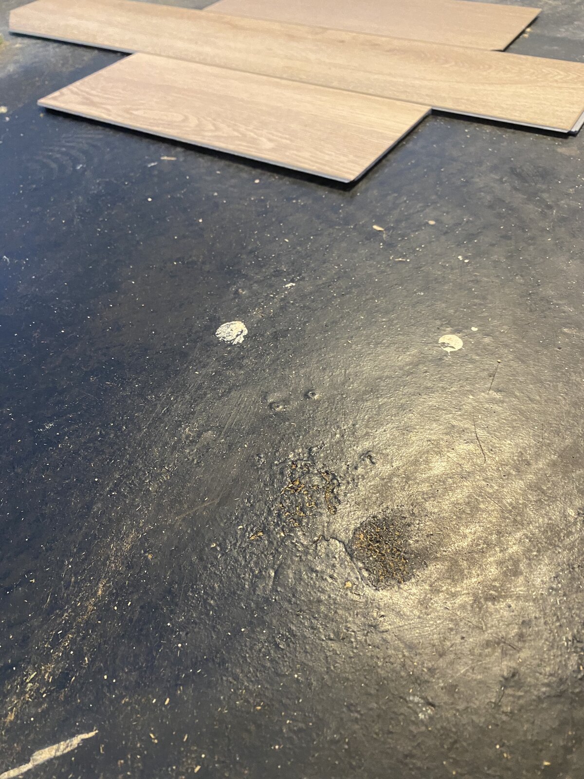

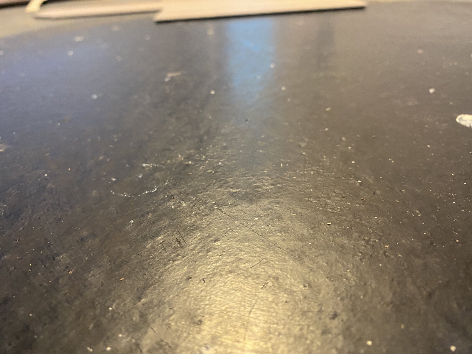

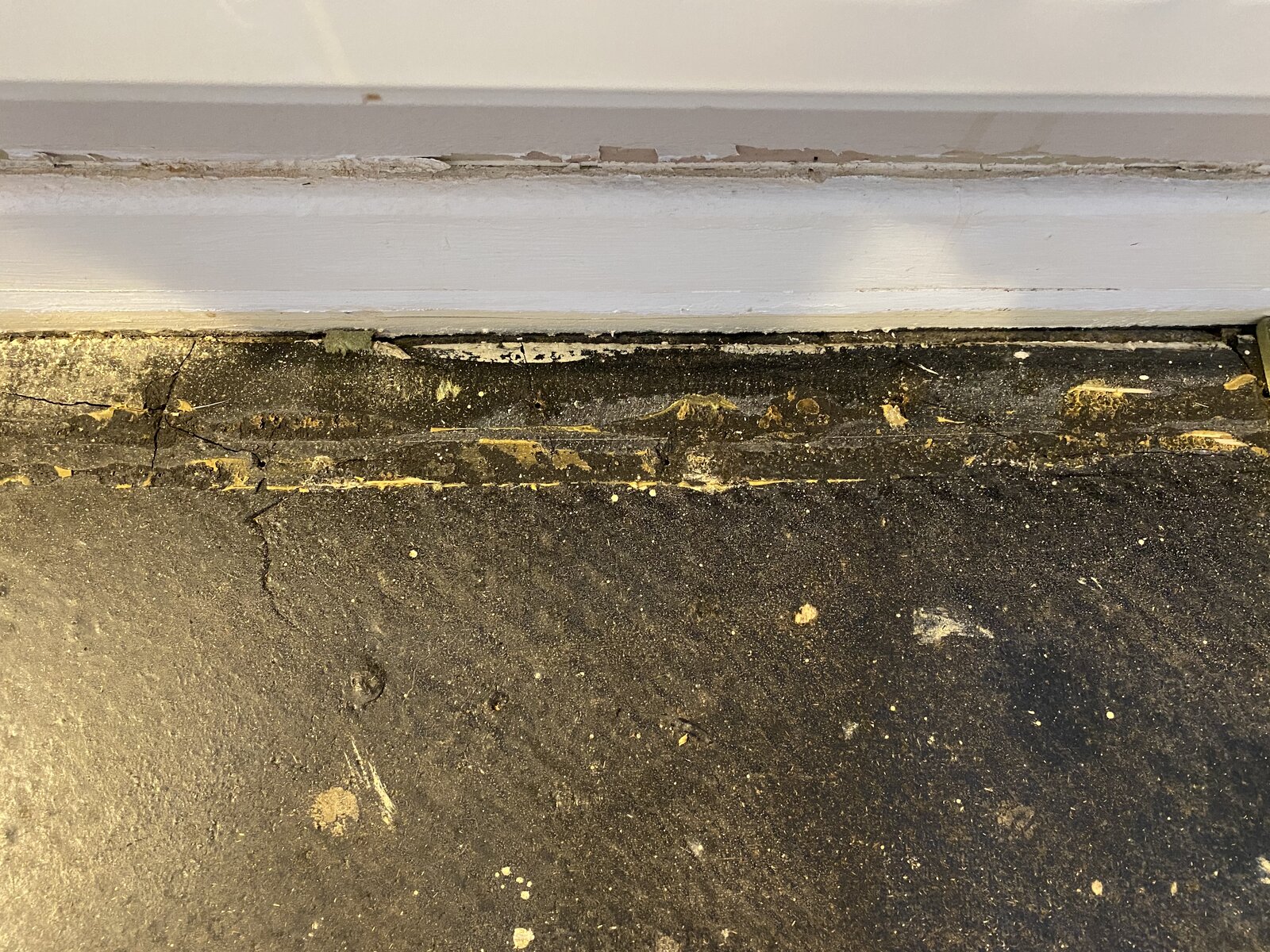

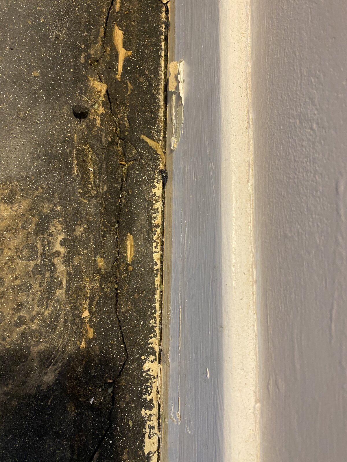

Hi Dazlight, I’ve pulled some more of the floor up and took some pictures. What you reckon?

Put a 2m straight edge on it and if you can’t slide a one coin under it you are good to go
