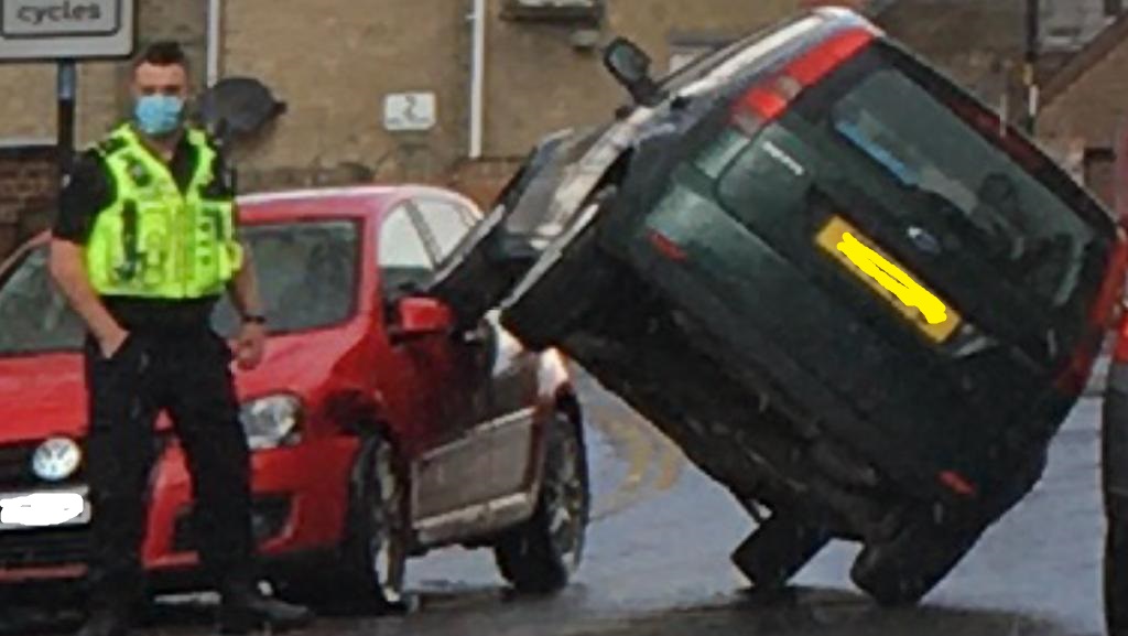

If I had made an error and clipped the corner of the parked vehicle then the first impact would have been my front wing on the other rear wing, neither of which show any damage. The first impact was wheel to wheel which is a physical impossibility unless one or the other was seriously out of position.

Here's another one - minor damage to the Golf.
I had an accident a couple of nights ago and what happened is a complete mystery to me. I was driving down a local road and needed to pass a parked car, so I pulled out. There was a car approaching but there was PLENTY of time to complete the manouver.
As I was just about to pass the parked car, there was a huge BANG, and the next instant I was on 2 wheels (it almost rolled), slewing across the road and into a garden wall on the other side. Fortunately the airbags went off and I managed to get out of the car, albeit with a hell of a thump on my chest from the airbag.
My first thought was that I must have clipped the rear offside corner of the parked car, but that would not explain why the car went up on 2 wheel (I wasn't speeding). There was no damage to the offside rear of the parked car, and no damage to my nearside front wing. The impact seemed to be "Wheel to Wheel".
My nearside front suspension was completely collapsed, wheel completely off and someone picked up a broken part which they said was the half-shaft.
The parked car ended up with both front wheels on the pavement and the offside rear wheel sticking out about 6 inches.
I really don't think I was driving badly and looking back it seemed I was driving normally and within an instant there was the huge bang and my car was on 2 wheels......
Any explainations what would cause this?????
You probably hit out turned wheel of parked vehicle, [tyre to tyre creates a huge bounce] had someone hit my golf wheel, virtually no damage but put them on the roof of their car.[Drunk female].
This means you miss-judged the distance however well you thought your driving.
