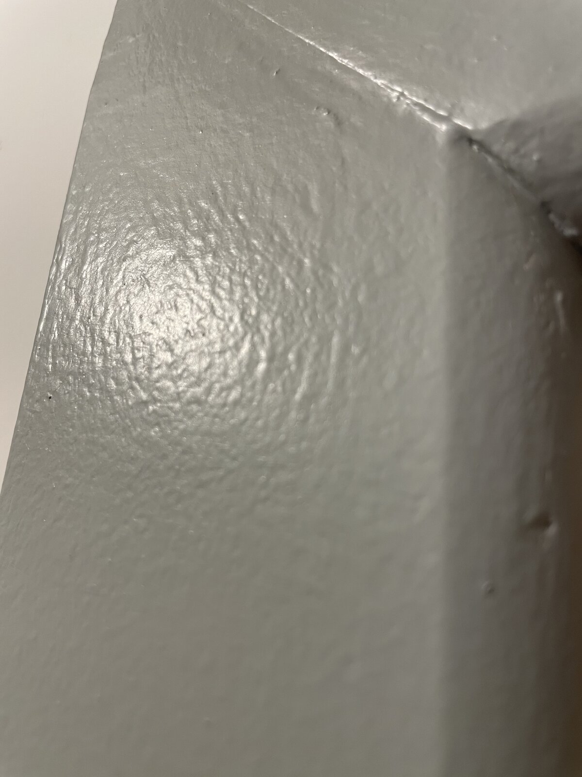

What caused this bumpy texture ?
28 Apr 2021
285
3

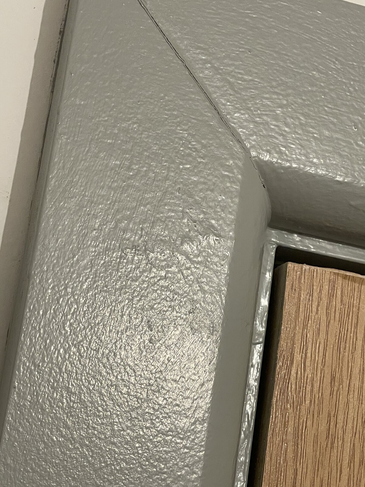

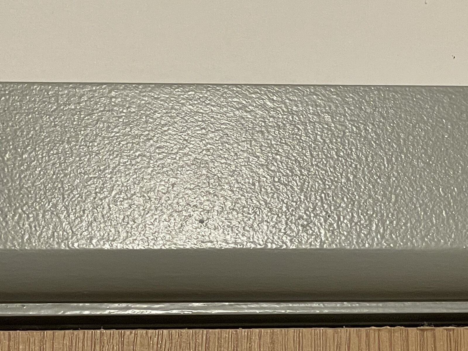

So I had some MDF skirting and architraves refitted and painted as part of an insurance job and I think they rushed the painting - the skirting and architraves are painted with dulux satinwood in grey, and they have a visible bumpy texture. I think maybe they sprayed an undercoat over everything, not sure. I am planning to use the same grey paint throughout (white gloss had gone horribly yellow) and I am keen to get a nice smooth finish. Any idea what caused this bumpiness and how I can avoid it when painting MDF? I think I’ll be buying primed MDF.

At a guess I would say it's either
been done with a roller
or
they didn't let each coat of paint dry properly.
To get a nice finish, use oil-based paint with a good clean brush (once that 'textured' finished is sanded flat).
So if I start with primed MDF, how would I get a nice finish using Dulux satinwood? Its oil based. Do I need an undercoat on the primed mdf? Should I sand between coats?
I would use an oil-based undercoat.
They say satinwood is self undercoating, but I would prefer to use an undercoat first.
Sanding between coats is not essential, but a good idea on areas where any crud, no matter how small, has found it's way onto the paint - this process is known as de-nibbing.
You may need to lightly sand the pre-primed mdf if happens to have a sheen to it, something I have noticed in the past.
I don't think the finished is sprayed. As others have said, it looks like they used a rad roller (very badly).
Pre-primed MDF is normally primed with waterbased paints- they raise the "grain". I you want a super flat finish, you will need to sand them with a fine abrasive (180-240 grit). Unfortunately, the sanding process will cut through the paint at the edges though.

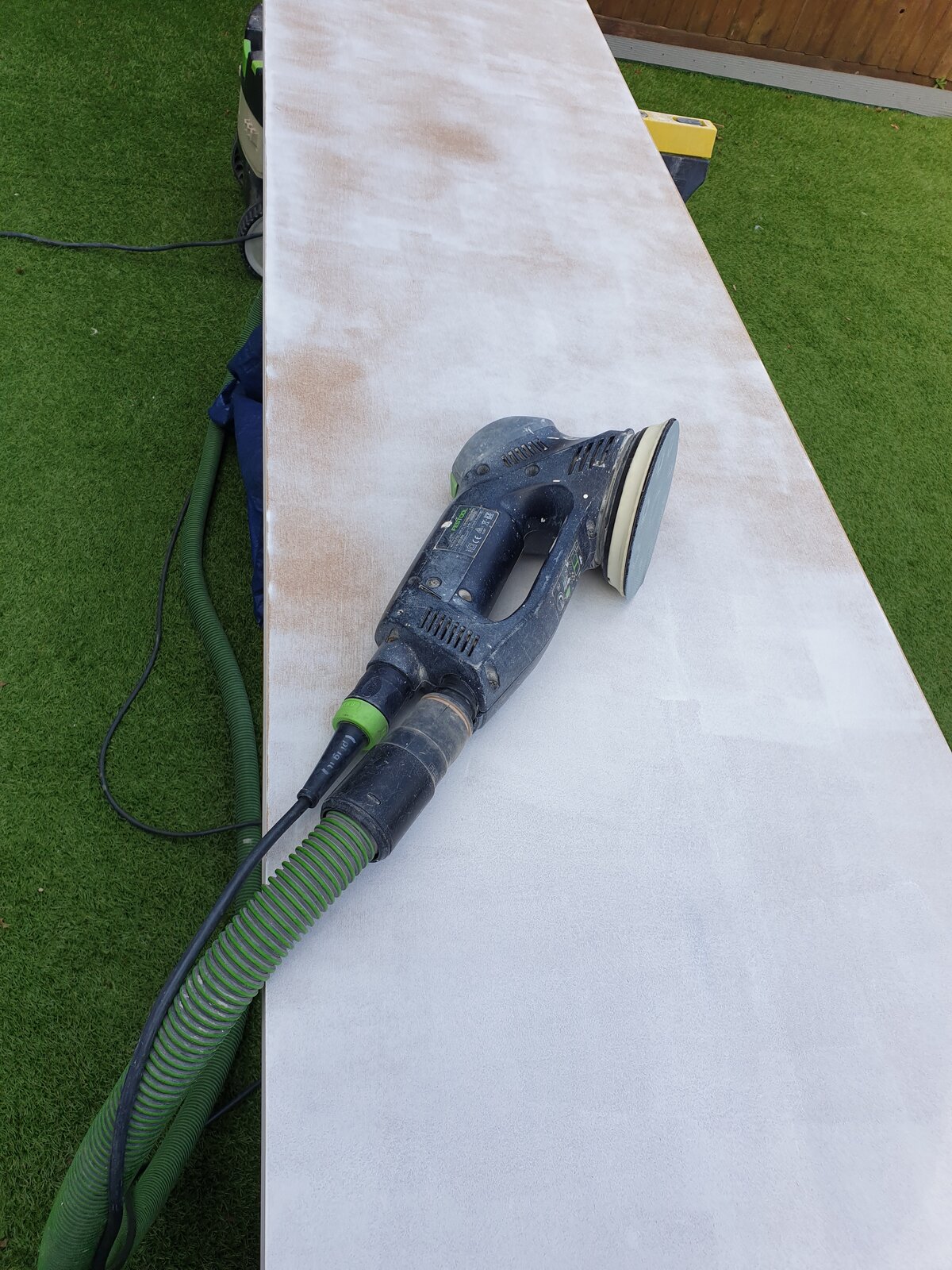

As a a decorator, I prefer to work with un-primed MDF (unless it has been primed with pre-cat spray which doesn't raise the grain). I then apply a coat of Leyland Trade acrylic primer/undercoat. Again, it raises the grain but it is both cheap and very easy to sand flat, easier than the waterbased paints used by timber suppliers. Frankly, I sand most of the paint off until I can see the parallel sanding marks that all mdf has as part of the manufacturing process. See the image below, even though the image is compressed, you should be able to see those parallel lines on the section sanded.
