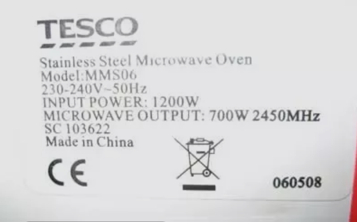

Surely the power consumption is written on a sticker on the microwave, presumably the same sticker that details other specs like the voltage, serial number etc
I'm not talking about the little 1000W/category E logo that is present somewhere on the front of the microwave; this is the heating power of the magnetron, and it is featured prominently on the front because you need to know it in order to interpret the cooking instructions written on the food you put in. This logo is nothing to do with the true energy consumption of the device, as can clearly be seen here in an example of the label I'm talking about:
