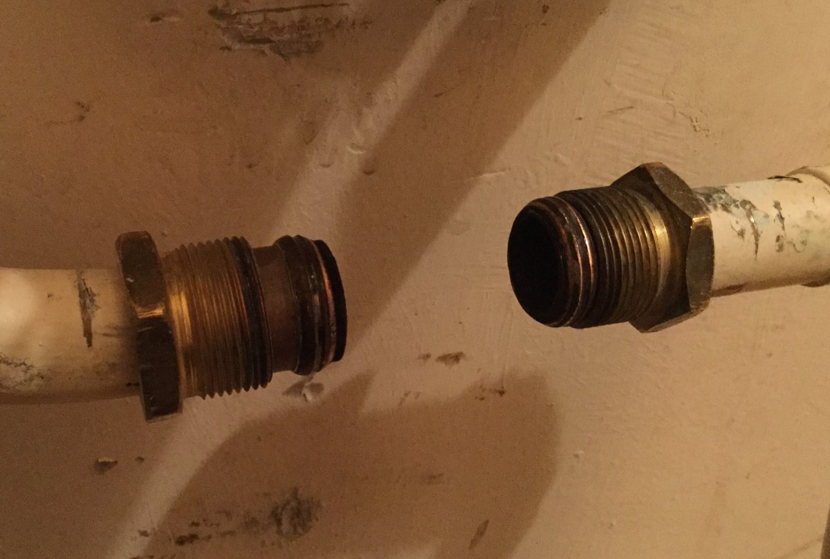

I'm in the process of replacing an ancient leaking Sunvic Duoval 3 port valve. Rather than replace with the same thing I decided to replace with a standard spring return Honeywell valve and get rid of the large duoval relay box. Since the old valve had what appeared to be 3/4" connections, I bought the replacement Honeywell valve with 3/4" connections in the hope of not having to alter any pipe.
Turns out the 3/4" fittings on the Honeywell valve are different to the old Sunvic one, so I can't reuse the old 'nuts' (see pic) and the new valve didn't come with any...
What do you call these 'nuts', and where can I buy some that will fit a honeywell valve with 3/4" connections?
Out of interest, any idea what fitting the old valve is - it appears similar to the 3/4" on the Honeywell valve but is slightly different size or thread so won't mate.
Help much appreciated as I'm rather stuck now...
Change the valve you bought for a standard 22mm valve. Cut and remove the old olives and discard the nuts. Use the new valve as supplied.
Thanks, I did see those in screwfix but was trying to locate the equivilent of the 'nuts' in the photo. What you suggest will be plan B...
