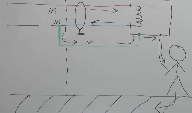

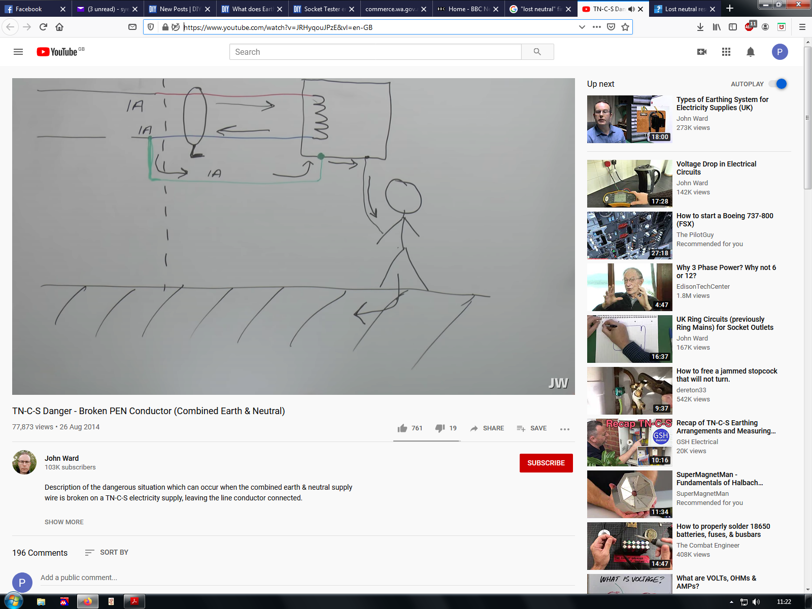

John Ward explains it in his video HERE
A screen shot from the video show why the RCD does NOT trip while the person is being electrocuted.
There have been numerous incidents of fires caused by high currents in undersized bonding cables and/or loose or undersize connectors in the bonding system

Yes, we understand that but -
