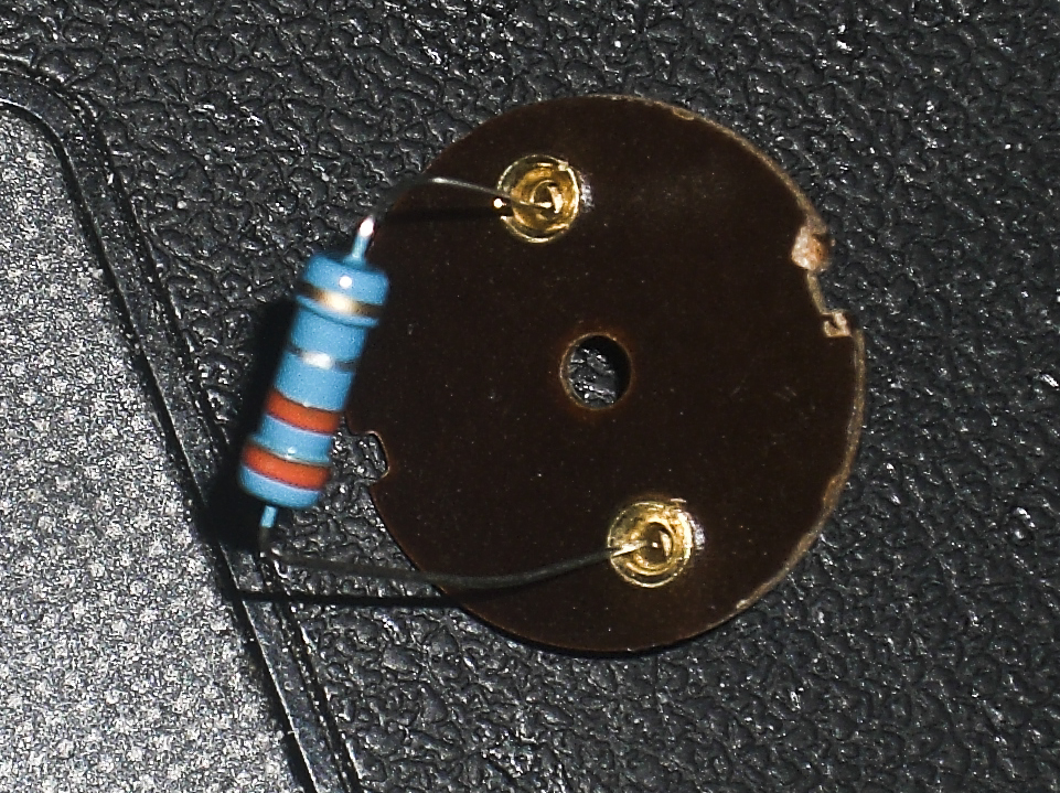

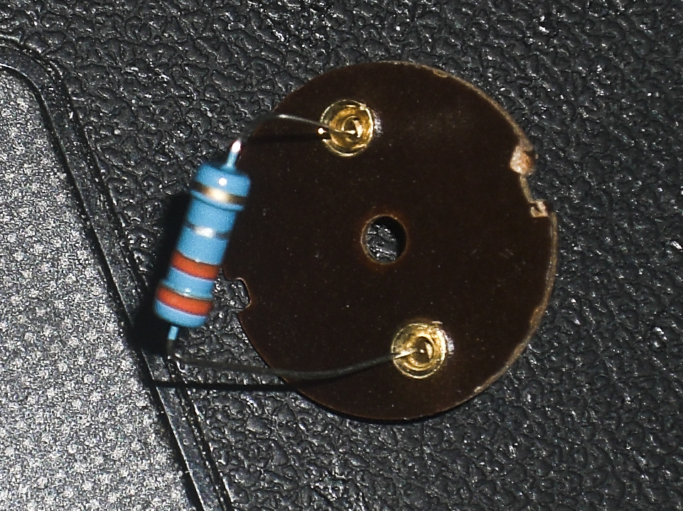

As I said looks like a resistor, but does not test as a resistor. So what is it?

However the starter as I opened it to see what was inside the writing has come off the plastic so yes I should put it in the bin before I end up using in now there is no writing on it.
View attachment 85565As I said looks like a resistor, but does not test as a resistor. So what is it?
It certainly looks like a resistor and, if it is, those markings presumably indicate 0.22Ω (and 5%). That would be fine for the purpose, although I don't really see what advantage it offers over 'a piece of wire' (per rocky's pics). However, did you say that it measures as >200kΩ? If so, have you checked it with more than one meter?
