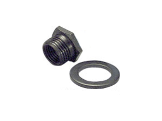

A little heads up on hole saws is that the bigger diameter ones need a bigger arbour and depending on your cordless the fatter arbour may not fit in the chuck. I used to have a worxs cheap cordless but the bigger arbour would not fit so I always had to use my 1 speed corded drill - not fun with a big holesaw. My new 18v dewalt has a bigger chuck and is fine with the larger hole saw arbour.
Good point - the larger arbors are 13mm, the smaller ones 10mm - make use of the torque limiter do prevent shagging your drill/wrist. They seem to work a little better at a higher speed, don't push too hard, let the dust come out/unblock the teeth regularly.
Nozzle
That's what the little adapter is for that comes with most sets, to use the smaller arbor with ≥31mm holesaws...
Grease it up or everything becomes inseparable after prolonged use! Especially if you don't have a bench vice nearby!
