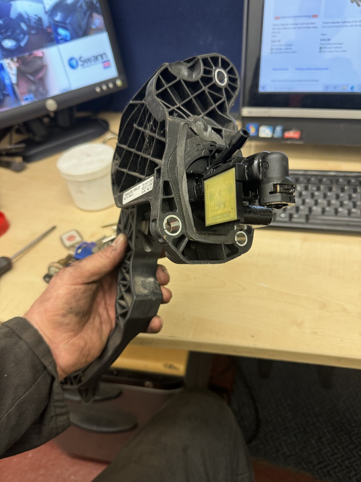

Up at the workshop at the moment - just removed the clutch master cylinder on the Golf. Bit of a faff - had to take all the turbo pipes and the EGR out of the way. Ended up taking the whole pedal assembly out. While I was under there I noticed a CV boot was cracked and leaking grease so I'll be changing that at the same time.

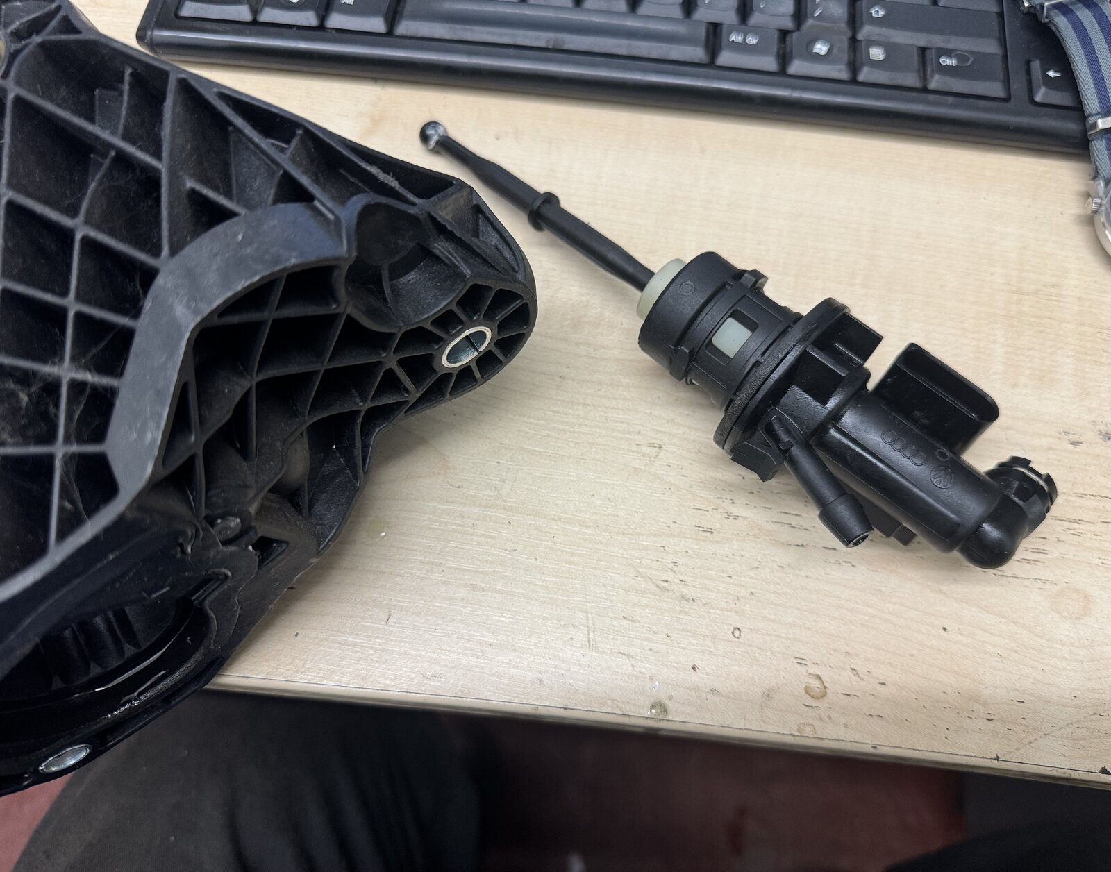

Up at the workshop struggling and I do mean struggling with this poxy clutch master cylinder on the Golf. Fitted it all up, connected the pipe, pressed the pedal and fluid pyssed out. The seal that seals the high pressure pipe is fitted to the cylinder and the pipe just snaps in place. The new cylinder didn't have a seal fitted! Had to take it all out again and dig the seal out from the old cylinder. Then, the fill pipe from the reservoir to the cylinder kept dripping - it's just a plastic push-fit pipe with rubber inserts in each end and the seal in that pipe was buggered. I ended up cutting 8" of pipe from my airline pipe and used that - temporarily of course. And would you believe it, I couldn't get a decent thermoplastic CV boot anywhere so ordered one of those for tomorrow. Fun and fecking games but then it always is on my own cars!
