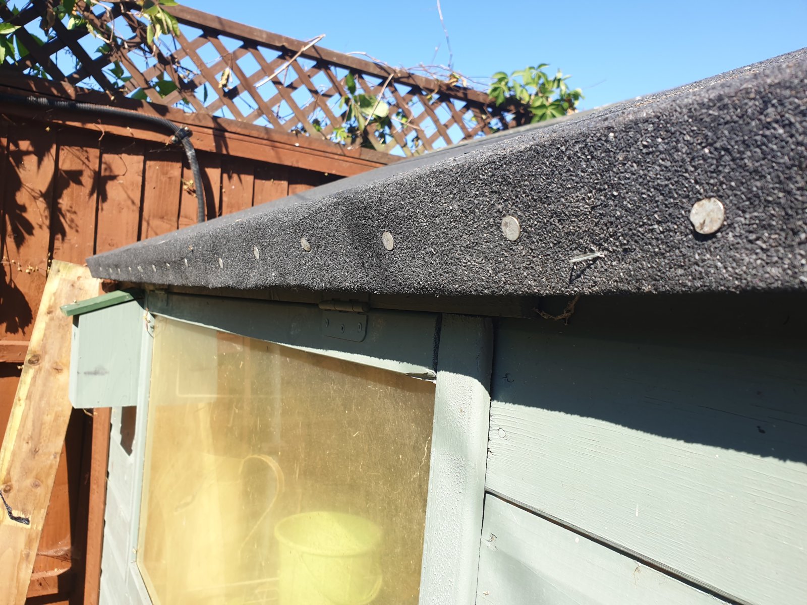

Plenty of tacks. Some of them are even in line with some of the others.Will you tack the felt all proper like a roofer?
You turn the felt the wrong way around and tack edge of the felt with the mineral facing the shed and hanging down. You then fold the felt up over itself - thus covering the tacks. You do the same to the next layer etc.Plenty of tacks.
Metal ridge cap?Probably being thick here, but how do you tackle the ridge piece?
Yeah, that’s what I have. Originally came with the shed.Metal ridge cap?
