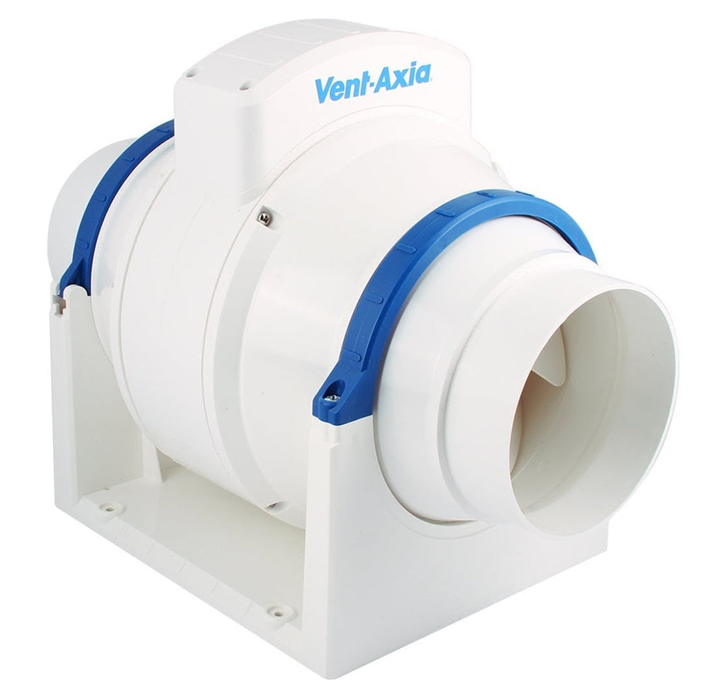

Hi everyone, I am getting house rewire done and going to get extractor fitted in loft whist getting done as currently none, I have a average 3 bedroom home and wanting a inlin3 extractor that will go in the loft then out of the soffit under roof, what is the best brands and what will be best size to get most moisture out , I know most have a m³ a hour etc ?
Is there a minimum I should aim for.
Any help appreciated
Thanks dean
The key is to have a sensible gap under the door - 6 mm minimum so the fan can draw dry air from within the house to ensure the moist air is extracted AND have the timer / over run set to 10 minutes minimum.
Then you need the vent pipe to be relatively short and the fan set higher than the pipe to the outside so any moisture runs out of the pipe and not back not the fan / bathroom vent
Something like the fan above is suitable

Example
Or a bigger one.
