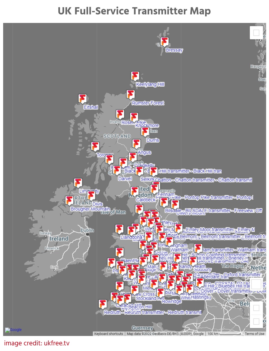

Not including the data and text channels, the UK 'lite' service covered by the Public Service Broadcasting (PSB) muxes has something like 45 channels. These are split roughly 60:40 for TV versus radio, and it contains 9 HD channels. That's the service you referred to as the UK being 'conned' :whistle::D:D:D LOL
If I look at my local full-service transmitter, I can pick up something like 150 TV channels and the 19 radio channels. There are a few additional channels allocated to data and text services too. There's something like 80 full-service transmitters covering the majority of the UK population.
These are supplemented by over 1000 relay transmitters providing at least a minimum of the 45 channel PSB service filling in a further 10% of the population coverage. About 2% of the UK population doesn't get a Freeview service.
All-in-all then I think we do quite well to cram this lot in to our tiny island nation without serious issues with channel clashes from adjacent transmitters including those on the continent.
There is however a con. A lot of those so called channels are part time. e.g. BBC4 and CBBC share one stream which changes its name, LCN, and programming every day at 1900 (I think that is the time). That is counted a two channels but to my mind it is one channel.
There are many other examples.
