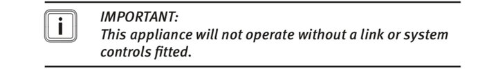

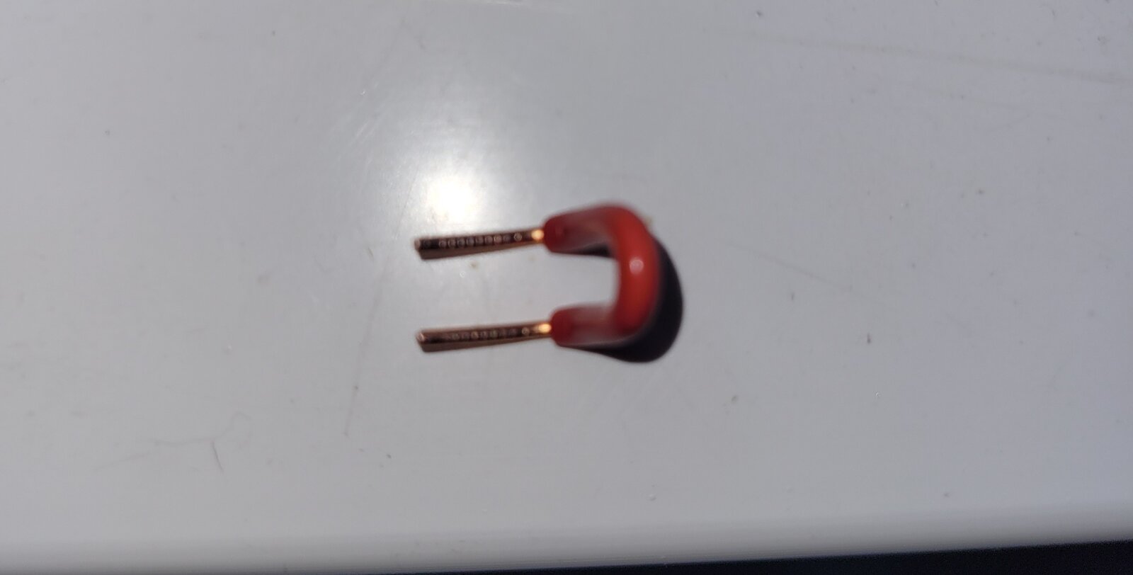

Basically I fitted a wireless thermostat 3 years ago worked great. Removed it today and boiler turns on no problem buy boiler won't even try to fire up. What do I need to do?
Would this have something to do with it?
  • Thanks
Reactions: DP
Sorted. I Had to make a wire for the RT where I took out the wireless reciever. Panicked a bit. Handed my notice to landlord today. paying last month with deposit. Thought I was going to have to pay for a new boiler
Thank you for your help last night. Had you not told me to put the little bits of wiring back exactly how they where I would still have no hot water.
Am I missing something?
That link is to run heating. Hot water is activated by combination part of the circuit when a hot tap is run.
That link would be required if boiler is a heat only appliance.
