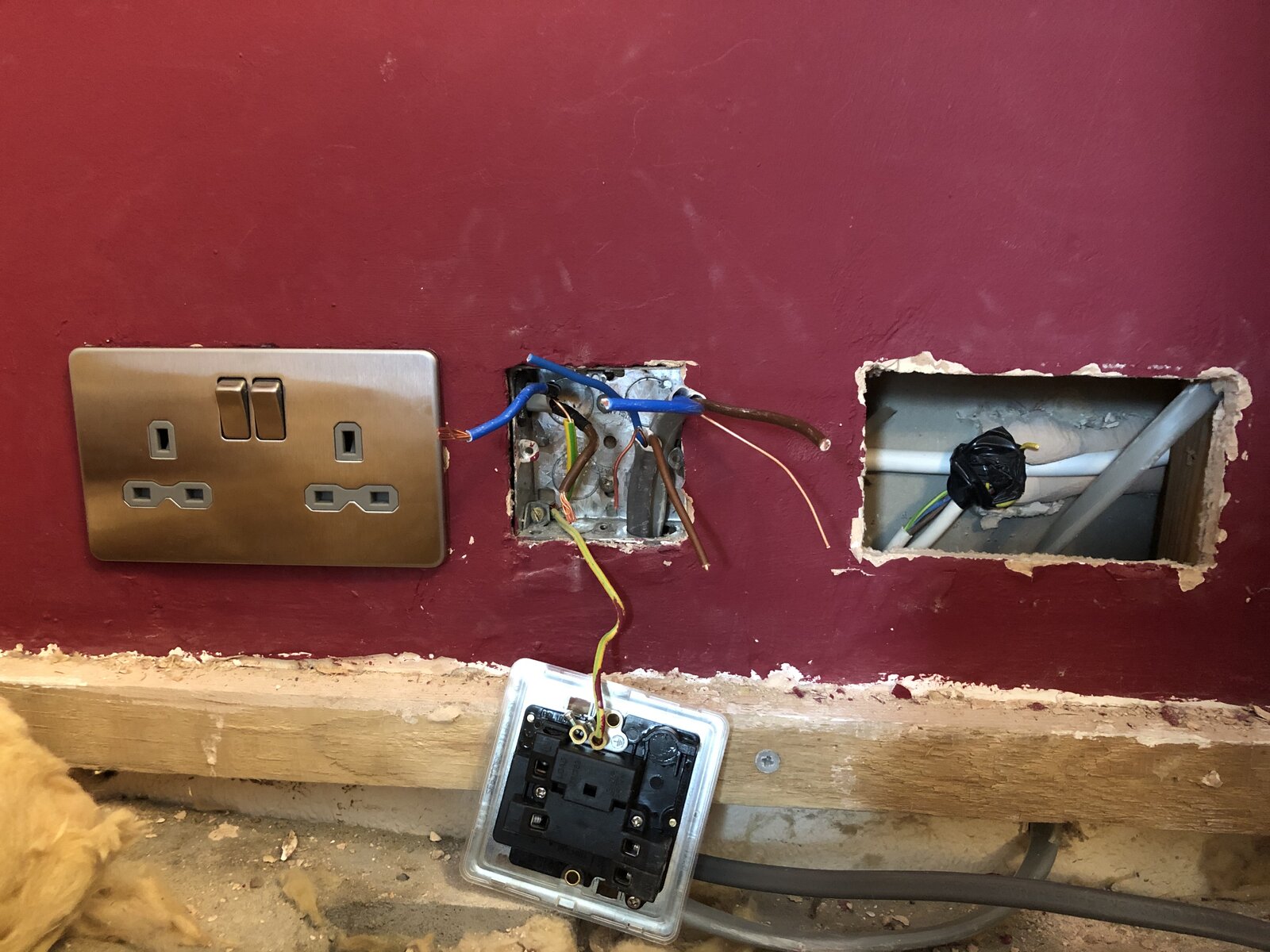

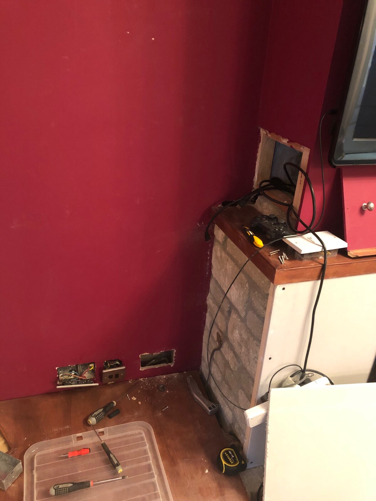

Hi all,
Hope someone can advise as I think I have started to overthink this!
I originally had a trailing extension lead plugged into the double socket which ran up a wall and into a cavity behind a wall mounted TV.
Doing a small redecorating job I want to neaten this up but also hard wire in a new 1.35kW heater.
Pictures:

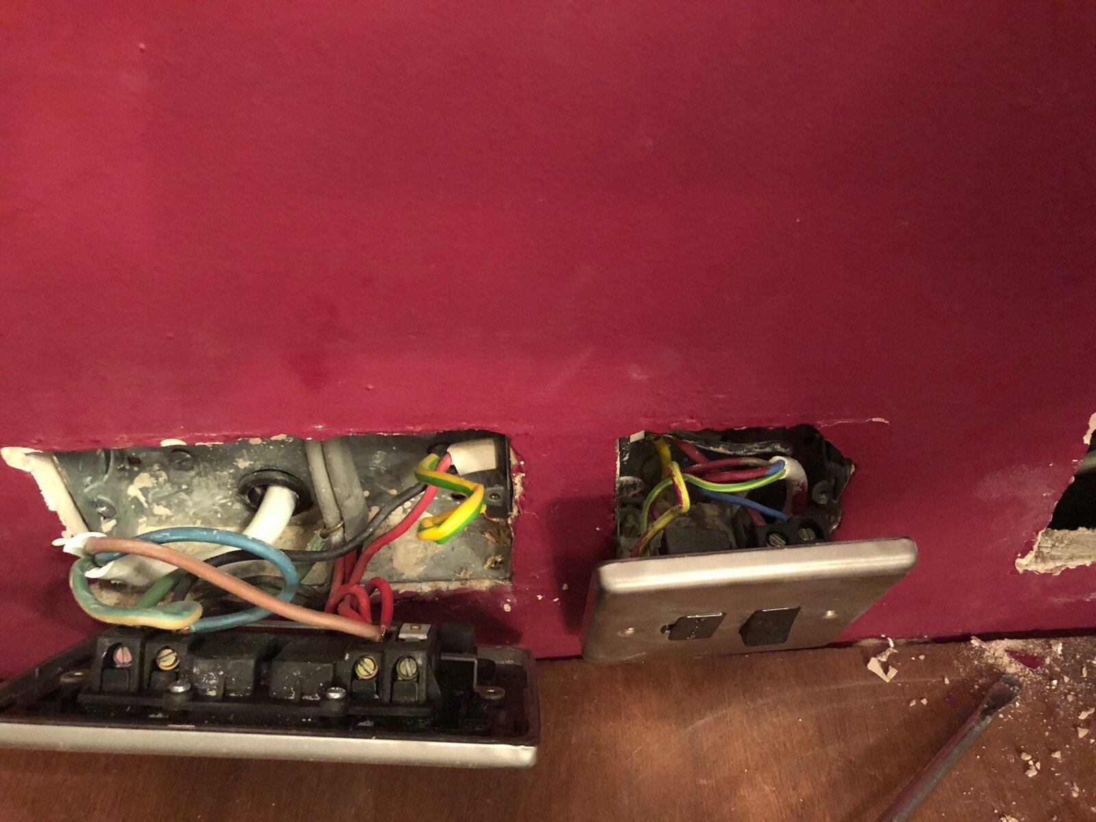

First double socket - ring main, looks like this is the entry point from the fuse box
Second socket - fused switch for old heater (now removed)
Third (empty) socket - heater single control switch connected to fused switch (was here but I have removed it)

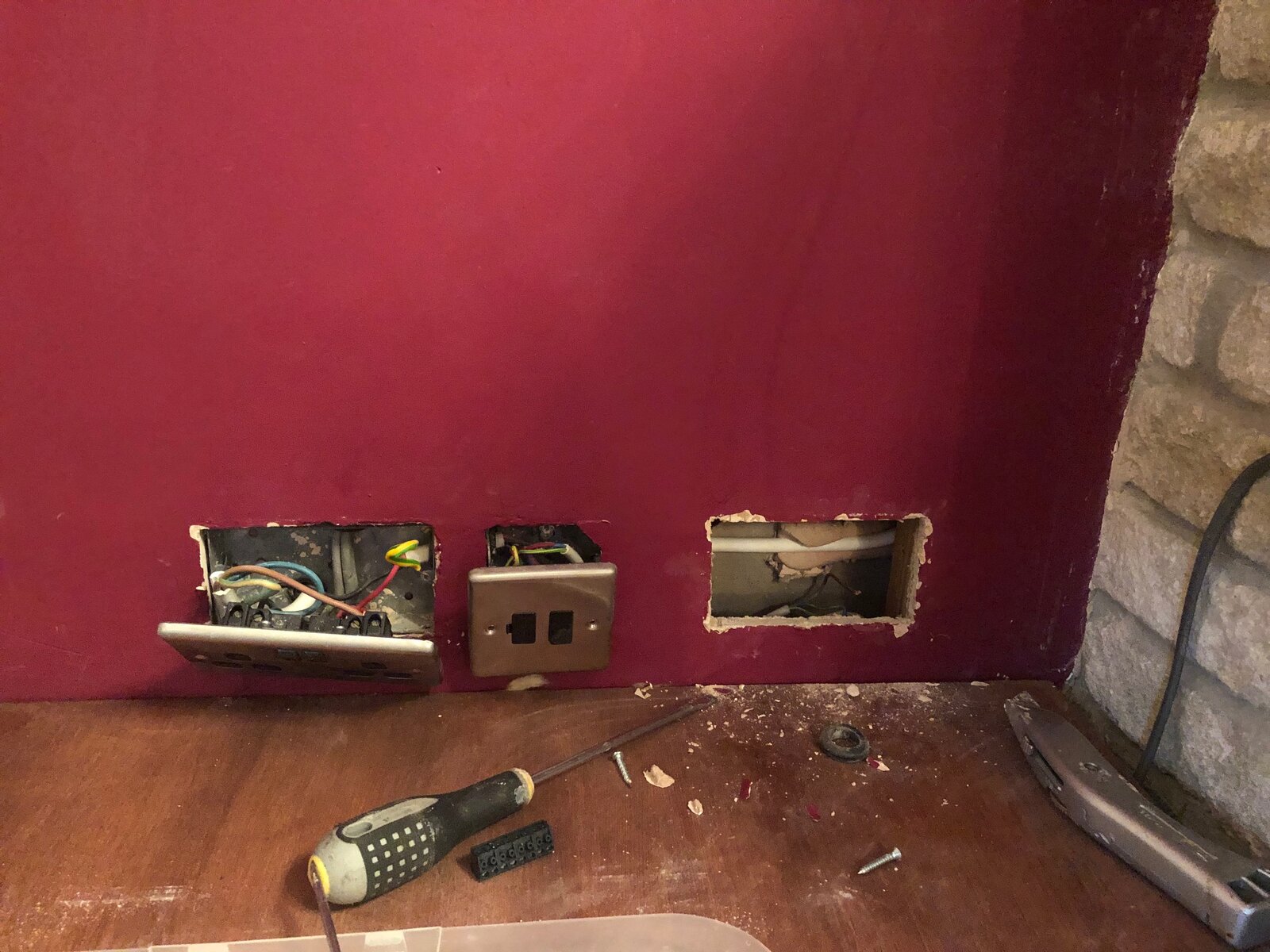

- I would like a dedicated double socket mounted behind the TV (in the rear cavity), to power the TV and maybe a soundbar
- I would like to hard wire the heater directly into the fused switch
With not being able to add an additional spur, I can't think how this can be best achieved without having to insert another socket in the ring (which I would rather not do as cables are quite tight), or have another trailing extension lead.
Any advise appreciated!
To add, types off appliances maybe being powered - TV, Soundbar, AMP (not likely, but maybe), Sky Box, Gaming System, Digital Photo Frame - and of course the heater!

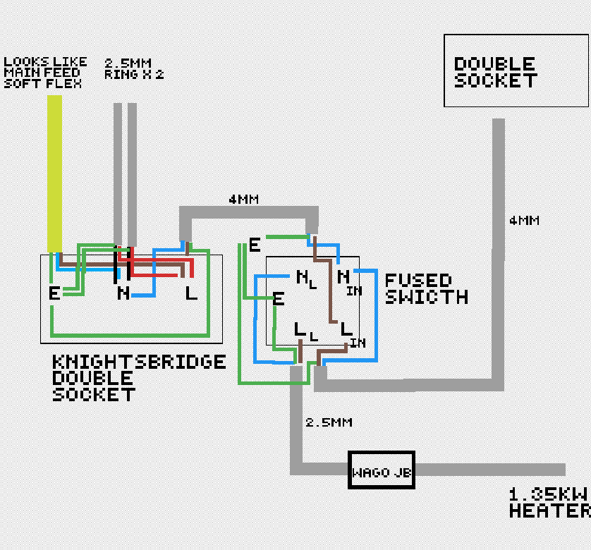

Use 4mm² cable from the socket which can handle the 32A of the MCB no matter how many sokets you fit or what you plug in..
Thanks EFL, understand, but for configuration I'm finding it hard to visualise this without 2 spurs or spur-on-spur? - I would like to hard wire the heater into the fused switch spur low on the wall (next to the existing double), and then add an additional double socket behind the TV cavity.
Two (or more) sockets are allowed on 4mm² spur cable as it can handle the same current as the ring circuit.
Cable from socket wires to Supply/In of FCU (Fused Connector Unit), cable from those same termials to TV socket.
Heater cable from Load/Out of FCU.
Brilliant, thanks - so in my mind a spur on spur using 4mm2?
Yes.
Just to point out - 2.5mm² is all that is actually required between the fused switch and the one double socket.
However, using the 4mm² allows more sockets to be added, so you may as well use the 4mm² as you have it.
It's much nicer to use than 2.5mm² anyway.
Thanks EFL - just one more thing which may be an issue:

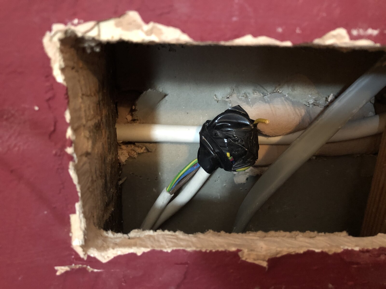

Please see in the first picture attached - the left hand double socket is wired as above.
The open hole where the previous gas fire electric socket was, you can see what I believe to be the mains flex (in the above image), looks to be running along the back.
I am wondering whether or not this is 6mm or 4mm soft flex (I can see no writing anywhere), and actually whether the previous owner (council electrician), would have used this for the gas fire (would a gas-electric fire have needed greater than 2.5mm?).
Can't tell - although it does look quite big.
He might have used whatever he had.
(would a gas-electric fire it have needed greater than 2.5mm?).
No.
The old fire has been removed and disconnected (I can't see or recall disconnecting this cable type as it was a while ago).
It must go somewhere. Who knows what someone might have done?
I could disconnect the white flex from the socket and see if all sockets up and down continue to work?
Could do.
And if so, am I fine to continue with the above wiring, even though the main feed is not at this point?

Hi EFL,
I have traced it to a 150W electric heater in the downstairs toilet.
So, can I have 2 separate 4mm spurs on the same socket, or should I rewire the toilet heater into the fused switch/back of the new double socket?
