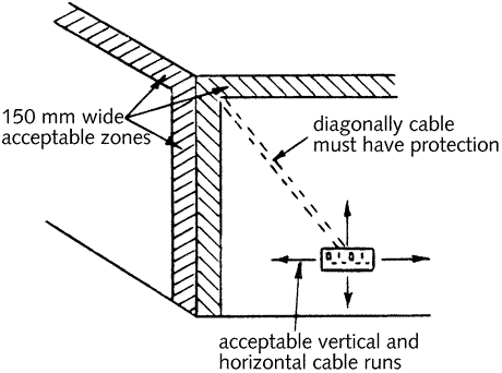

Sadly, it's 99.99% certain that you can't extend the wiring, as:
a) unless you use crimps the junction box that you use must be accessible, and I guess you want to fill in the hole where the switch was and decorate over it
b) you would then have cable running in an "L" shape in the wall, which is not allowed (unless it's more than 50mm deep, or enclosed in earthed metal conduit or trunking, neither of which are probably true in your case?)
see also http://www.niceic.org.uk/downloads/concealedcables.pdf
So, are you saying that I need to get under the upstairs floor and run a new cable down the wall vertically to the new switch?
Ok. I can do that. Thanks for taking the time to help. I really appreciate it.
if you don't mind a blanking plate then its ok to replace the lightswitch with a blanking plate (and terminal block behind) and run horixontally to a new switch
If L shape cabling is not allowed, how are ring mains installed?
Surely the usual arrangement for ring mains is to have the first socket in a room connected via a vertical drop and then subsequent sockets in that room connected to each other by horizontal runs of cable, with a vertical cable running up the wall from the last socket in the room. I know sloping cables are not allowed but I thought horizontal and vertical cables were OK.
Or have I got this all wrong?
In your example there‘s a back box and accessory at the point where the cables change direction. That’s the difference.
It’s much more common to drop back down into the floor void from each socket though.

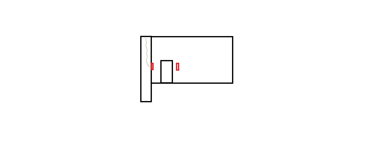

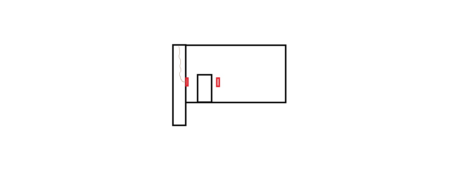

I realise the age of this thread but I actually have a question in relation to this.
I have a light switch on a wall behind a door which I would like to change to the opposite wall and side of the door.
I'm happy to leave a blanking plate in place of the existing switch and use wagos.
The wall is constructed from lime + lath on timber verticals.
How would a spark make a run for the new switch with minimal disturbance to the walls themselves?
Is there a room above? If so, you can pull the floors above and locate the wires to the switch and as you've got lath timber walls it'll be easy to drop down the wires (with the appropriate tools ofc.)
I can't get access from above but I could go from below and lift the carpet there. Putting a carpet back as it was before though is definitely not within my remit haha
