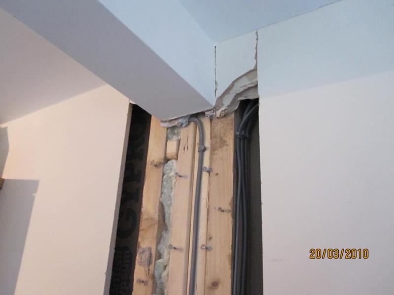

well here is what was holding the wall up, what a total nightmare its turned into, ive had a se round today who said we have 1 hope, that we can support the beam by bolting it to another beam what runs accross the house, if we cant, then have to either build the wall back or pull up masses of floor to lay foundations to support the post that will support the beam :(

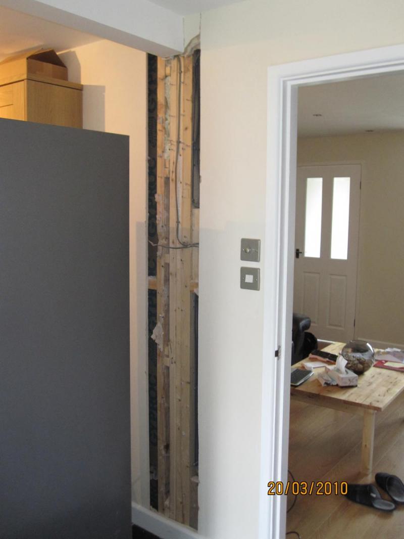

Sorry to add to your woes, but it looks like your 'builder' hasn't done you any favours with the electrics either.
The wiring, originally concealed in the corner of a room, would have been in a 'safe zone' created by the junction of two walls. That 'safe zone' disappeared with the removal of one of the walls.
The wiring to the switches should run either horizontally or vertically, it should not change direction halfway along the run.
Both could probably be addressed by protecting the existing cables with some appropriate steel trunking and/or conduit (not capping) before making good.
well hopefully that will be addressed, ive had the se round and hes hoping we can bolt the beam to a beam above the one in the kitchen, hes doing calculations, that way the wood can be removed.
I agree the electrics leave a lot to be desired, but cable runs have to change direction otherwise they'd never get to their destination.
Nothing wrong with that as long as in safe zone, >50mm deep or protected in accordance with regs.
