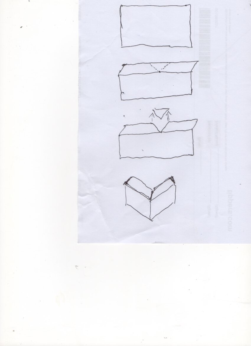

What products for fixing split in lead flashing and for join to parapet coping stone
Roger that. Makes sense. I'm probably going to use Code 3 - bit cheaper than the Code 4. Shame I'm only going to use a small part of the roll.
If eBay item 116280720589 at a tenner for half a metre of 6 inch code 3 isn't value for you, how about finding someone locally who is having their roof re-done and ask the roofers if you can have a couple of the old soakers; I'm sure they'd be happy to swap some for a couple of bottles of beer if they feel like they need something to make it a bargain
