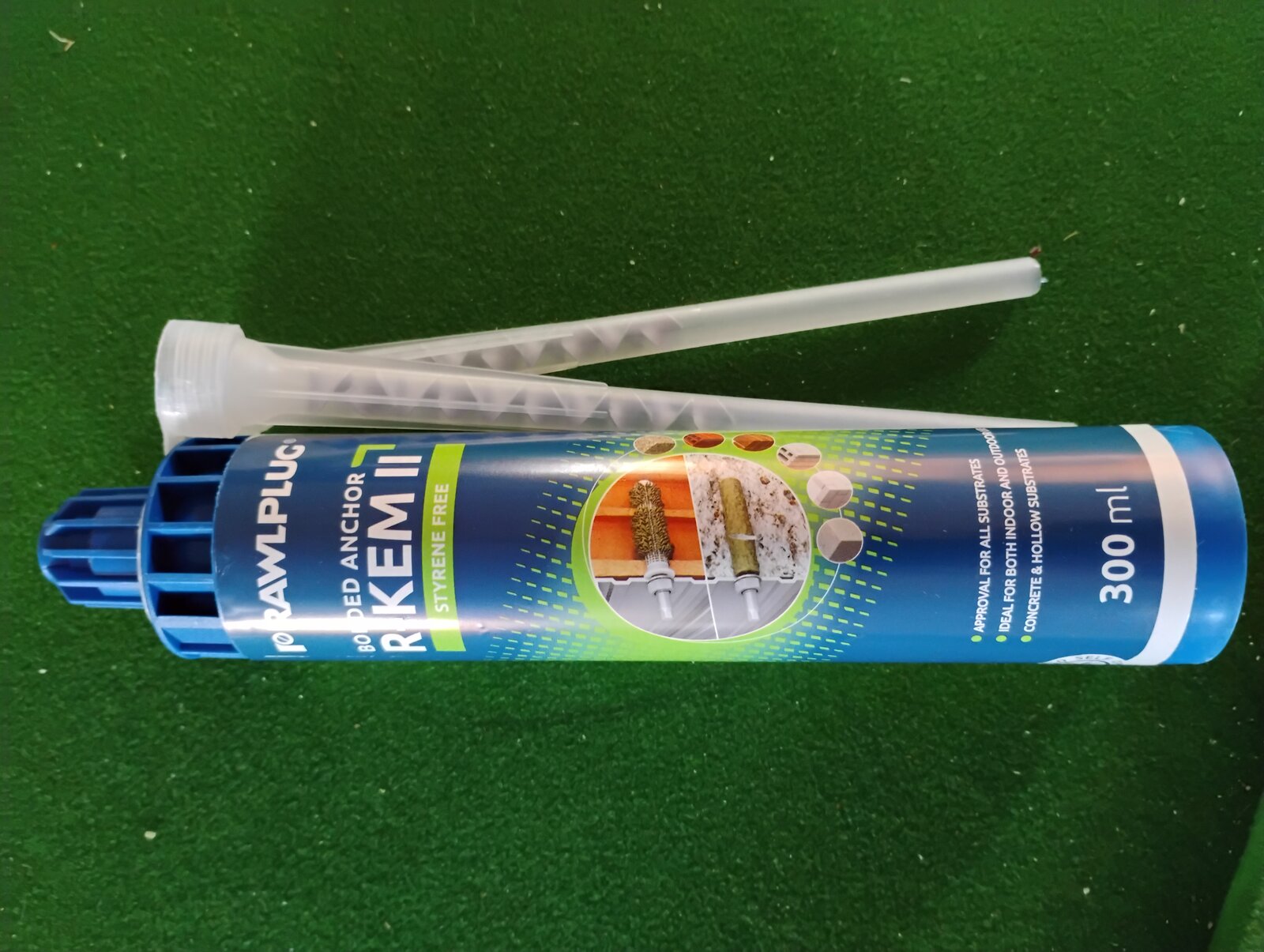

Does anyone have a recommendation for where to buy resin? I got the stainless bars already. Its probably caused by straight joints in the block work. It's for a garage wall.

Not heard of bold resin I got this stuff but not sure about it?
You should not use any old resin. Ideally, you should use the type specified by system manufacturer you are using.
Most comes in a tub, not a tube and is cementeous grout not pure polyester resin.
