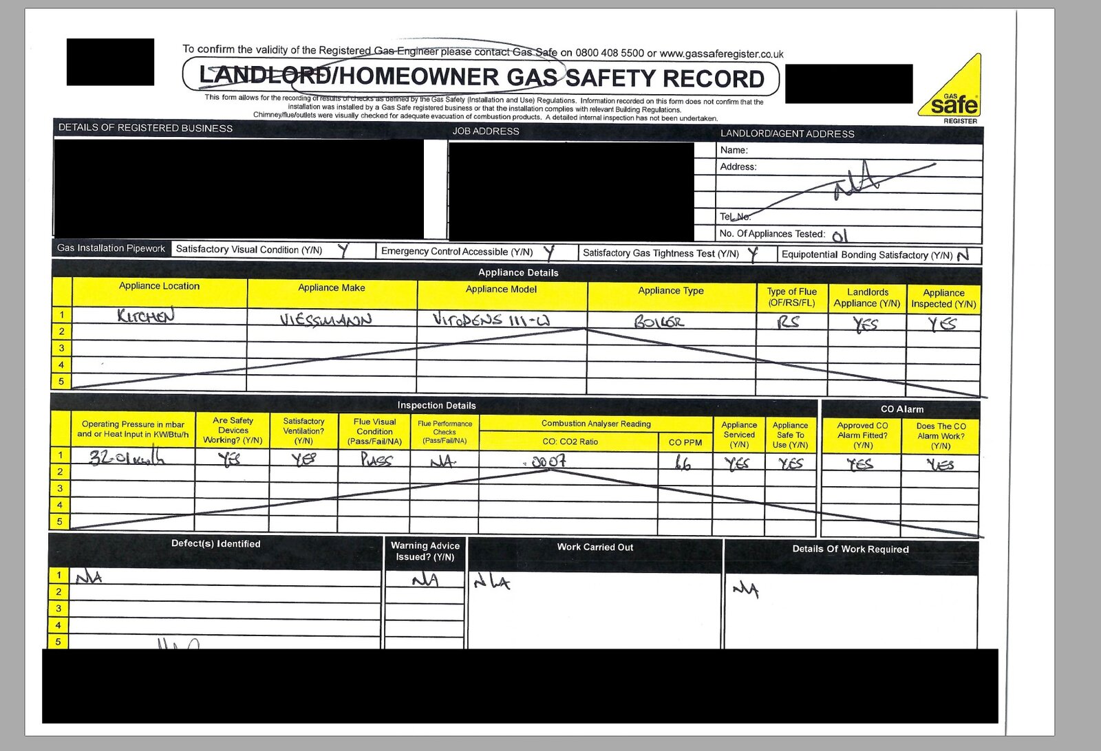

what should my boiler service certificate look like
Confused by all the replies.....here is a redacted screenshot.
Is this good enough?View attachment 269837
The bottom line is that it IS good enough. There is no REQUIREMENT to provide a “certificate” at all, and many RGI’s will just issue an invoice with the chargeable item listed as a “service”.
I would be more concerned as to wether the work was actually carried out properly. In fact, what you received was probably a basic check (known in the trade as a “poke ‘n go”), coupled with a tightness test.
Why did you have a Veisseman Engineer there,after the service? He was wrong to say tge firm is inadequate
That cert's fine. Yes as others have pointed out it's not strictly needed and he has marked a part incorrectly but that doesn't affect the validity.
Excellent question though, why was a Veismann engineer out if you already had it serviced? Some kind of warranty call?

I had a minor problem with the boiler, I think I might have pulled out the flexi condensing pipe whilst securing it to the waste behind the washing machine as there was water dropping from under the inside of the boiler. That's the reason the Viessmann rep came around and was asking me questions about when the service was last done etc and said that my certificate was not valid.

What should I ask them to provide in the type of certificate please?

The paperwork is adequate, with lots of relevant information.
Viessmann engineer is talking trash.

Did you actually observe the service being carried out?
Don’t get hung up about the cert. Tge only feasible time that it would be needed is if a house purchaser asks for it, or if a manufacturer demands it on a warranty call. The cert as supplied will pass on both counts, but, generally, even a receipt with “service boiler” on it would suffice.

I did observe the service, yes.

And the certificate, I needed for the warranty purposes as Viessmann call centre warned me on the phone that they would ask to see it to undertake a warranty repair / visit.

All they want, normally, is evidence of a service. A receipt with an appropriate notation will suffice. Unless there is something special about Veismann requirements, in which case a resident Veissman guy will be here to correct me.
As previously stated, there is no such thing as an “official” or “legal” service cert, although I use to print my own. But that was, tbh, only because folk feel more comfortable with a “document”.
