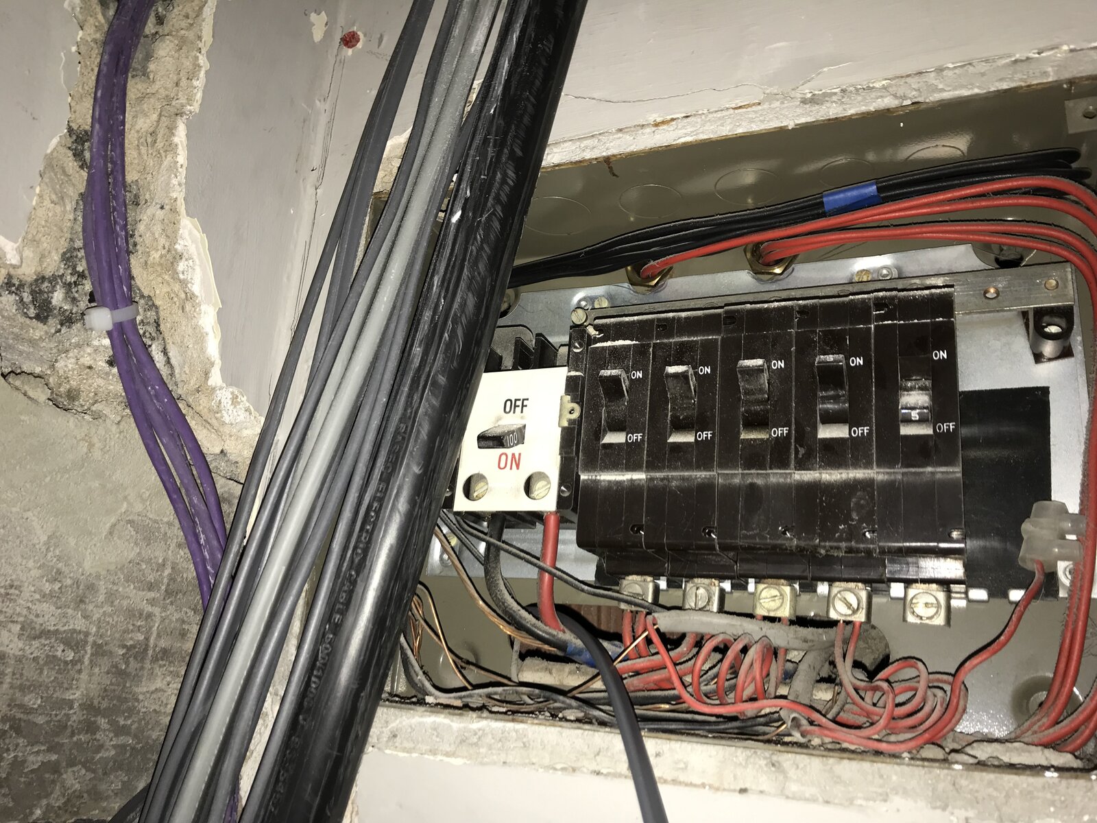

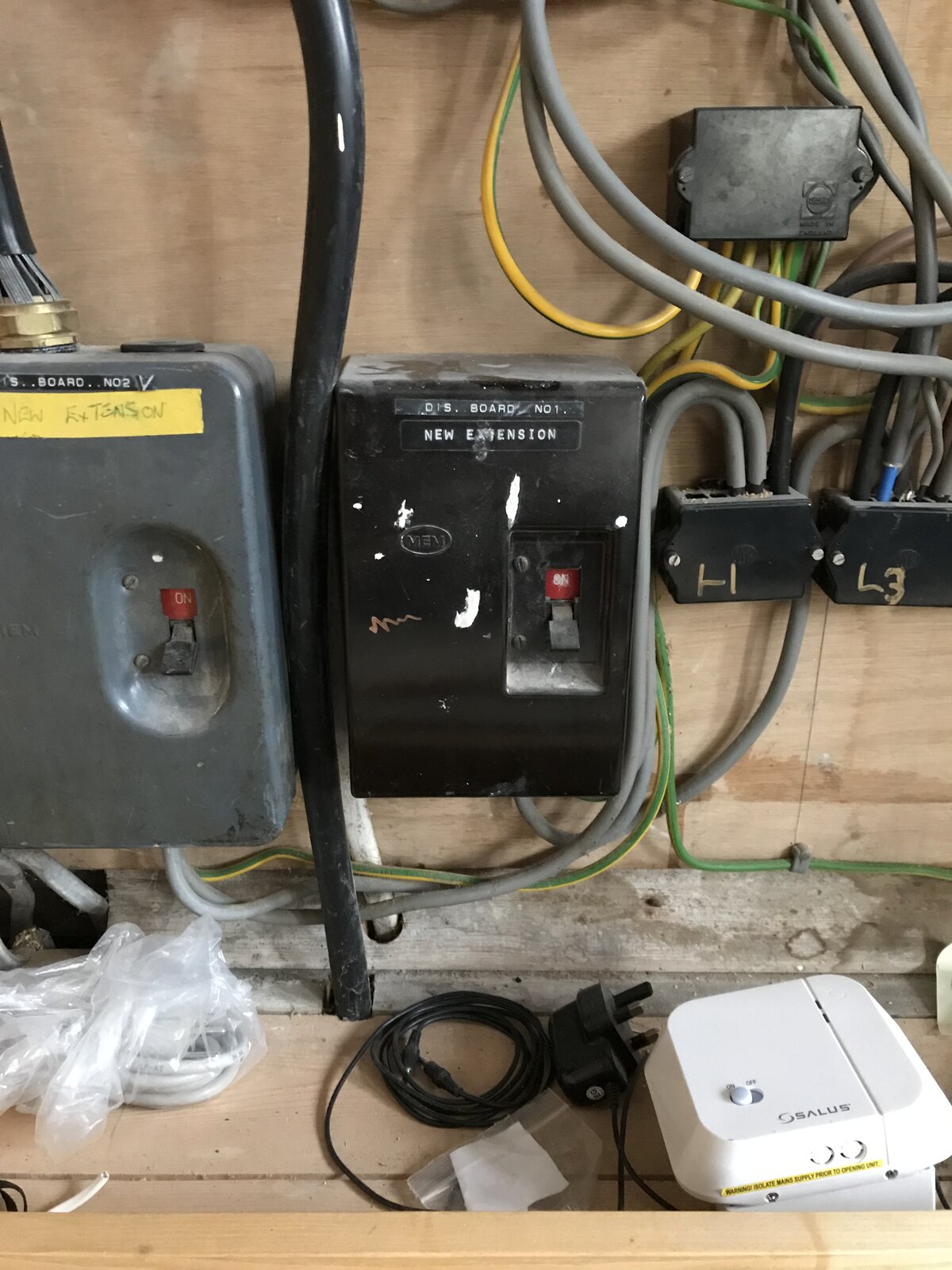

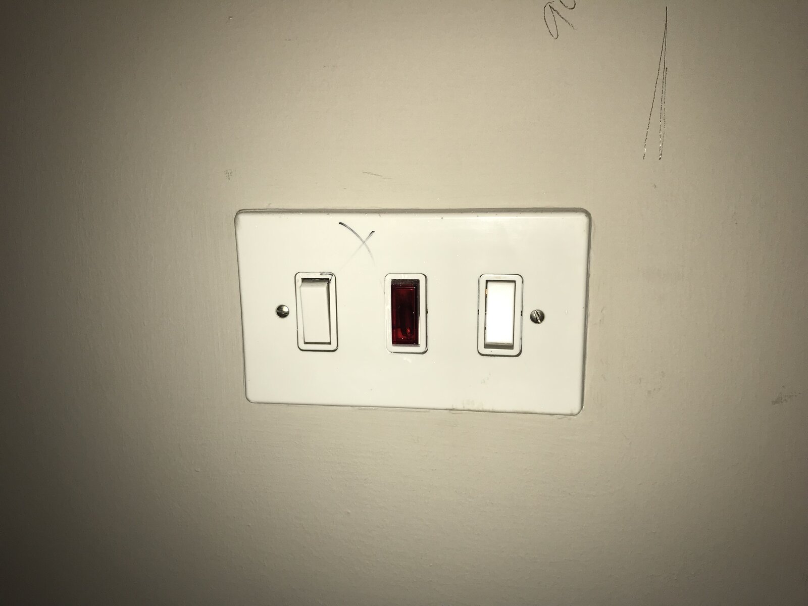

Few snaps from today. Maybe this will help!
No sleeving on the CPCs. If it was only the badly installed probably later T+Es I'd just put it down to bad workmanship, but the incoming 16mm2 T+E is unsleeved too. Is this an indicator of age - is it actually 7/.064 from the era before sleeving the CPC was commonplace?
Which in turn raises a question I don't know the answer to - when was the C50 range introduced? I know they were around in 1969 because that's when my great uncle, also an electrician, rewired my grandparents' house and installed a C50 board, thermoplastic with a wooden frame - revolutionary in a domestic house for the time!
Grey tails and green and yellow earthing or bonding conductors seem more recent than the C50 board. These could be later additions.
C50 was all the range around 1970, but not sure how long it was available.
Crabtree accessories around 1970-1985 ish.
What size earth wire in the 2.5mm2 T+E?
Are the reds in seperate metal conduits to the blacks? (Eddy currents and all that rubbish.)
