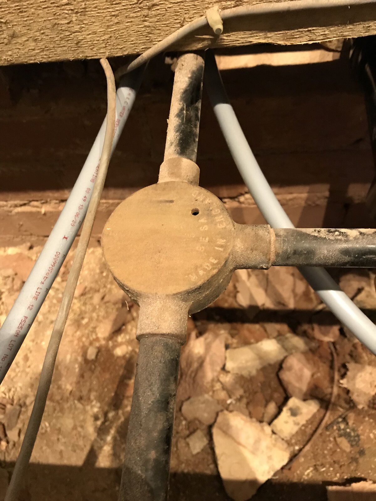

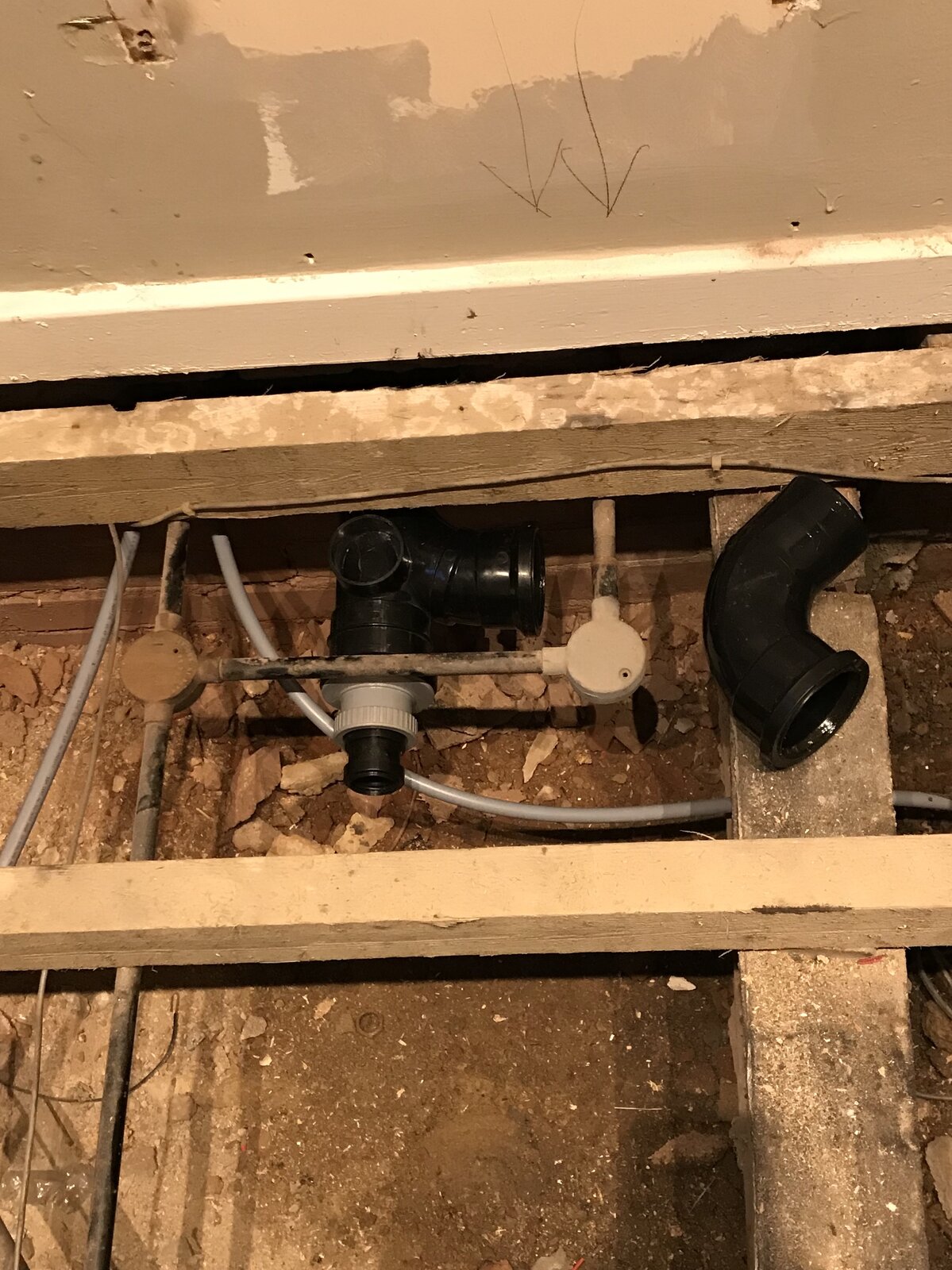

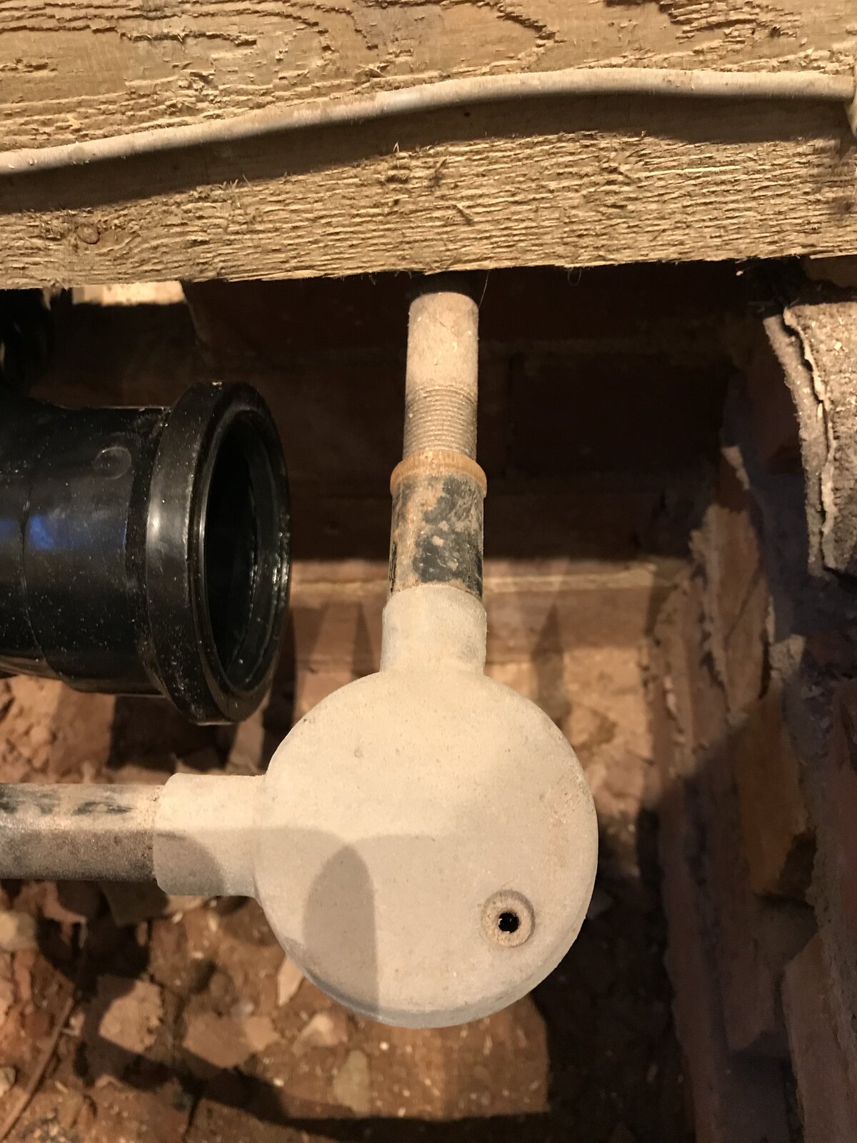

So today we got some of the floor up and exposed some of the conduit which needs to be removed as it is where the soil pipe will be positioned for a new toilet.
I haven’t proved it yet, but the conduit appears to be imperial judging by the hole on the back of the BESA boxes which look like 2BA, and to my eye the running coupler isn’t M20.
Didn't they change to m4 screws before metric conduit?
Anyway hadn't we already established the bushes at the CU are imperial?
Hang on a minute, did they have round lock rings on imperial tube? I only seem to remember hex or octagonal nuts.
