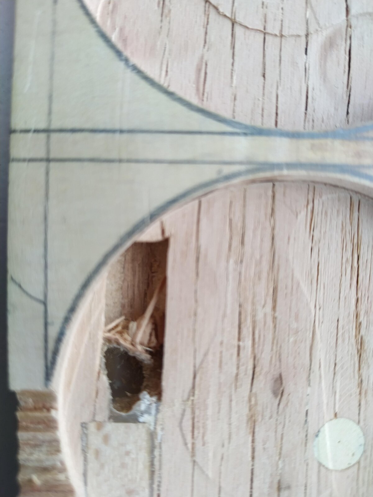

Hello there, I am after about 500ml of self levelling liquid epoxy to fill some voids uncovered in some plywood after using a plunge router.
Can someone please recommend a specific brand/product that will harden well and evenly and can be sanded well and isn't stupidly expensive?
If it isn't available in small quantities but is still fairly good value, I will order more.
Thanks.

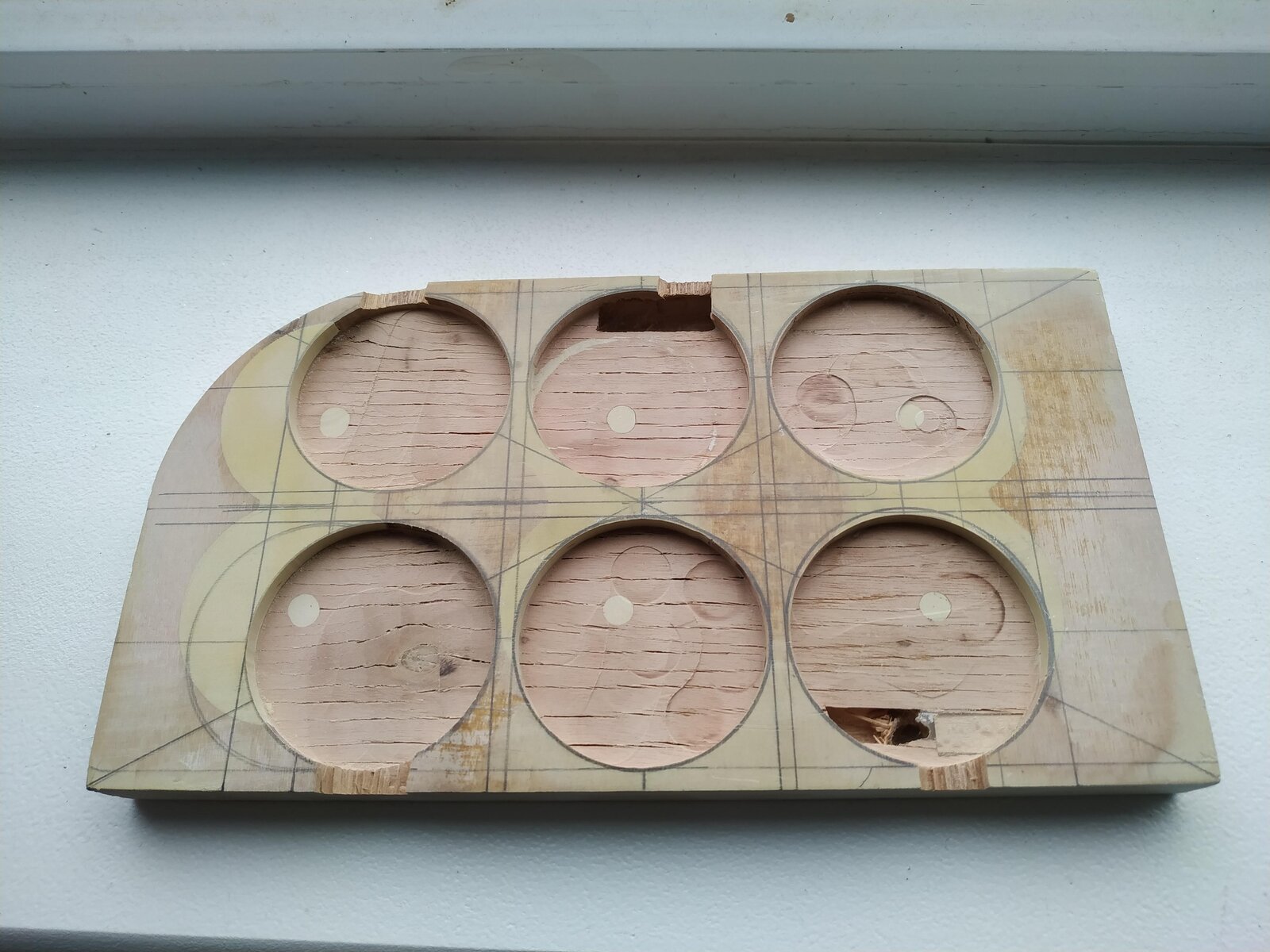

I guess you won't know unless I show you.
There are voids, gaps and uneven spots that would be great for filling with something that dries hard and level and will get into all the gaps. I also want to use tape to reproduce the bits that have come away when the plunge router went near the edge by infilling those gaps.
If you need a liquid it will have to be an epoxy system - which points to West, again. However if you slightly overfill the holes with a 2-pack wood filler it is possible to re-route the surface to get a flush surface. I have needed to do just that from time to time
Thanks for your reply. You may be able to see that I have already used a two part filler on this (the yellow areas). I swear by the Ronseal deep fill and have loads of it, but I just don't feel it's going to completely do the job in this instance.
Partly from memory you need something like the basic #105 resin / #205 hardener pack (they did some smaller "starter" packs which used to be £25 or so a few years back) but in your case I think you may well need the colloidal silica filler #406 as well, at between between about 40:1 and 10:1 mixed resin:filler ratio (the filler was about £8?). Using a filler gives improved load capacity and screw pull-out resistance as well as making a structural strength repair with good smoothness. You also use that filler when laminating making fillets and fairing-in (i.e where smooth sanded contoured surfaces are required). West also make low density and micro fibre fillers. In addition to the resin, hardener and filler you'll need measuring cups and disposable mixing sticks (these don't need to be West, where you are just oaying for their name on the cup - your local car paint supplier should be able to supply these really cheaply). One plus point of West is that once cured it can be routed, but you do seem to get a better surface with the filler

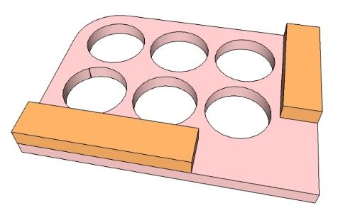

Firstly as you are doing multiple shelves I'd have made up a single template to do all the holes and the outside edge. This might well have meant making up an initial hole templete to make the production template. Secondly I'd probably have cut my shelf blanks a couple of millimetres larger all round than the finished item and trimmed to the outside in a couple of passes after I'd done the six recesses. That way your shelves are all consistent (not always achieveable if you are moving a template six times), it means you don't have to be super accurate with the shelf blanks so long as they are 2mm bigger that the jig and cut dead square, Routing it out in one shot and doing the rounder corner will be a darned sight easier. I would also whizz of the plastic sub-base and make-up my own larger sub base something like this:

Hot glue does set fast, but you only need a couple or maybe three very small of blobs of it, not a large amount, and that being the case if you have a template with a couple of locators on it it should be possible to get your glue blobbed and the template on before it sets off. This sort of template would work for what I am talking about:

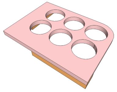

Above: The jig used to produce the display shelf. The pink represents some form of sheet material, the brown is 2 x 1in (44 x 22mm) PAR softwood. The jig is made 44mm oversize in both ways to accommodate the 2 x 1 locating blocks which are used to locate the jig on the blank. This is assuming that the blanks are 25mm - the main thing is that the locating blocks are thinner than the material, so anything you have will do, Templates can also be assembled with hot melt glue. In a real world situation I'd possibly make up a jig with two holes in it then use that to make the six hole jig - this makes for a much more consistent end result

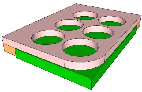

Below: The blank is cut slightly oversize and the template fixed on top. Material is shown in green. In reality I'd want to trim that corner back a bit with a jigsaw before routing to reduce the amount of work the router needs to do - because work = heat

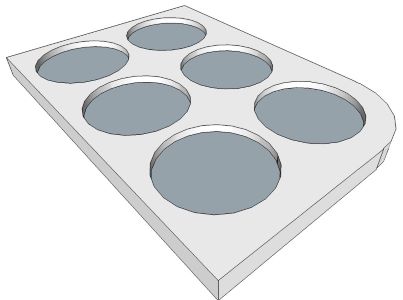

Above: What the completed item should look like. I know this isn't exactly the same as yours, but I was setting out to demonstrate the principle only
