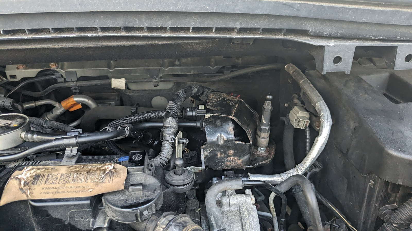

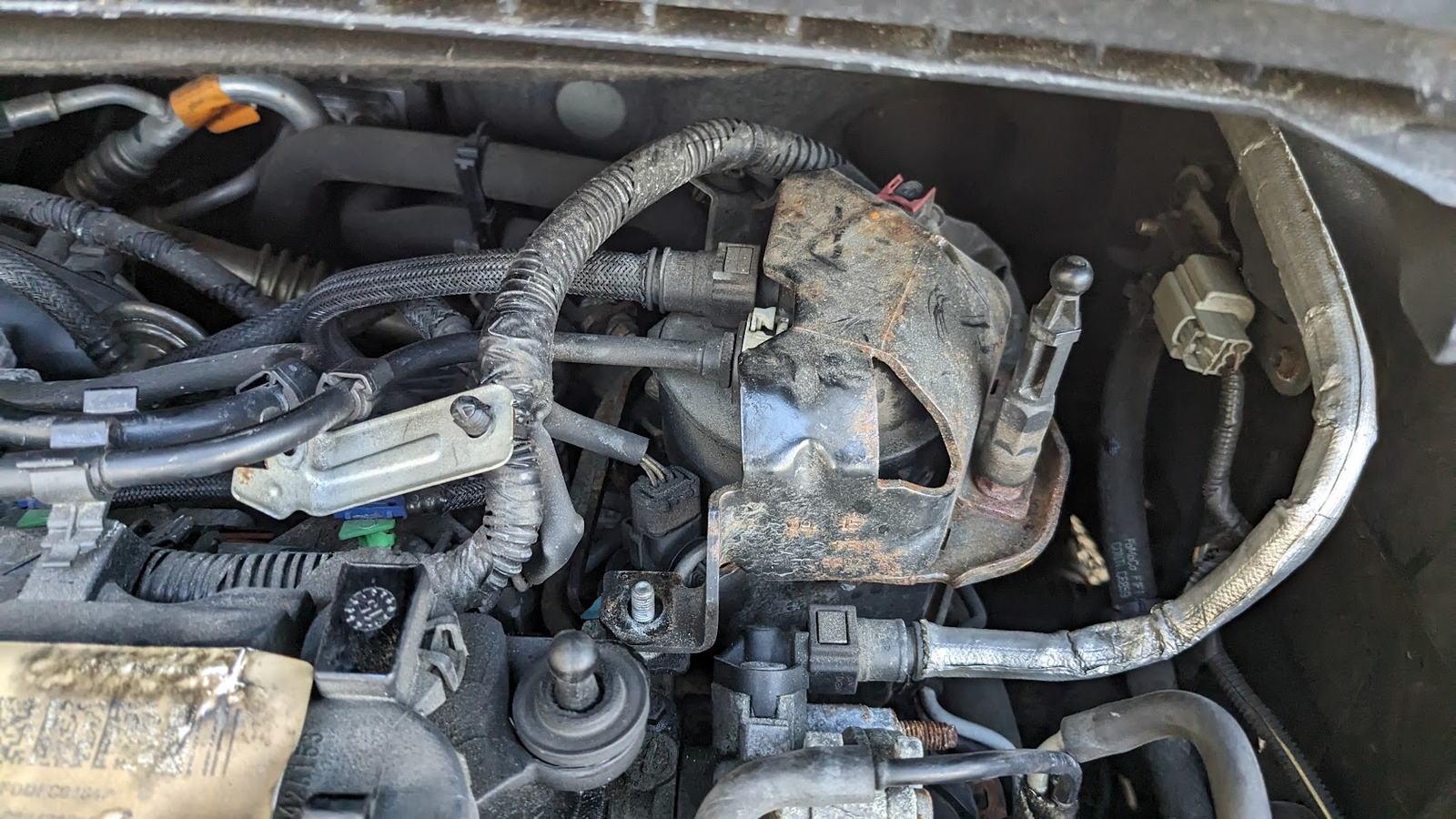

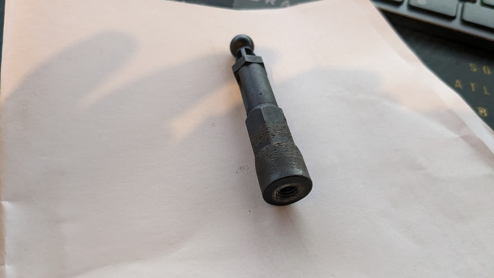

Whats this screw / bolt called? dropped it in the engine bay and need a replacement!
OK guys thanks, I'll try this , the following bolt going in from below the housing, so the thread appears at the top
then a nut on top to secure the bracket to the housing. So thread remains exposed
Then screw this thing on to the exposed thread (connects to the engine cover)
sounds like a plan.

Is this it?
If so, M6
If you click on the part number it lists other vehicles the part is used on.
Should be able to get one from a scrapyard/ebay breaking a suitable model.
That's exactly it. That's a great site btw.. thanks for sharing, bookmarked!
For now Ive gone with the DIY solution that others suggested. A M6 stud with two bolts. Here it is with the DIY fix
