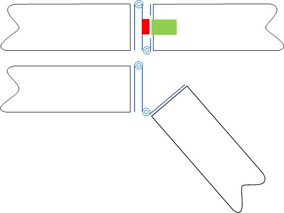

I think I can do what I want with two piano hinges, spot welded to make a Z which opens both ways.

the footrest additions would need to support perhaps 100kg without failing to be safe
you may be fine with less strength but i dont know
so please as you go make sure you put you full weight on the extension outer unsupported edge to make sure its safe
I want it to fail if I stand on it, but not in a damaging way.
EG:
Where red and green are super-magnets, red glued to the middle leaf, green fixed but jiggly in the wood. (only drawn once).
Each pair can hold a huge weight, like 20kg . (It can attract to the other hinge leaf - that's fine as long as it can't reach it it won't be strong (PVC tape will prevent if necessary). Or make a hole in it.)

you are misunderstanding the mechanics an up to mean perhaps half that so 10kg
you now have leverage and a fulcrum [pivot point]so your now 10kg holding force will now support perhaps 1kg
you now add on active load[bouncing about in motion] halving the the grip
if you dont understand what i am saying about leverage take a 2L bottle you could carry about with you all day the hold it at full arms length
Sure, there's a lever.
Are you assuming only one magnet pair, badly placed components, or supporting more than one child's foot, or something else?
I've used magnets before, hence the red ones and "wiggle" note which I didn't explain. They're ok.
I'd run the numbers already allowing a 4:1 fudge factor. I can make it support several times the weight I want it to with enough magnetry - there's plenty of room/options.
If she kept "snapping" the flap, she'd learn not to press so hard. It would be on a spring of some sort so it would snap back up.
That was a 2 minute sketch not a finished design!

just keep in mind 2 magnets face to face 100% grip
2 magnets touching one edge but a lmm gap the other perhaps 50% loss off pull
1mm gap all round perhaps 70% loss off pull
if you use wood or any material that expands or contracts without adjustment to the magnets they will go out off adjustment
Yes, I know, been there, hence "wiggle". If you let them align....
That's why cupboard catches usually have movable elements.
1mm gap is a lot more than 50% loss of holding force. 1mm sideways slide on a 3/4" magnet isn't so critical. The lines of flux curve.
