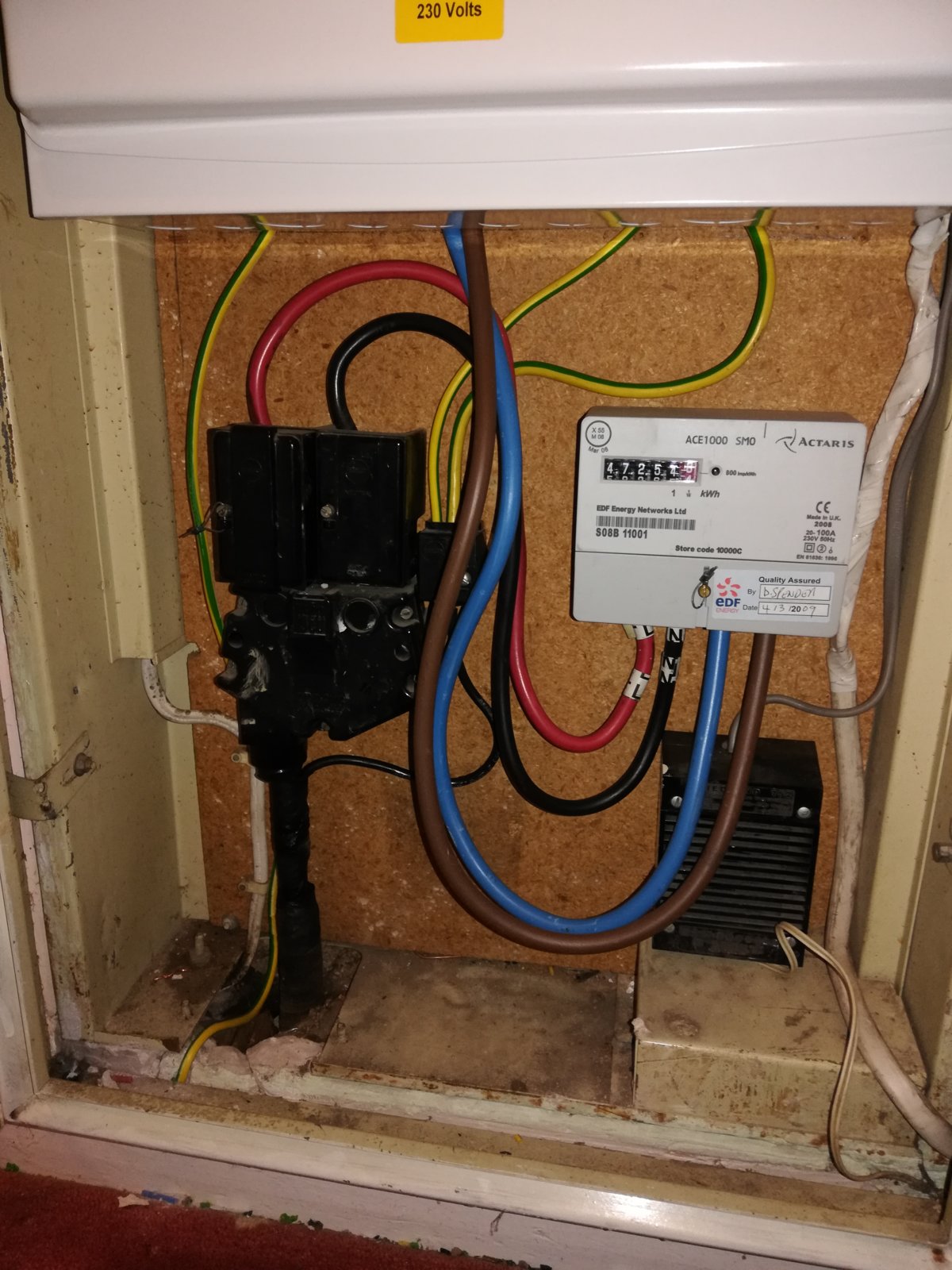

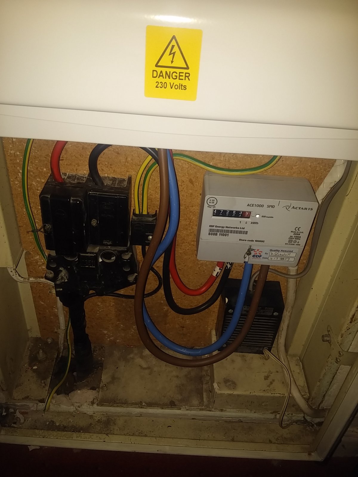

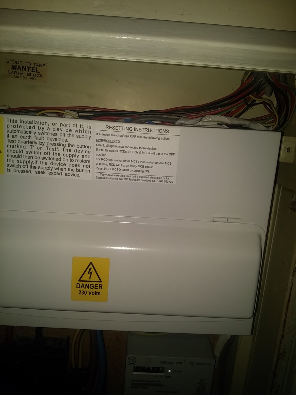

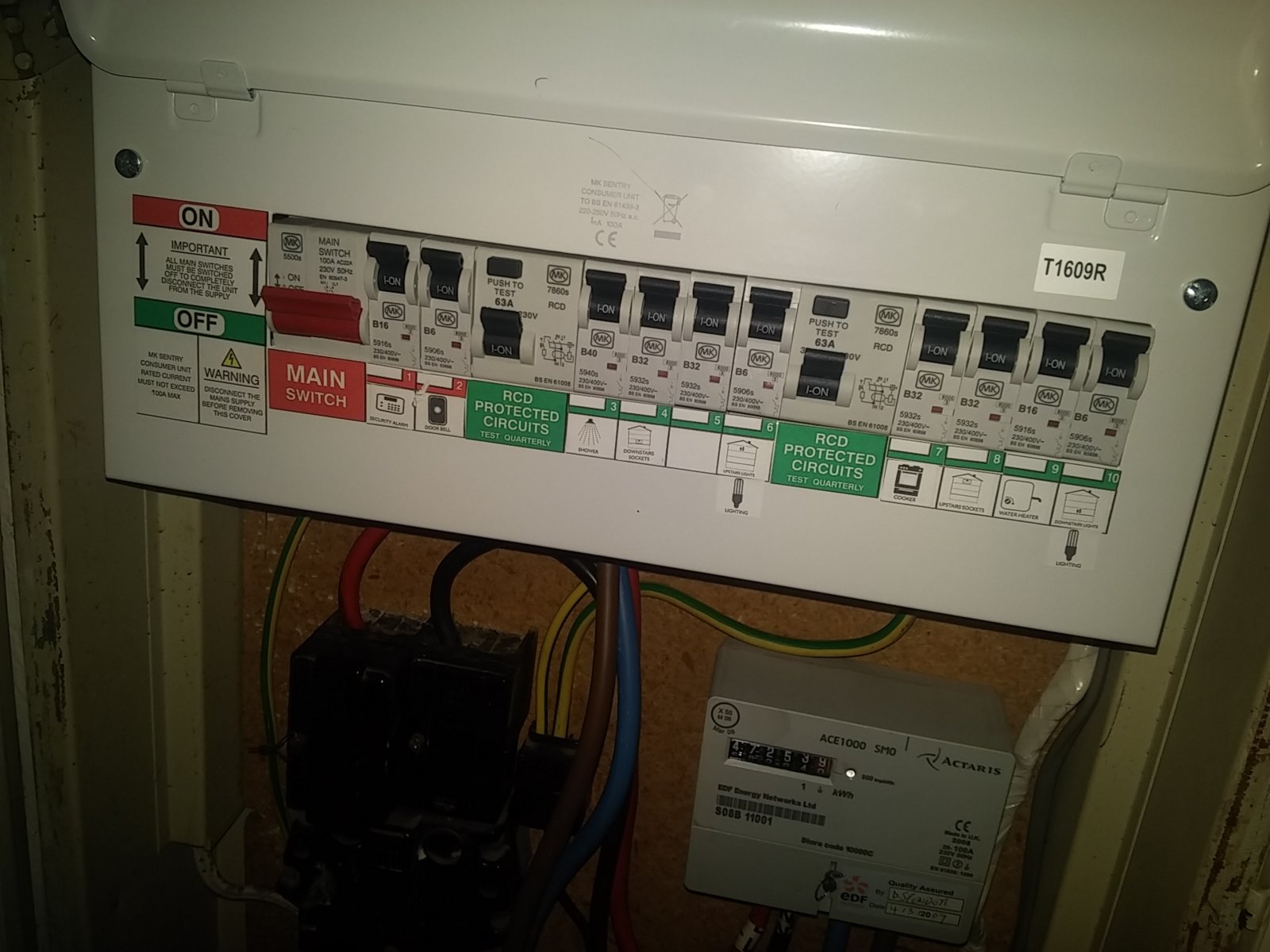

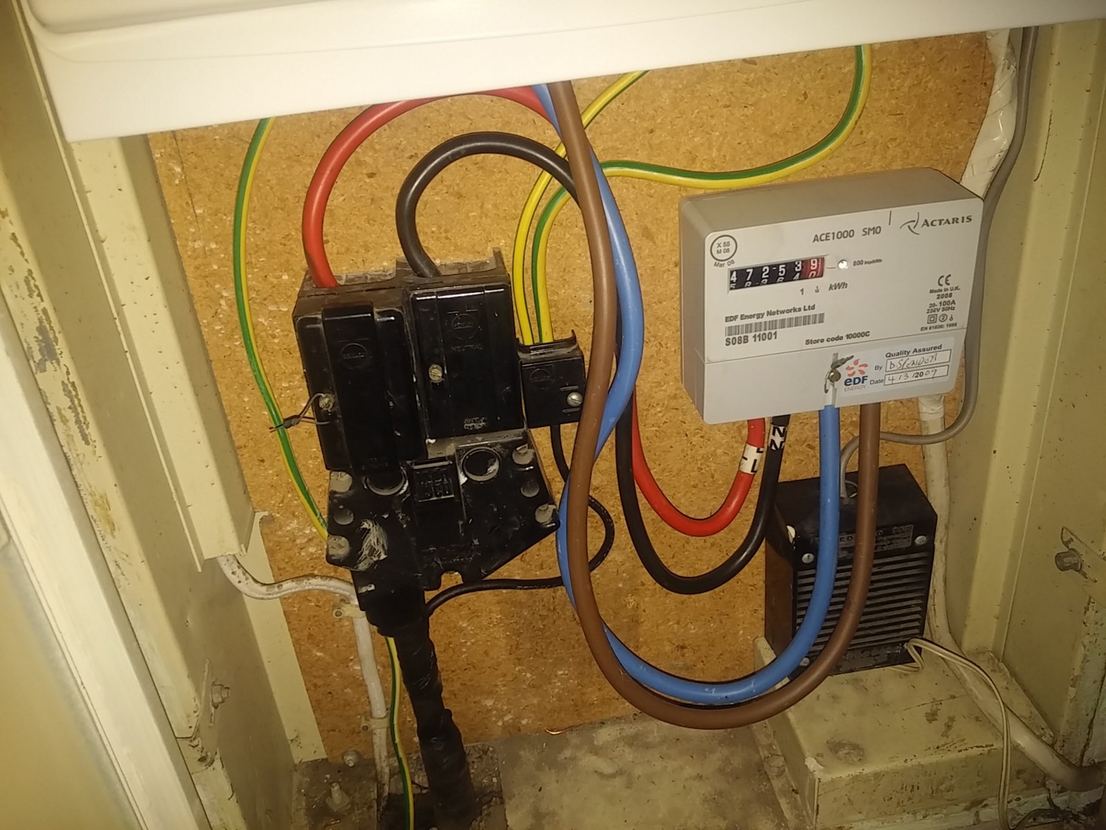

Hi Guys, I have uploaded some pics of the consumer unit. It is metal

The cables that I can see ( on top of the consumer unit) appear to be fairly modern PVC.
BUT

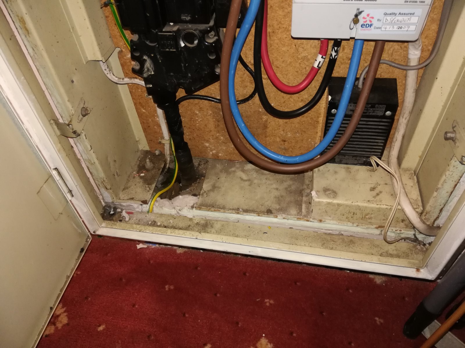

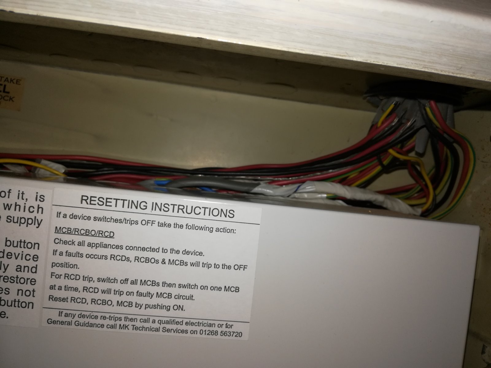

those cables on the top should not be exposed like that. They need attention.
The consumer unit is very recent. There should be an installation certificate that was issued when it was changed. Did you get a copy.

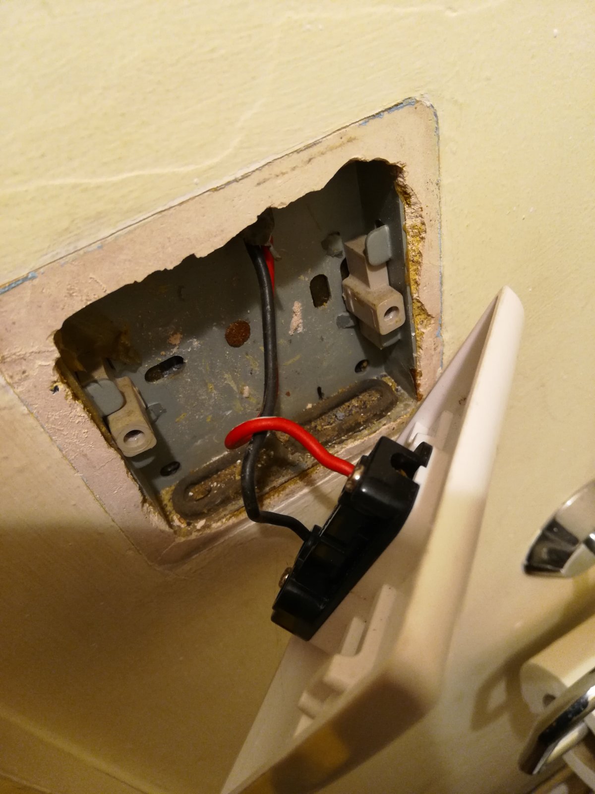

Edit, as above need pics of wiring behind a socket, a switch and a ceiling rose.

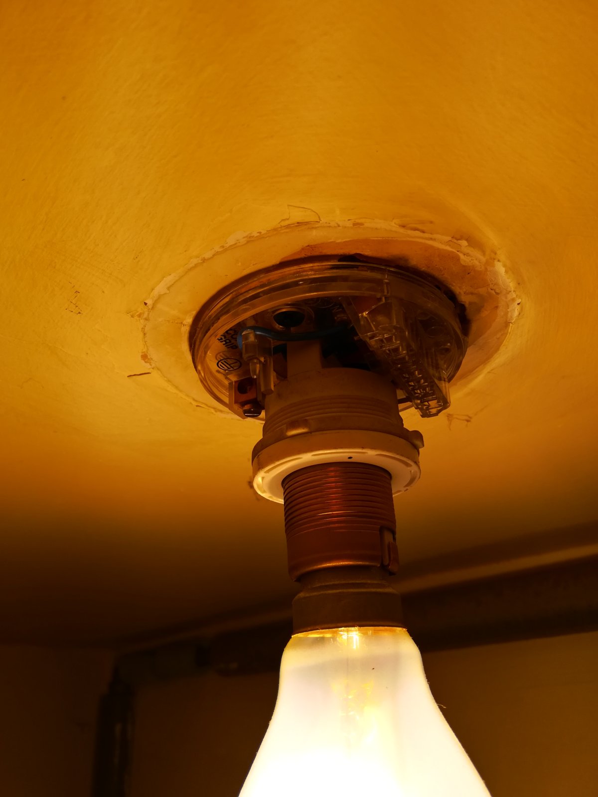

Will grab a pics of the requested ASAP :D
That is the remains of a Mantel unit which some buffoon has shoehorned an inappropriate modern consumer unit into, leaving single insulated conductors exposed. Unclear what all that white tape is on the wires, but it shouldn't be there either.
Wiring is probably original to the construction, and although it may still be serviceable and could probably be patched up and used for a few more years, the reality is that the installation is at the end of it's useful life.
one of the conditions of sale was that nothing is guaranteed and documentation will not be provided
In that case, assume everything is dangerous and needs to be replaced.
Hopefully the purchase price was extremely low.

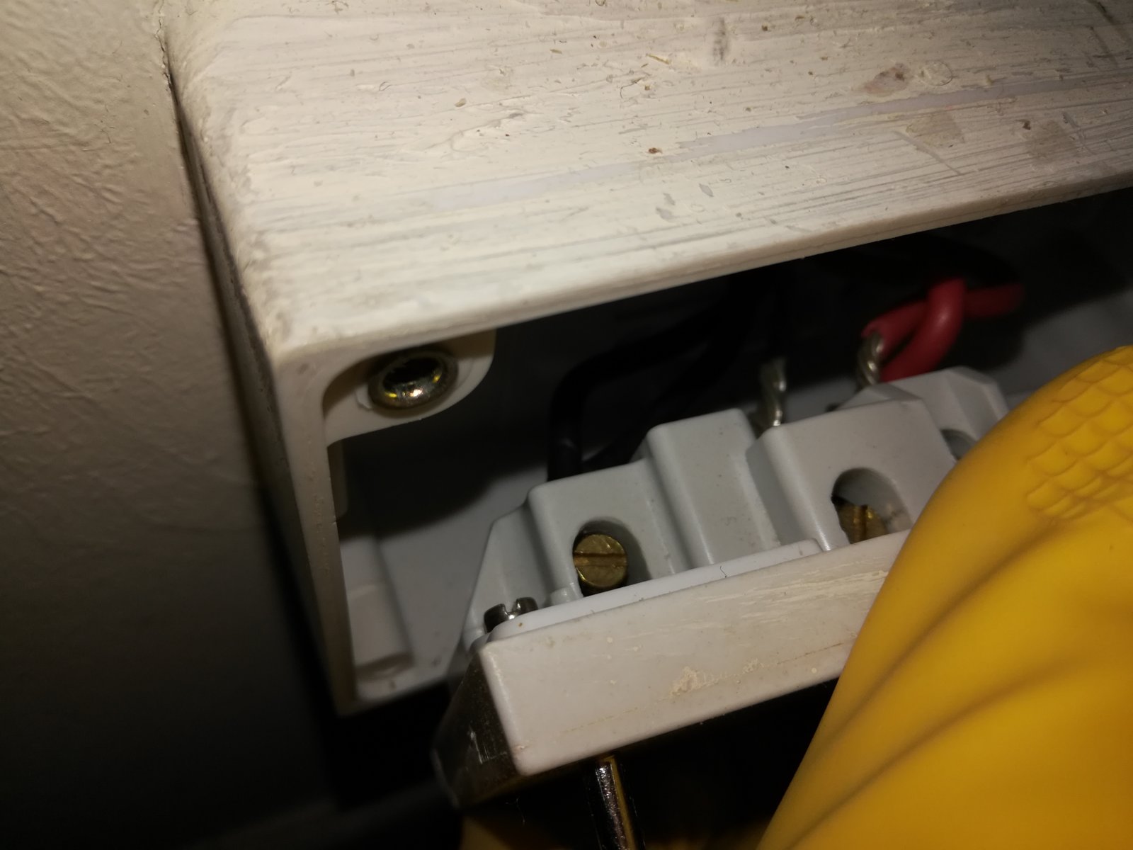

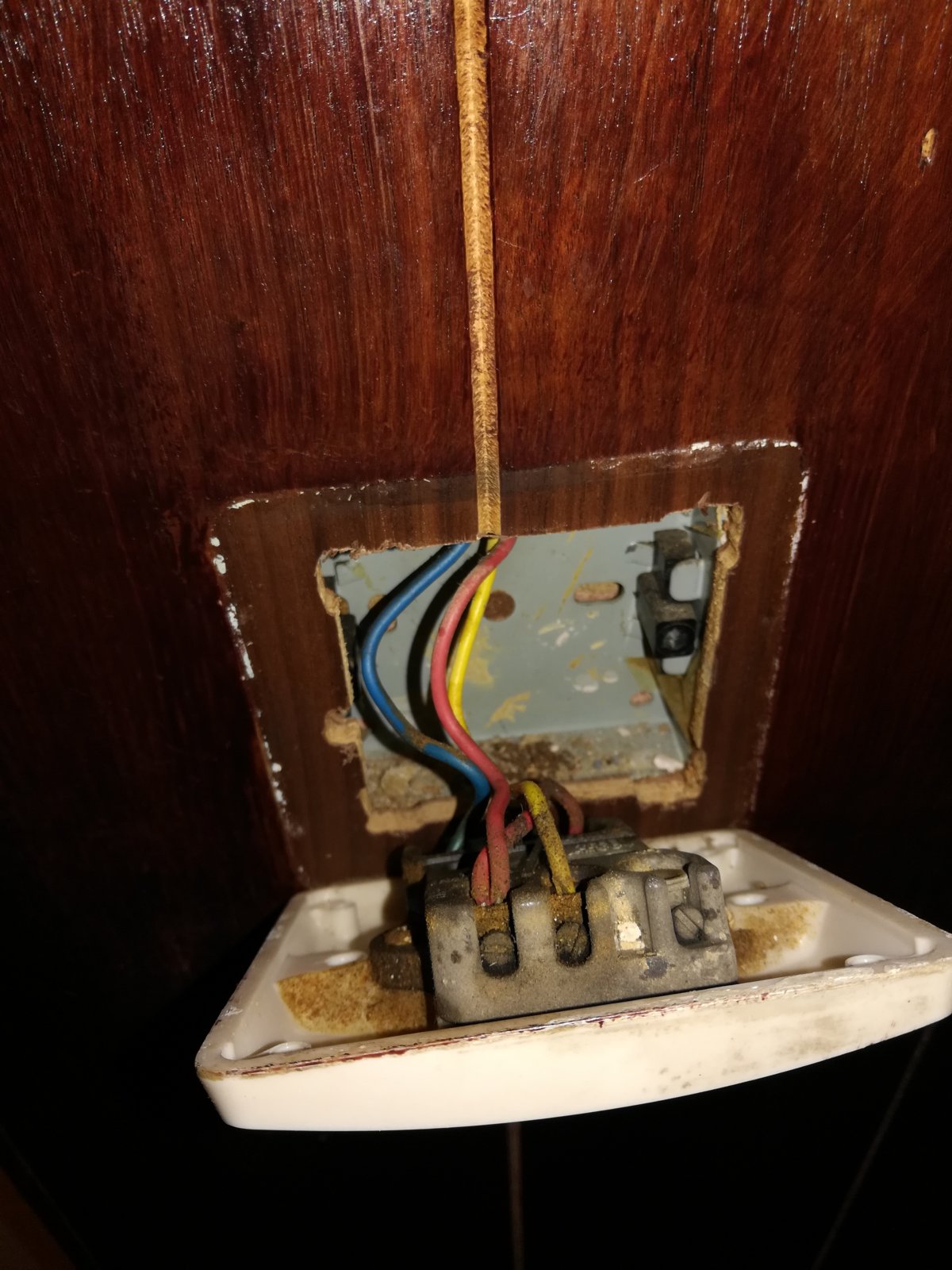

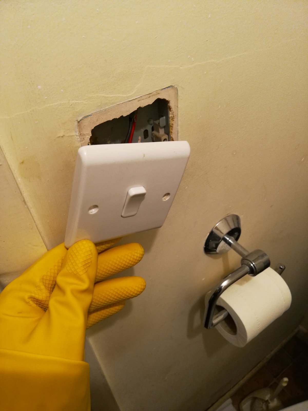

I've attached just what the Doctor ordered :D:D
Well not really, as admittedly some of the pics aren't great.. But I did the best that I could
@ericmark your comment was very helpful.. Thanks
