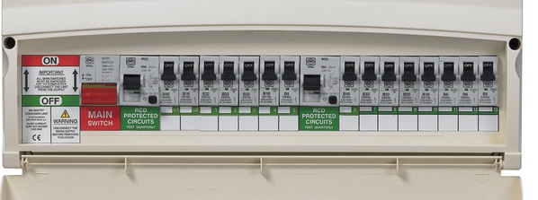

I have something like this (fuses)
and one signed RCD is going off
picture from google

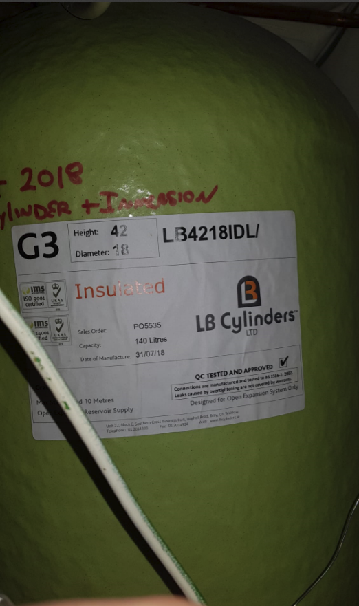

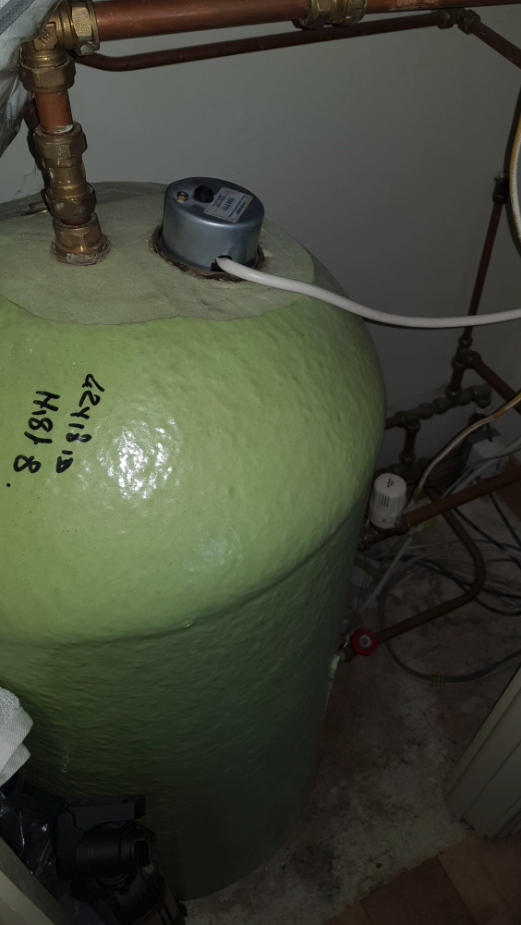

What colour is your cylinder? I do not think it is a boiler.
Some photos of the cylinder and the immersion heater head, will give an idea of age. An older one is harder to get out.
View attachment 304649 picture from google
Ok, they’re not fuses, but miniature circuit breakers (mcb’s). Definitely the rcd that trips? As per John, can you post photos of the actual “electric boiler” and what exactly you’re saying is switching to the bath?
Could be moisture/water ingress as per John, could be wiring fault.
