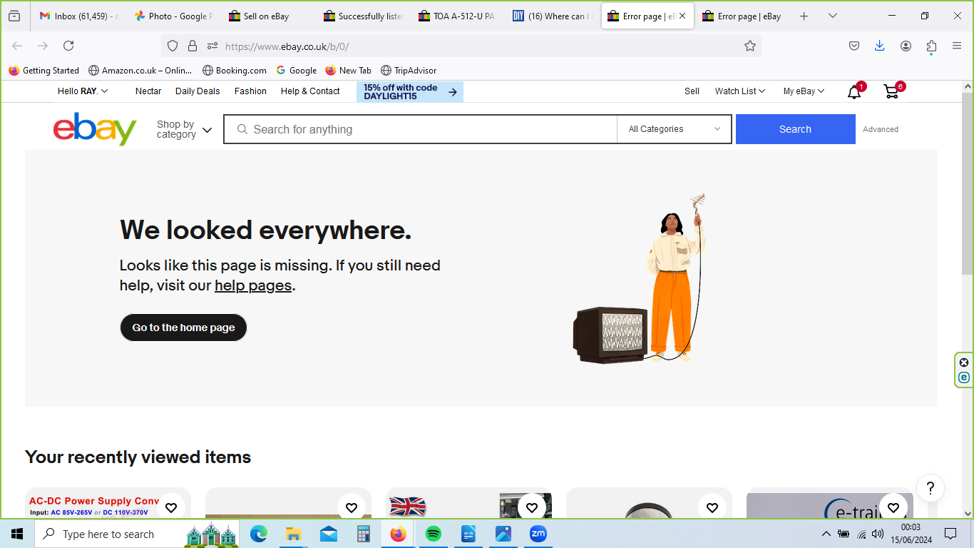

I just did the same, and get this page which is not 'missing' ...
Are you sure John?
Are you sure John?
Dead sure when I did it (and still when I do it now) - but it appears that DIYnot is playing with the links and making them unusable from forum posts. One of these may get around that (cop/paste URL into your browser for 'Code' version)....
