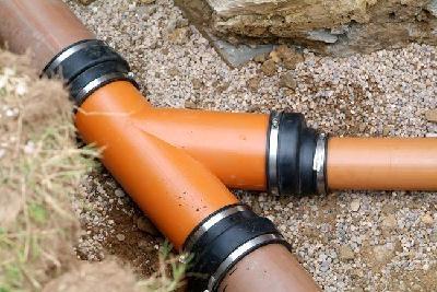

Where can i get a 160mm oblique wye junction with no sockets
Can you use a clayware junction? I don't think you'll find a plastic version without at least 2 sockets, however the clay 'sleve' type will have 3 x spigots, all joints are made using collars.

Excellent thank you, i guess clay will be fine. I have no idea why there so hard to find, thought everyone would sell them. Thanks again!
Most Builders merchants should stock clay drainage, you are unlikely to find it in the sheds. It is quite fragile, do not drop! :LOL:
