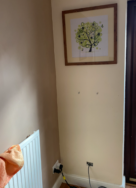

I'm installing an outdoor socket for our hot tub. I've gone through the wall and installed an IP66 rated enclosure, and had indented to spur off an existing socket in the living room. I drilled at the centre height of that socket on the adjacent wall to make sure the cable run will be in the safety zone, however, I failed to take in to account that the safety zones don't extend beyond the corner.
I had planned to install an two-pole isolator switch to make sure I can remove the outdoor socket from the ring if I want to, and I had planned to install that next to the plug.
Two questions. 1) Is there a best practice for the height of an isolator switch? Should it be high on the wall, or can it be at socket level? 2) If I place it on the exterior wall (at either hight) is this sufficient to create a safety zone for the cable entry once the wall is closed up?

Why don't you put the switch where the cable comes in to create a 'safe' zone?
No. Up to you.
No.

Thanks for responding.
It's a plug-in inflatable hot tub, rather than a permanent thing. A glorified paddling pool that is defined as class II. It does have a separate "optional" earthing point on the bottom of the pump box, which I have connected to the outside tap.

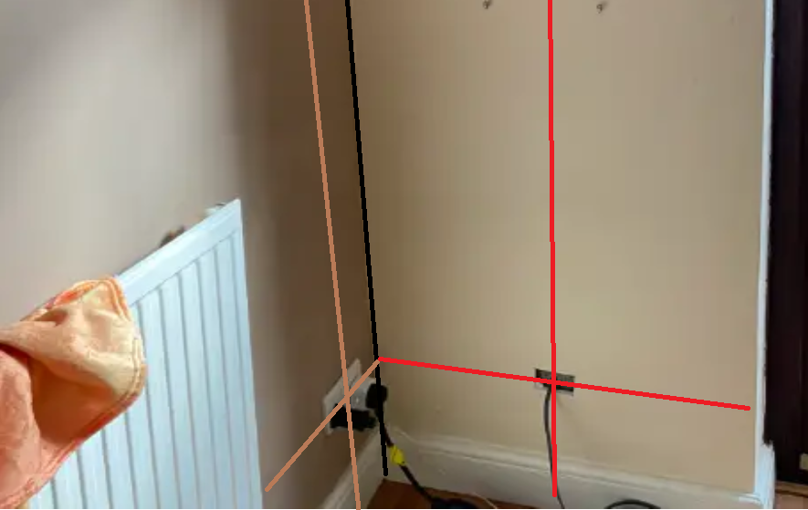

What you currently have is 3 safety zones:
The black is 150mm each way from the corner
Brown created by the socket
Red created by the accessory, any accessory, at that point.
