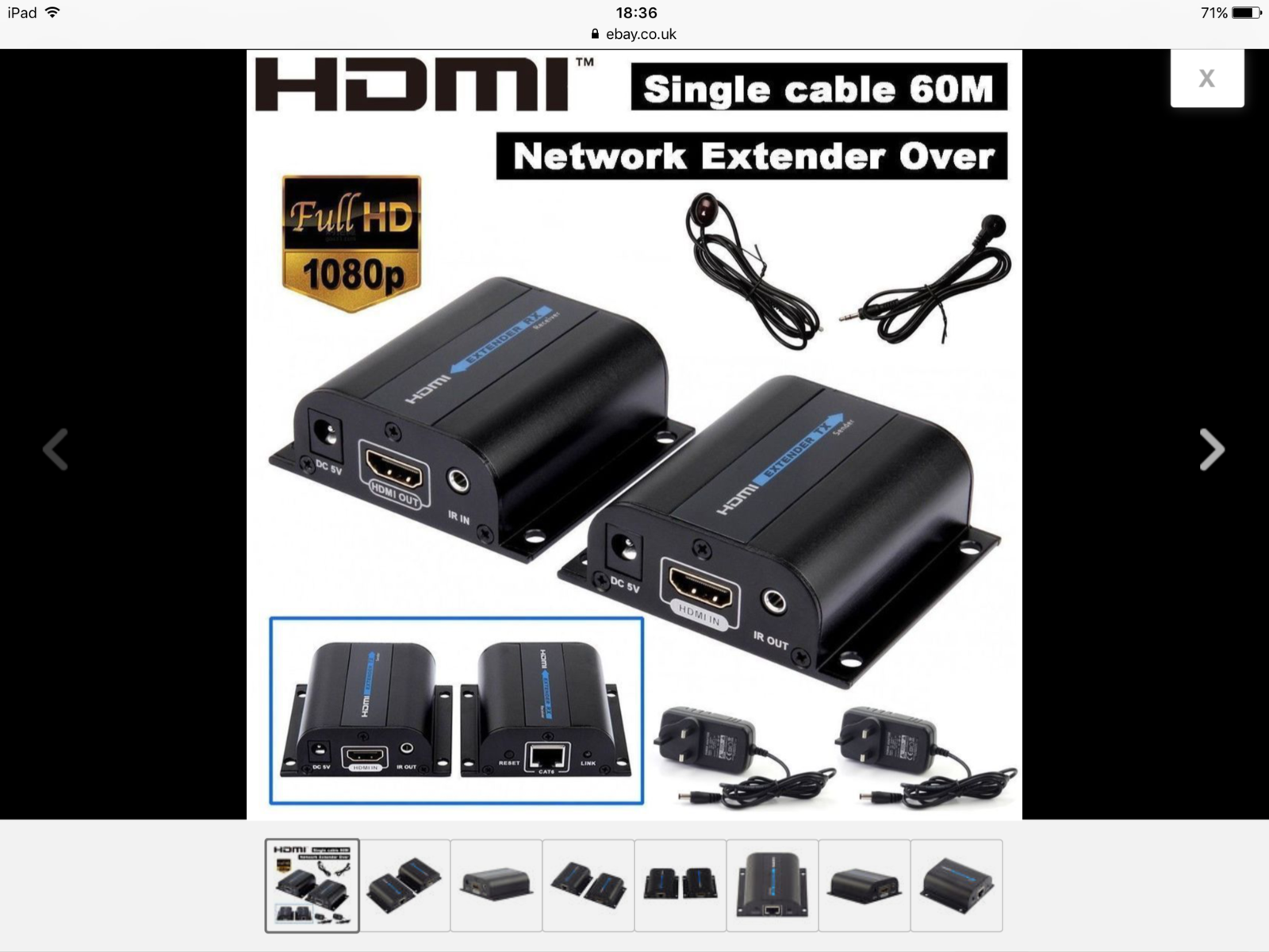

Any chance of a link or a how to for these cables as I will need 3 the extra being for internet which I already know how to do, but am lost at the moment on this ?
Run cat 5/6 put the hdmi /USB adaptors at each end ...or run hdmi lead and USB if within 15m
Thanks I am well under 10m but don’t know if I can fish a hdmi cable down inside the stud wall beside the phone & aerial cable so was looking at alternatives, I should say this is for my mothers house and I definitely can’t touch the walls, so wondered about the adaptors
Example some require 1 cat 5 some require 2 ( found the 2nd one normally carries the audio)

Many thanks for 5he replies will hopefully get to her this week and see if I can fish the hdmi down through the stud or go the Ethernet route
