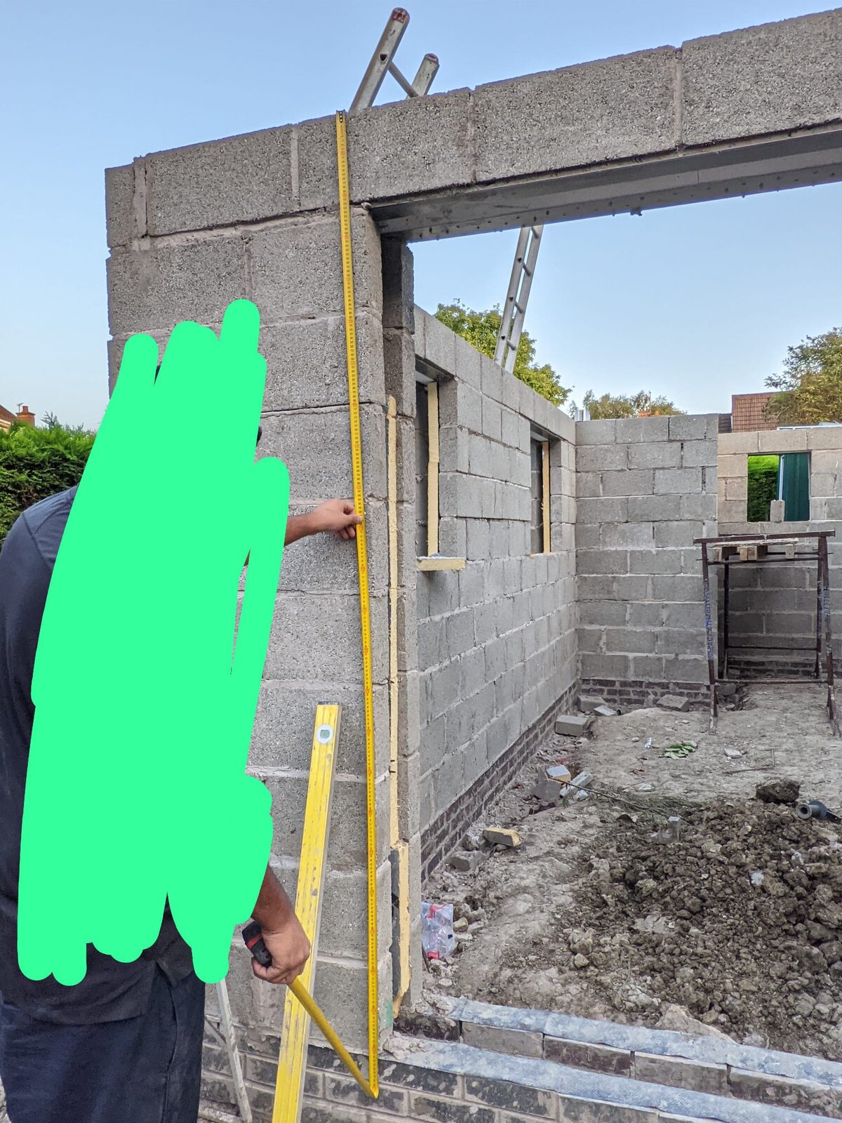

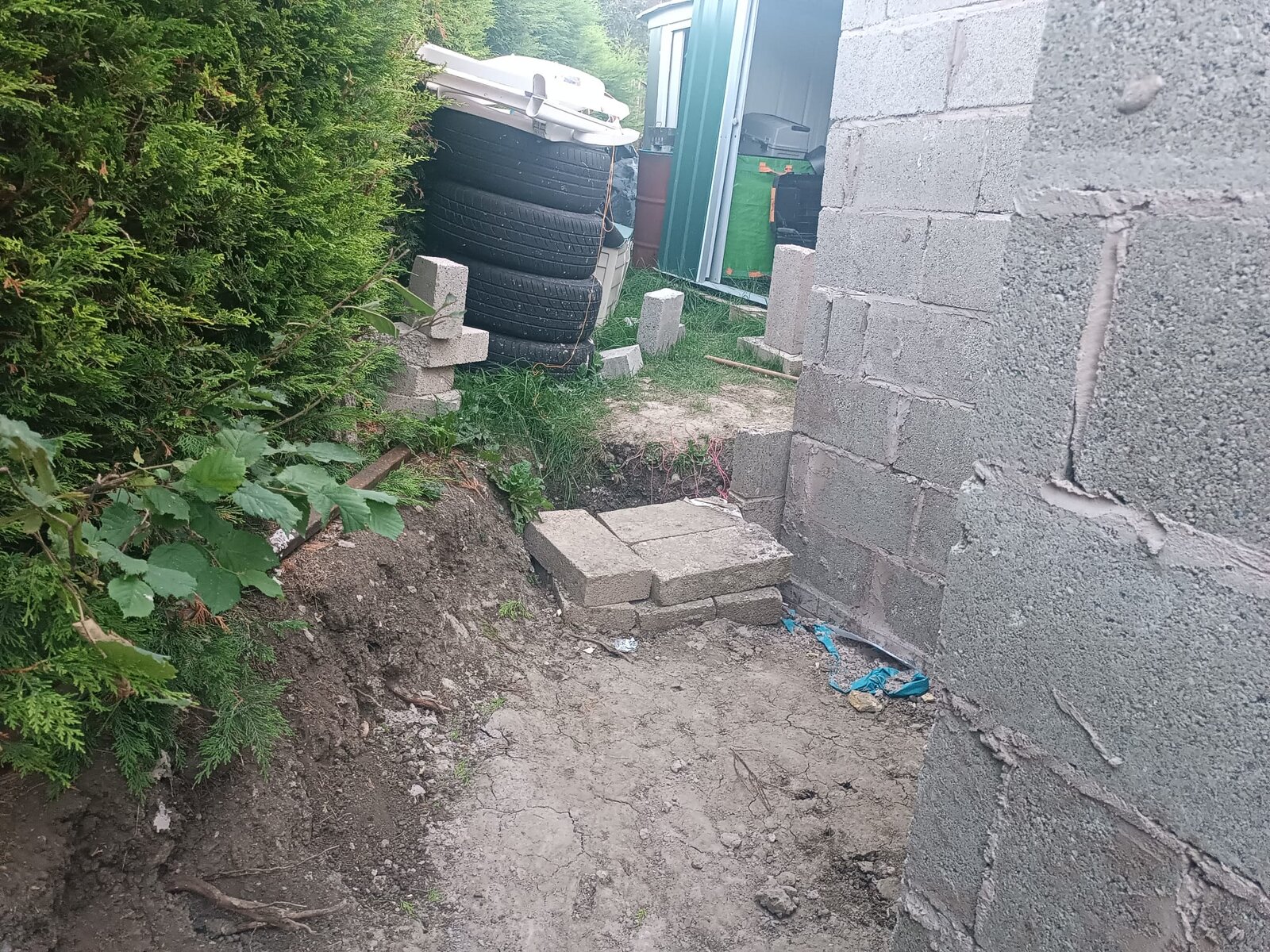

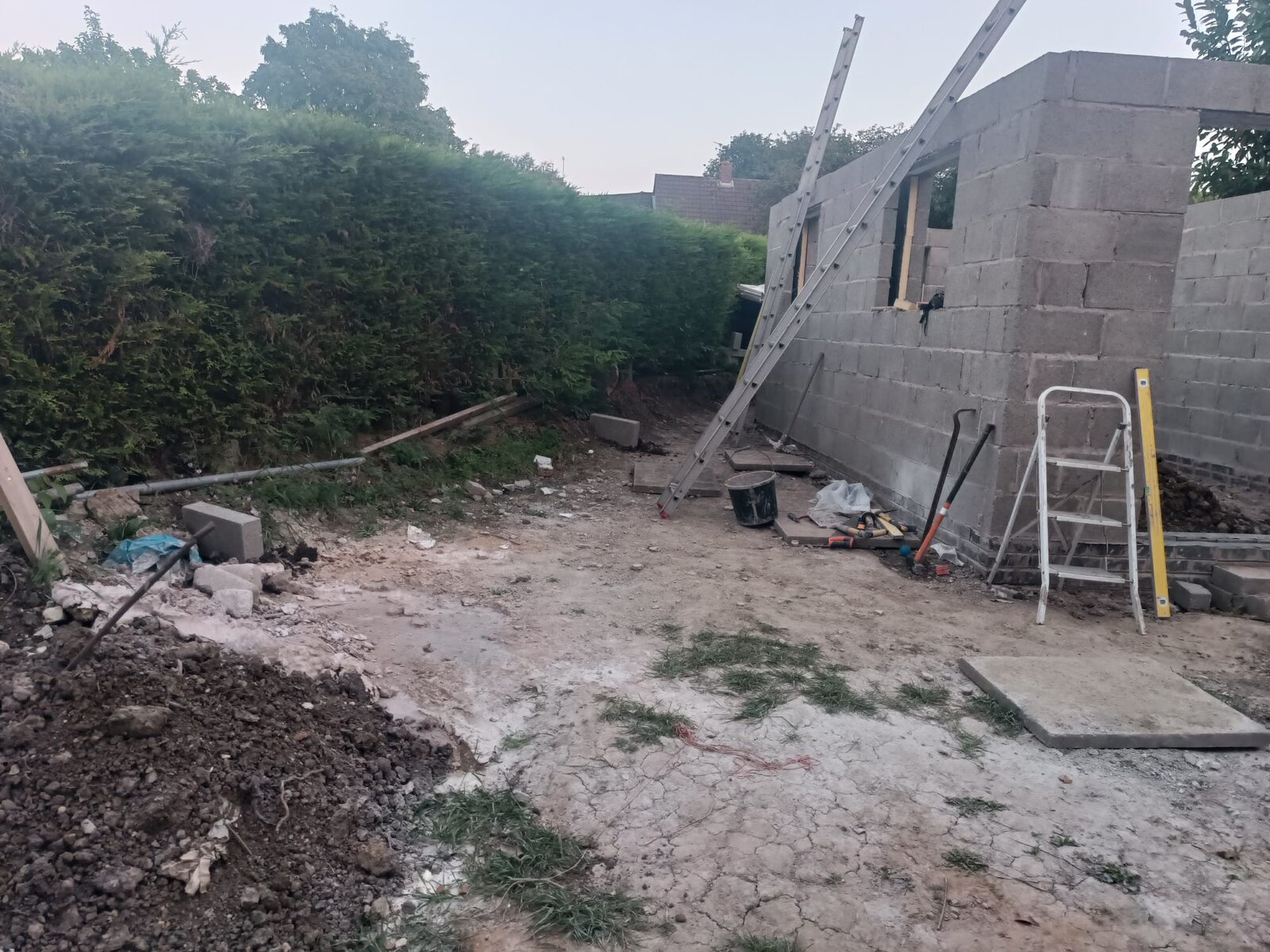

Hi all,
Really needed some advice before I carry on with outbuilding.
I am building an outhouse roughly 20sqm with a height of 2.5m as it is within neighbors boundary.

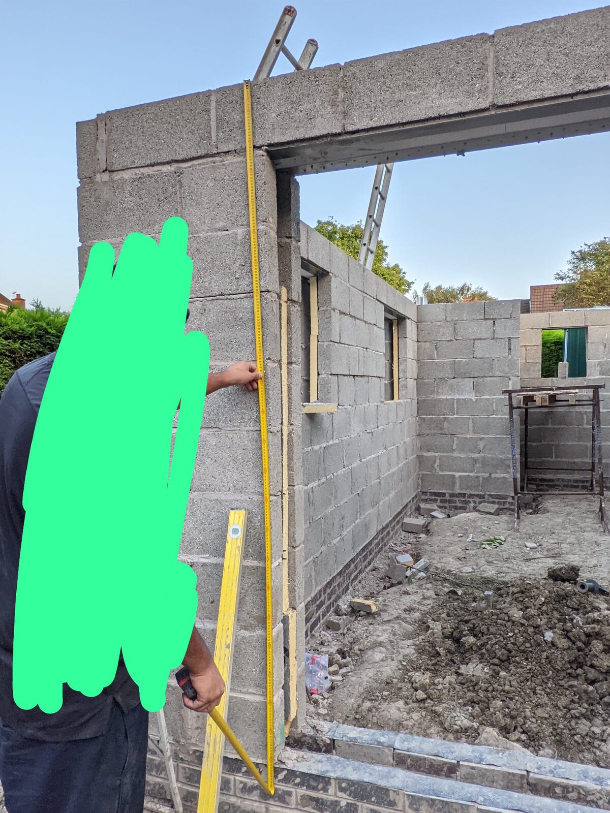

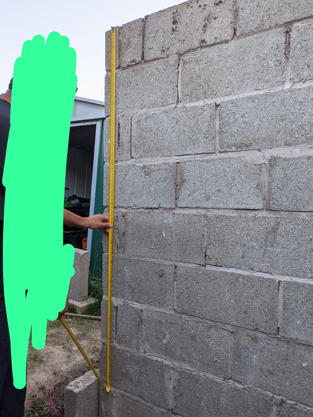

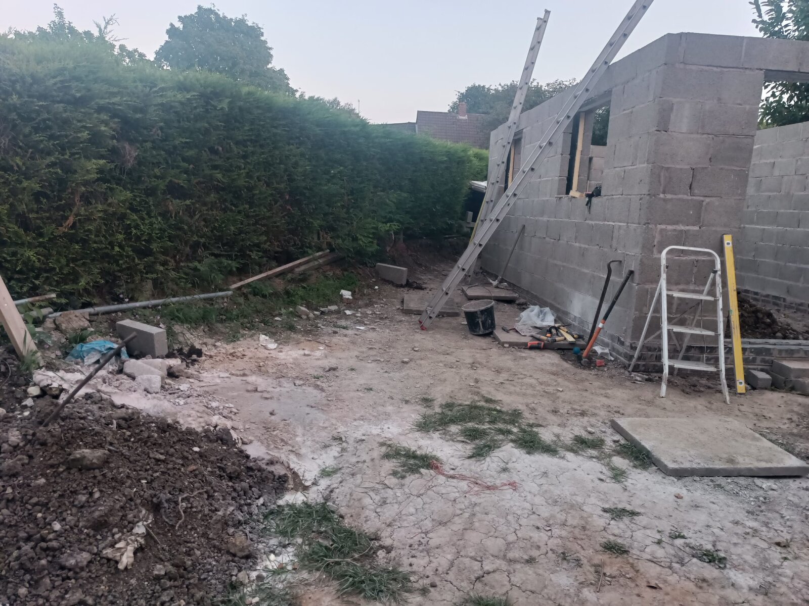

I have a sloped garden. From the front of the building it currently measures 2.6m before the roofing is installed.
From the back of the building it measures 1.9M before roofing.
My main concern is from the front, I have gone past the permitted height, but not from the back.
Only advice I could find is the following from the Leicester City Council website "the height of the building should be measured from the highest ground level immediately adjacent to the building at the highest point"
I have attached pics to give a clear picture. Roofing is due to go on this weekend. Really don't want to start unless I know I won't have to pull it all down again.
Not on the greatest of terms with neighbor so I am definitely expecting a planning officer to show up.
The 1st pic is from the front.
2nd pic from the back.
3rd pic is the side
4th pic is of the back.

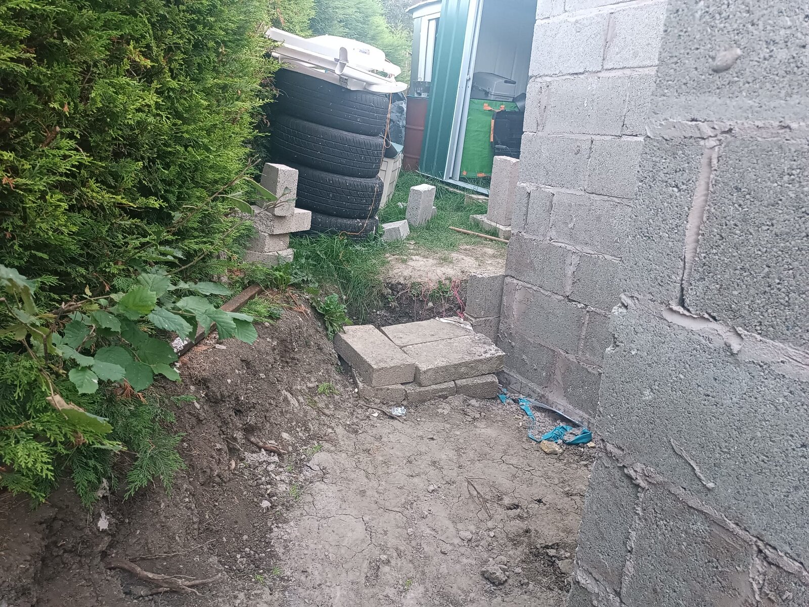

I did dig out quite a lot of the garden to try make the ground flat to build on. You can see in the 3rd pic where the ground level is
Could anyone please advise on where I currently stand?

"Only advice I could find is the following from the Leicester City Council website "the height of the building should be measured from the highest ground level immediately adjacent to the building at the highest point"
So is the highest point of land at the front or the back of your building? If it is at the back of the building, then you may have a chance of 'interpretating' the rules to mean that, so long as the front of your building is less than 2.5m higher than the high level at the back, you are within the rules.
Bit of a longshot but it may work.
didn’t mean to post twice. You’re ok, as long as your roof isn’t sufficiently deep to take the side that measures 1.9m, over the 2.5m mark
It's going to be a cold roof.
Using 7x2 timbers with a 4x2 wall plate so all in roughly 2.5 metres for the roof.
Thank you so much for the advice, been sat in garden for last hour worrying if i've gone too high.
Highest point is at the front which is 2.6m currently.
Back of the building is 1.9m
Highest bit of garden is at the back of the main house

Highest point is the highest point and can't really be disputed. Looks like the highest point is in the last photo next to the tyres.
Ask the planner if she really knows what she is doing, as the highest ground can be seen on site and a decision made within seconds.
You can challenge the council's inspection with that very picture, if need be.
