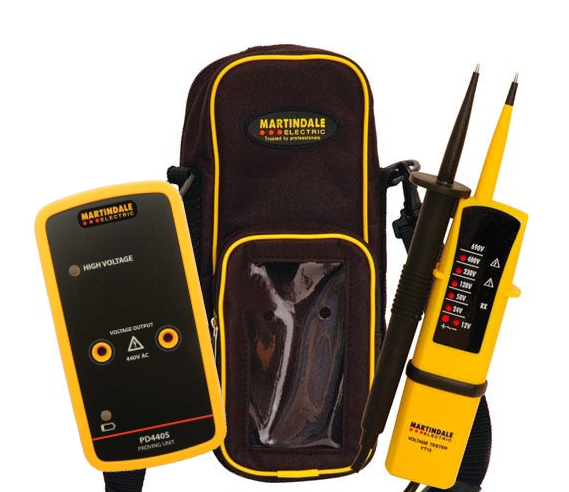

Decided to buy martindale Voltage Tester VT12.
Can anyone point out a 'good enough' decent GS38 proving unit?
Thanks.
I have a 12 volt 12 Ah jump starter lamp and compressor, it was left to me, it has a 13 amp socket 300 VA, so I use that as a proving unit when required, it is not ideal as it does not ramp up the voltages, a proper proving unit should show the tester will work at 50 volt AC or 75 volt DC i.e. any voltage over extra low voltage must work the voltage tester, be it AC or DC or anywhere between the start of the low voltage range and likely maximum, so should step test both AC and DC.
To be frank the issued proving unit I had was 500 volt AC so rather pointless, as the tester may show all lights 12, 50, 100, 250, 500 etc. But you don't know if any would actually show at 50 volt AC or 75 volt DC so the unit is only to satisfy the safety officer it is really worthless.
I have not yet seen a proving unit that uses both AC and DC through a range of voltages. There may be one. The same applies to tester, must not be able to be switched off, even with discharged batteries, or turned to another function, and must be AC and DC.
However few fit the criteria, and I suspect most can use a multi-meter safely, so in real terms we are looking for test kit to satisfy a safety officer, rather than one guaranteed to do the job.

I thought question was about proving unit? Not the tester? However I have found in the past using a proving unit not designed for the tester has caused problems, where the tester has used more power than the proving unit could deliver.
But if a tester can measure open circuit, the big question is can it have the wrong scale selected? Personally I am happy using a multi-meter to test for dead, but am also aware this would not be allowed by some safety officers, only worked in one place where proving units were always used, and it was site pass removed if caught without one at ones side, which in real terms meant the sack.
But the proving unit we had to use only produced 500 volt AC so a bit useless as it did not prove the tester would show over 50 volt AC or 75 volt DC so using my jump starter kit was just as good as the proving unit.

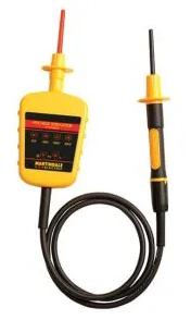

Once you has any other scale selectable other than volts then the tester may be considered not to comply, and it needs to test AC and DC without swapping and range scale switch. This 1703752469114.pnghas been the tester used for years to prove dead, no switches, works AC and DC no batteries. There are LED versions 1703752713973.pngoften sold with the proving unit, that way one is sure it will work.
