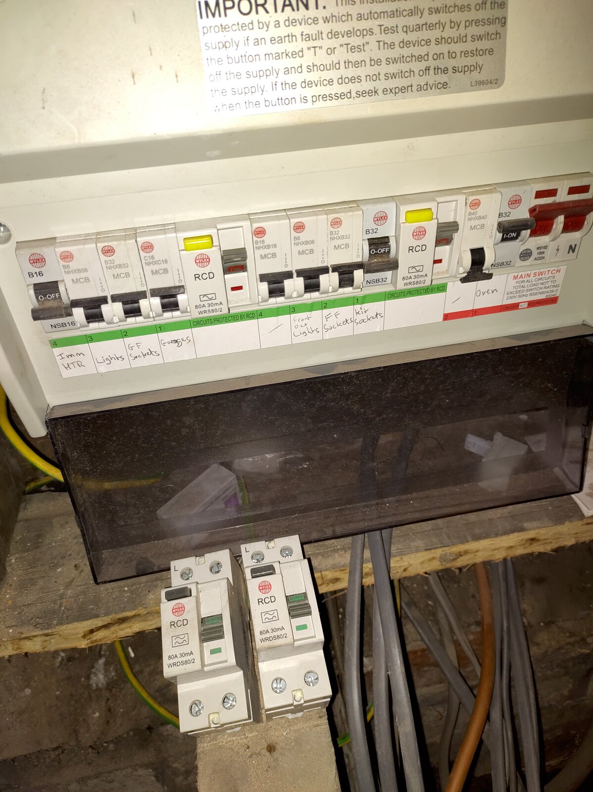

I've already been made aware of the need for new RCD's, but the ones I have are still only 80amp, main fuse is 100amp??
Why? There are two of them which is 160A.
Just seen your picture.
A different type of RCD; not because they are 80A.
Better do it quick before they change the rules again and you need something else.
A consumer unit can go up to 125 amp single phase, but only seen rated at 100 amp, the DNO fuse can be 60, 80 or 100 amp, if total of all MCB's under or equal to size of RCD protecting them it is OK, or the RCD is over or equal to DNO fuse OK.
However since a plastic CU, it would seem prudent to change it and go to all RCBO with SPD so really it does not matter.
