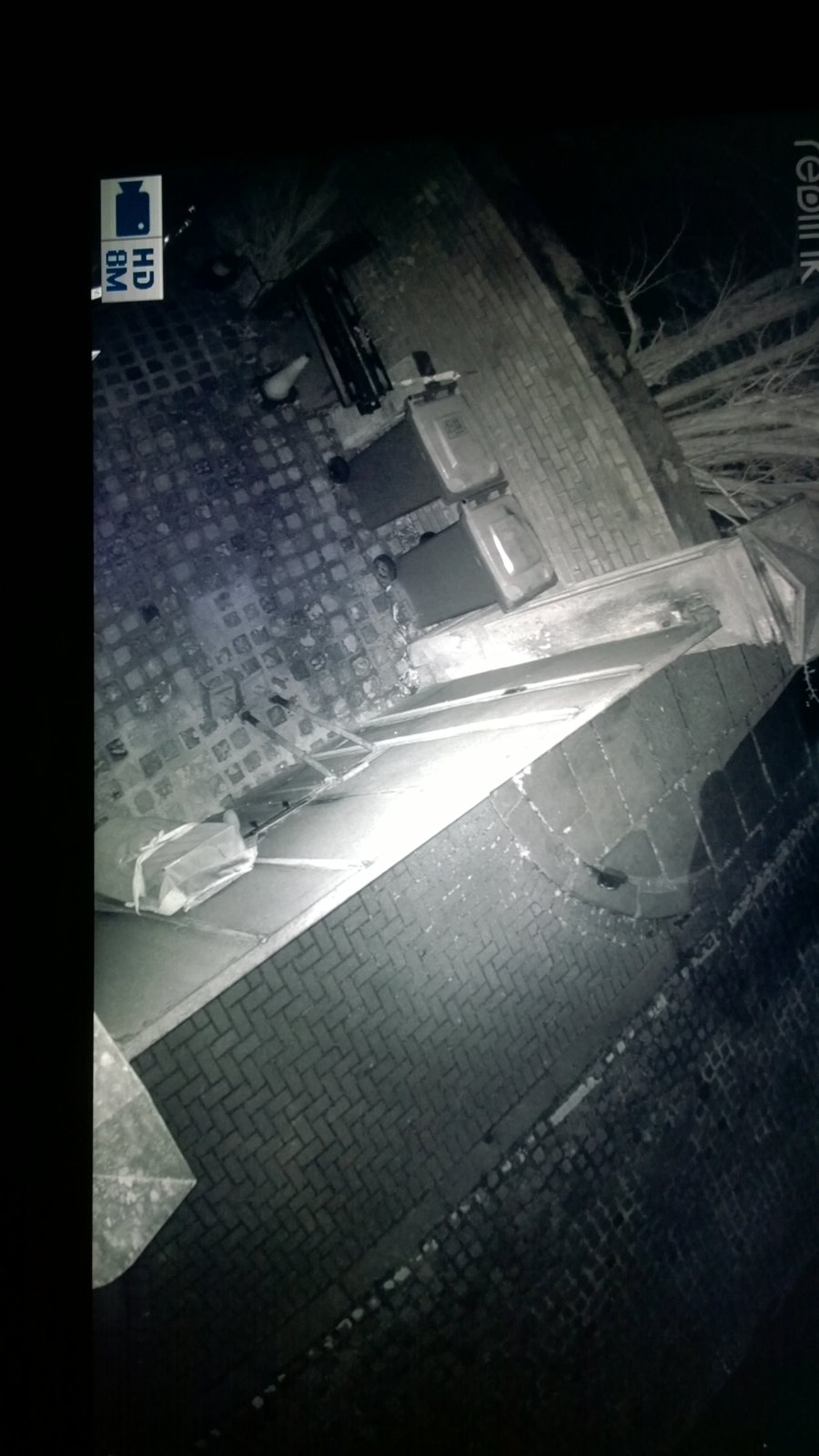

I have just received the Four 4K and 2TB NVR direct from Reolink at £420 ish and have got 2 on the go so far and have to say the night view is better than the Panasonics. Having said that its amazing how cameras have both improved and cone down in price.
Obviously the 4K items I have do not compare to th 4K ones from Panasonic but they a one tenth of the price.
I will post up an image later copied from the 4K TV screen.
Camera is about 28 feet above the ground
edit
that should read 18 feet above the ground
