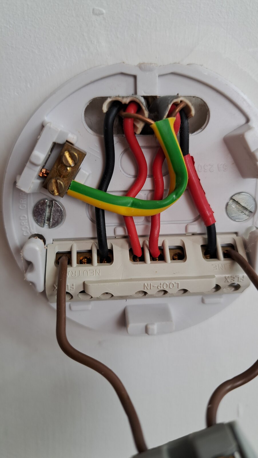

Hello. Another newbie here. Over the past few days I've been on the same learning curve as the OP. I too had to remove a ceiling rose to fit a new flush mounted light fitting. I discovered that there were two cables coming in, IN and SWITCH wired to Line, Loop-in and Neutral. Luckily, I took a photo before removing it (below).
I finally found a couple of diagrams that made sense and worked out how to wire it. I've done it in exactly the same way shown in the bottom photo, using block connectors, except the earths are connected to the fitting.
For some reason, as soon as I restored power the light came on, even though the switch was off. Turning the switch to the ON position, the light stayed on. What have I done wrong, please?

You have either connected a permanent live to the lamp or the switch is knackered.
At any time did you blow a fuse or trip a circuit breaker ?
Have you done any work at the switch ?
Yes, I've tripped a circuit breaker. I originally wired the two lives and the two neutrals to the lamp. I made the mistake of asking someone else if that was right but it turns out he didn't really know either. I haven't touched the switch
Thanks. I'll take a look tomorrow. Is it a fuse I'll need or a replacement switch? I assume that's why it's permanently on.
A new switch, assuming the wiring at the new lamp is correct and neither of the two red wires are connected to it !!
Thanks to everyone who responded to my query. I just replaced the light switch and now everything works perfectly!
